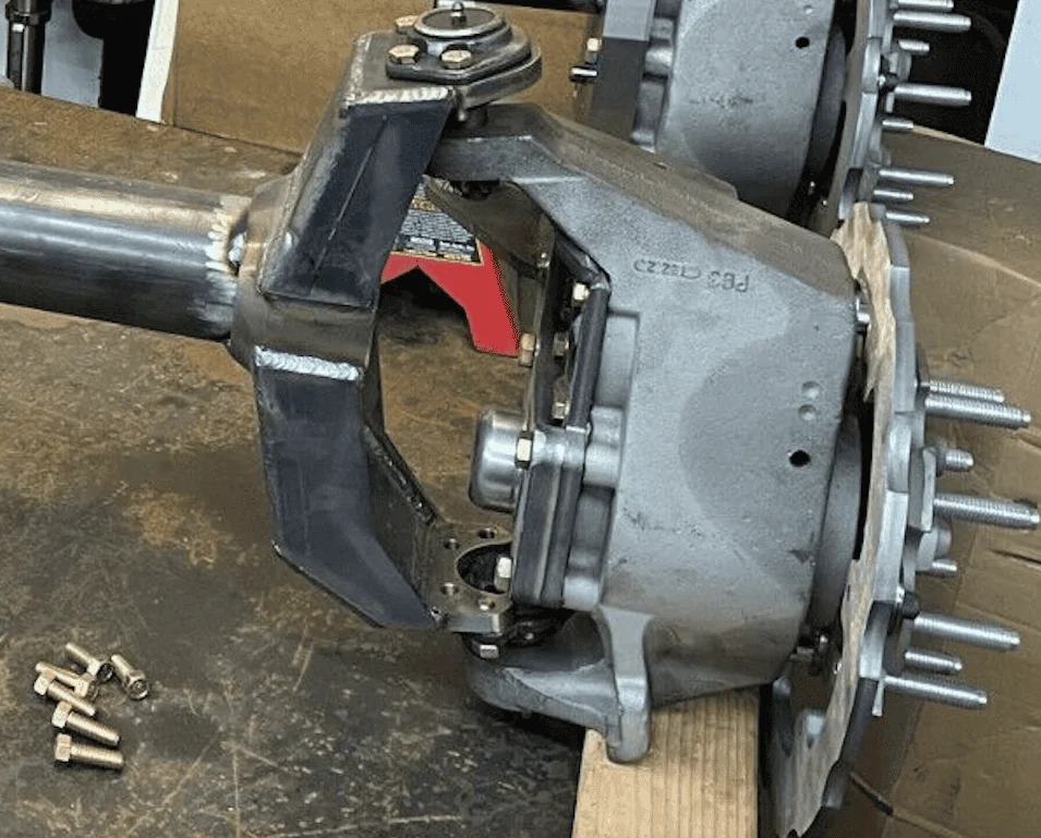

Ah yes portal axles. Seems like everyone who finds out they exist gets initially excited about the idea until they discover the price. I know I did.
Ground and tire clearance without a body lift? What's not to love? Oh, wait they cost half as much as my truck uninstalled? Yea... I'll stick with the aev puck lift I have planned for one day.
Yeap... Price and then they also forget portals aren't so hot as a daily driver set up. They are cool for dirt work but they aren't something i would want to be crusin down the high way at 75 on.
Way to much additional wear and tear for that kinda of work, their is a reason they are only used on military rigs.

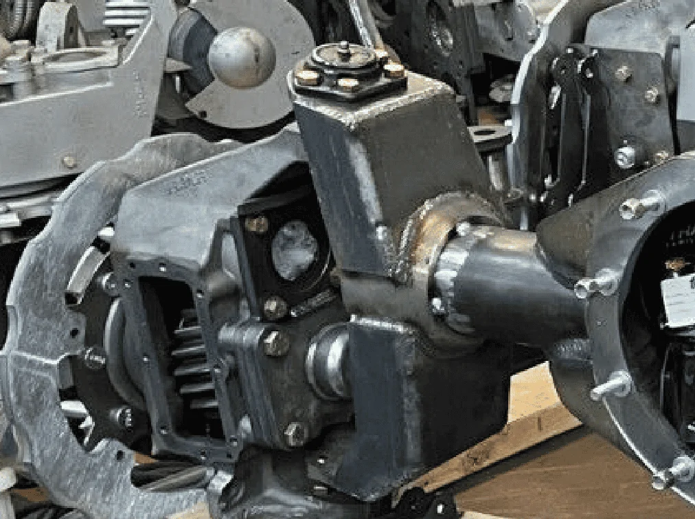

3.73 axle plus these particular portals is the equivalent of 4.56s (am I the only one that watched the video?). Plenty of people doing that daily on 37+ tires
No one's yet mentioned the additional drag of 4 extra gear reduction stages, but it's significant. Looking forward to someone showing up here saying "what's wrong with my 9mpg Jeep on portals"

Portals are pretty cool, but that screams "maintenance nightmare" to me. Wonder how much more noise and parasitic drag is introduced by all of those extra gears? Leverage on an already sketchy front axle housing/ball joints?

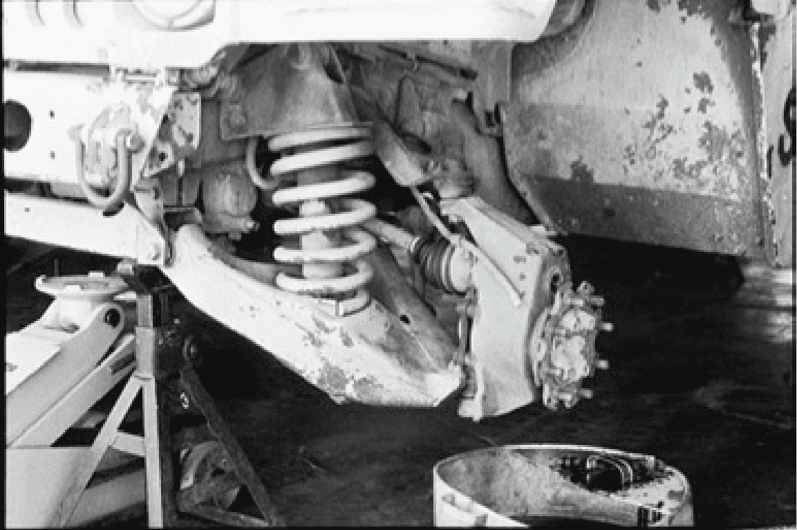

The HUMVEE / Hummer H1 also have portal axles.
They are portal hubs set on an independent suspension. I broke several of them along with the sub-frame on deployments. The steering is extremely weak. The brakes are awesome, but set on the outer edges of the differential and not on the hubs where the tires mount.
What was the justification for the inboard brakes? They were outlawed in most motor racing because of how they stress the axles. The justification then was that it allowed larger brakes than could fit inside the wheel.
Was that the rationale for the Humvee??
