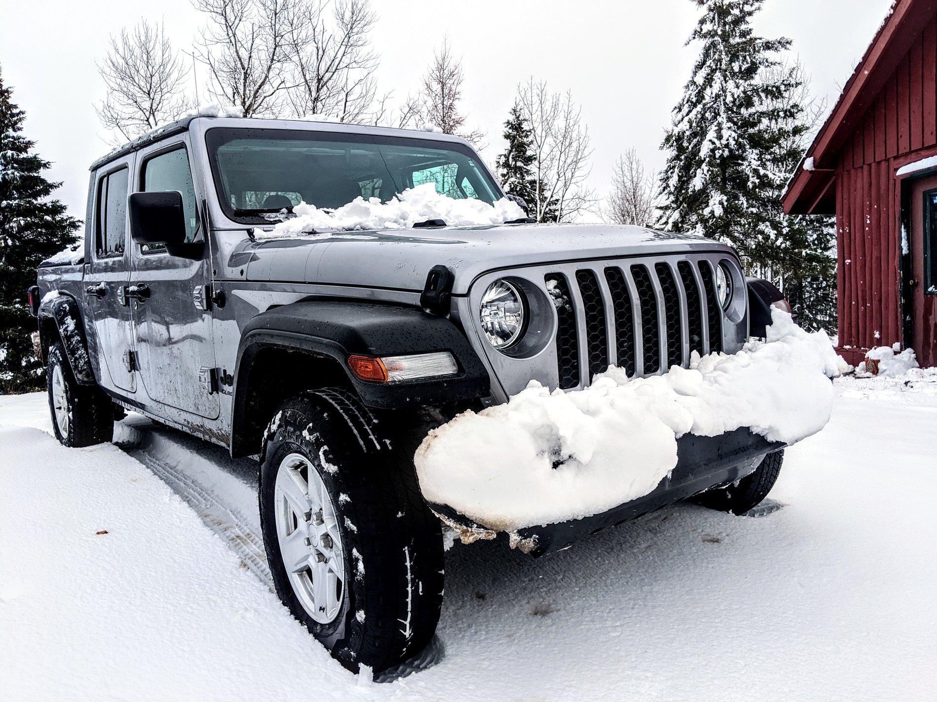

Hold down the TC button. Pressing it only partial turn off
Thanks :like: fun level has increased. Still really impressed with the truck even the stock tires seem to grip well. The driving aids seem predictable and not to intrusive but keeps the truck secure. I have trouble when getting into a spot that I should be able power out but the TC cuts the power and the stalls out. Turning of the TC fixed this but still think the truck should be able to send power to the wheels vs stalling. (Manual). I am generally running 2nd and for the most part I get around and in a few spots it gets deeper and require more power and the truck should be able to handle it but with the TC countering my throttle petal. I either end up running 1st gear or turning off the TC or both. Most situations I don't want to down shit as I don't want to stop momentum and by the time I realize action needs to happen it's to late. Turning of the TC takes a couple seconds. Also noticed by switching from 4h to 2h the driving aids come back on. I didn't check if the driving aids hold or reset going from 2h to 4h. Overall it's a learning experience that I'll have to adjust my driving habit's to compensate. Bottom line truck handles great.
