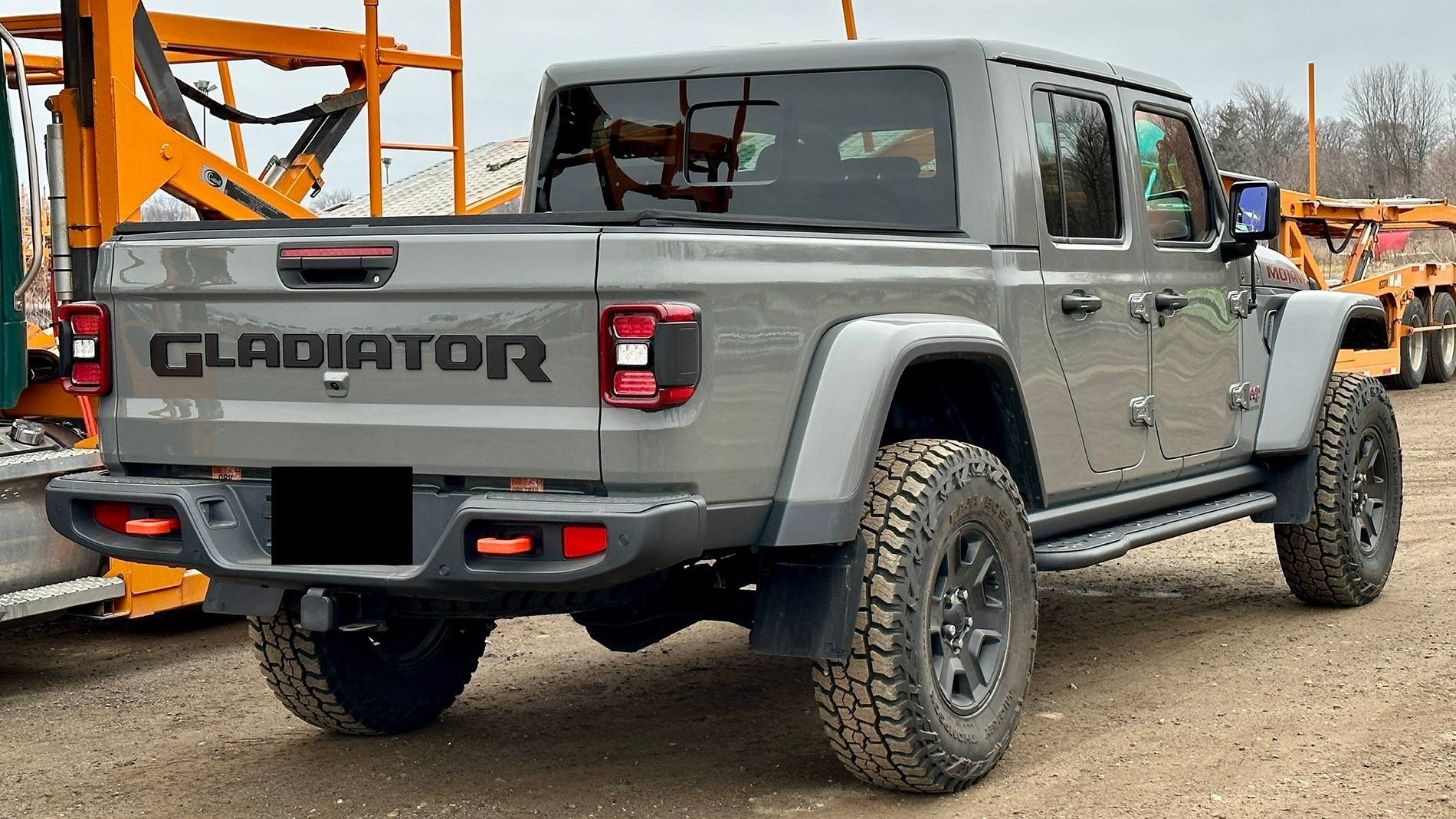

Lifelong southeast Michigan here. Self-ordered 2022 Mojave (w/Selec-Trac). First jeep. Of all the bought new 4x4s I have owned since being a teenager (10), I am 52… this vehicle on Mickey Thompson Baja Boss A/T 255/85R17 is hands down, by far the absolutely best winter driving vehicle on setup I have ever owned/driven.
It is an absolute blast to drive in the winter, in the far left lane, often breaking trail, doing at least the speed limit, wherever I am going.
Hanging full size matching spare tire/wheel and another unmounted same tire thrown in the back. Nothing else.
Of those 10 new vehicles, ‘91 K5 Jimmy/Blazer, ‘04 Avalanche Z71 & ‘19 4Runner TRD Pro… the rest were pickups. I’m just saying… generally speaking… a lot of trial and error with different vehicles and tire setup.
As long as said tires [size] are available, I will never consider anything wider. I do not require “flotation” of any kind whatsoever.
The only improvement to be made, would be winter specific snow tires, as mentioned and in my opinion.
First video link is what convinced me to stick with my plan to go with “pizza cutters.”
Second video link is another popular one.
