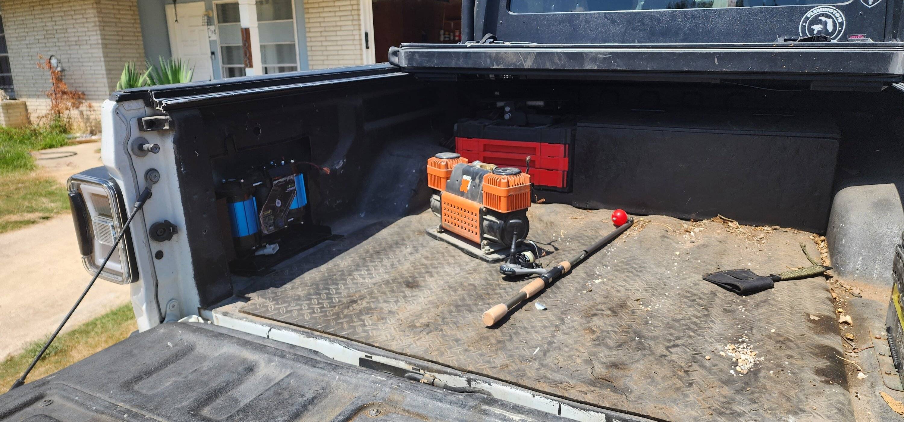

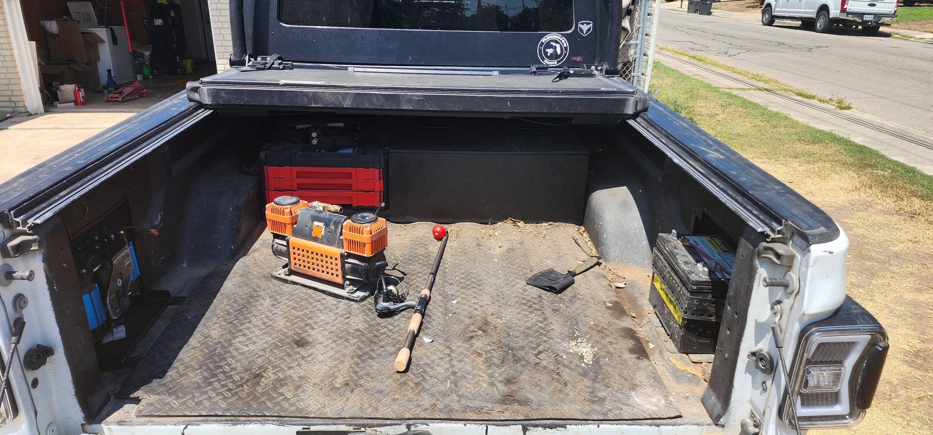

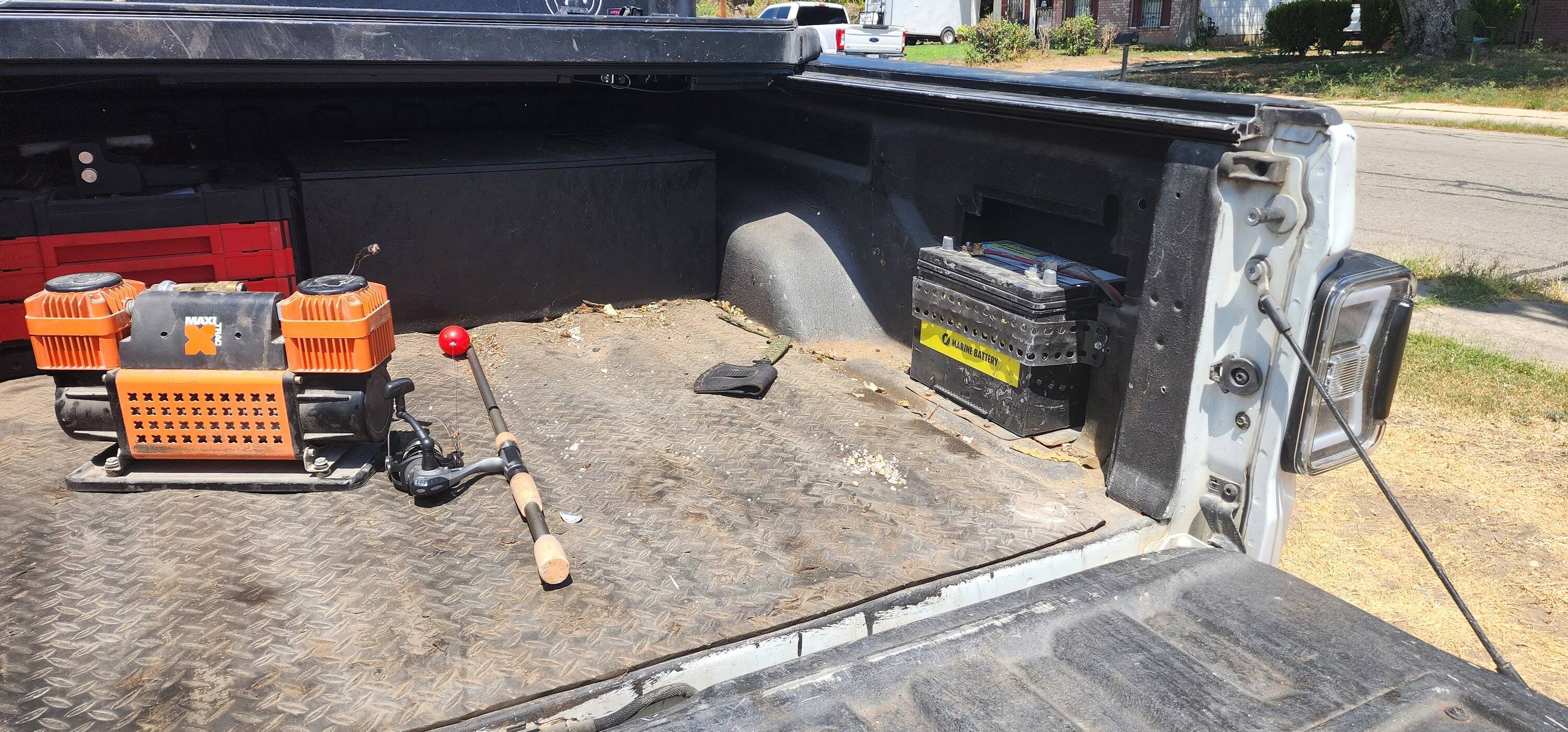

I took the cover off of the battery and compressor so you can see where the battery is mounted in my bed. I have a cover that I made which covers it. On the other side, I also have an air compressor. I am now replacing the maxitrac. Nothing wrong with it, just going with a dual which is a little bit smaller and built in pressure switch.
I wouldn't advise anybody to do what I did. But it works for me and doesn't get in the way of anything I'm loading in the bed. I do plan on getting a redarc in the future like @ShadowsPapa mentioned for both of the batteries.
Yea. I will do things that are borderline crazy. And cutting into the JT is no exception!???

Dear god this is horrible! If this were my JKU, I def would’ve been chasing an electrical gremlin.
I’m so glad I don’t have a sawzall! ? Diving in head and feet first…love it!!
But in all seriousness, I’ve heard of ppl putting a battery in space up in the wheel well. Is this that same space?
