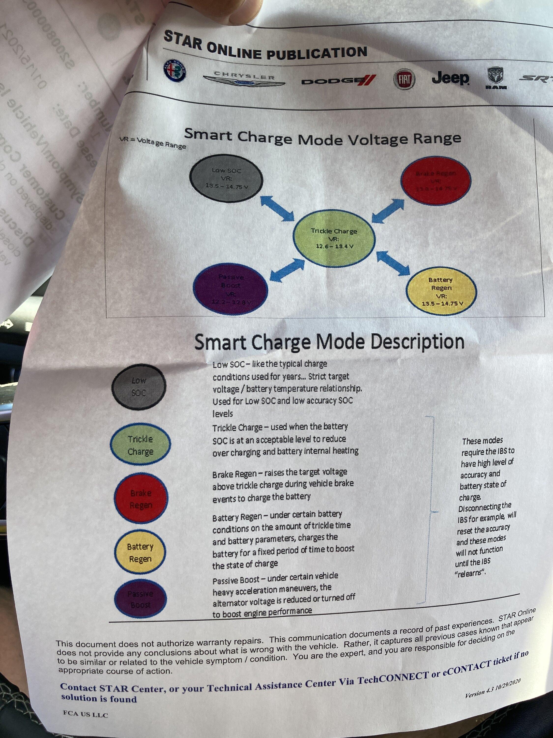

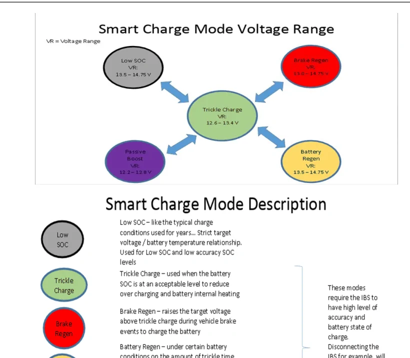

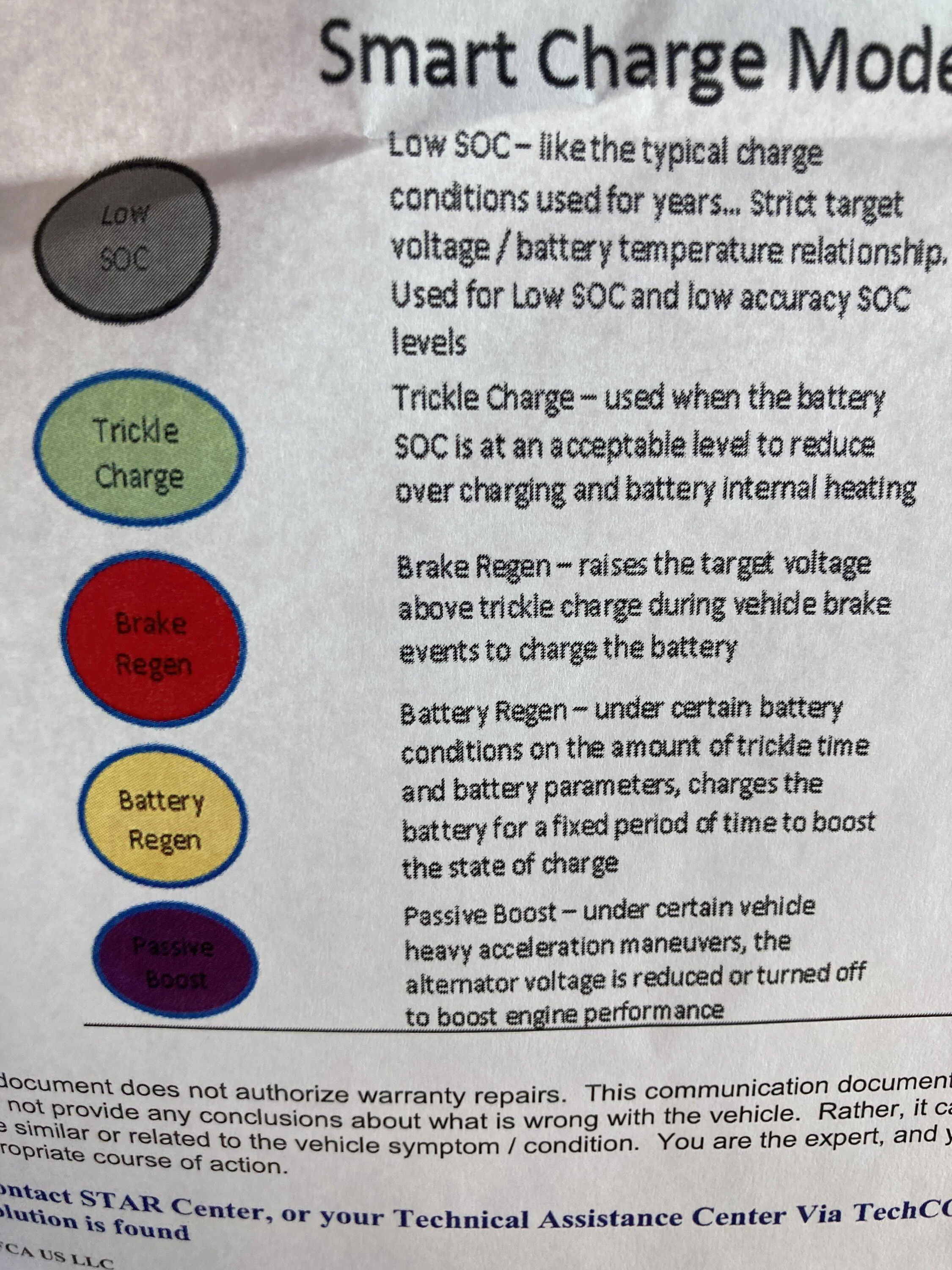

FWIW
I had my JT evaluated at the dealer today thinking maybe my alternator was bad. Every this is fine and they printed out the bulletin regarding battery voltage I found interesting.

Yeah, got that one after seeing my 2020 drop down to 12.6 while driving - that's why I suggest that if things are otherwise ok, don't sweat low voltage while driving.

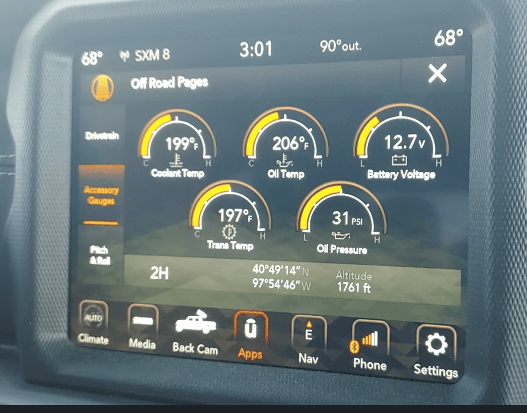

I saw 12.6 or so on the way back from CO last summer.
My 2022 starts out at around 14 if it's been sitting a day, then settles down to 13 to upper 12s after driving a while. This one is working exactly as designed and the batteries are staying up.
I caught it at 12.7 for this pic on the way back from CO. We were doing about 80 mph on the interstate -> (someone can figure exactly where we were by these coordinates LOL)
