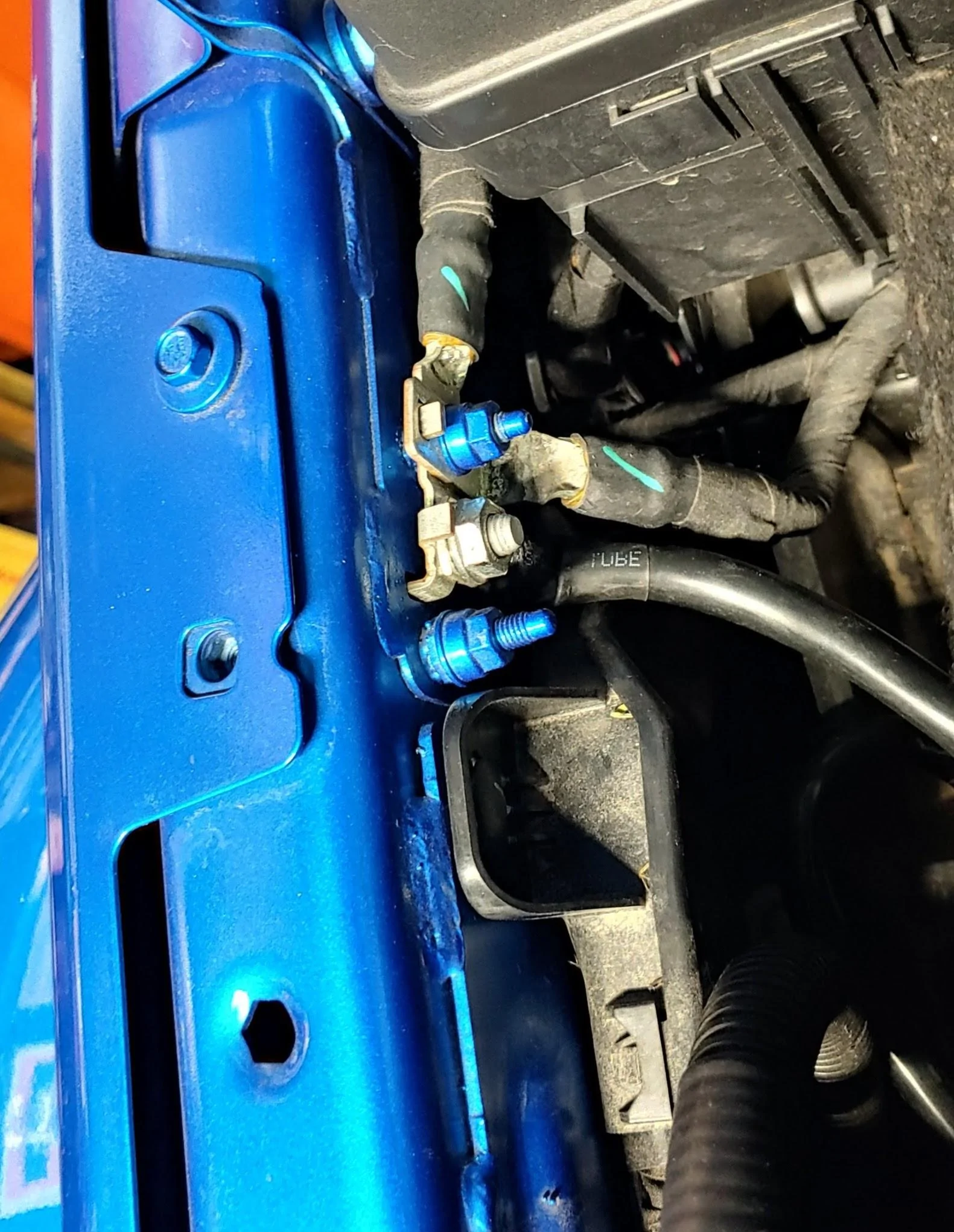

Not happy after I got my truck back today - they said batteries checked out fine but the notes said "did require charging for 38 minutes.........." Well, if all is functioning well, I drove the truck there, they drove the truck, it's not been sitting for a week, why did they have to charge the batteries before they could check them?
Then they said that "all the stuff you have connected to it likely is drawing the batteries down". All the stuff is factory - They said they "moved it to the other side and that should help"
What they moved was the winch ground cable, and where they moved it to was the body ground. That makes no difference since the body ground cable goes directly to the battery neg. So they did nothing. Besides, the winch pulls zero power when not in use, especially since there's a cutoff switch right next to the battery.
I had the winch ground connected to the battery on the SAME bolt the body ground cable connects to. They moved my cable from one end of the factory ground cable to the other.
So this time, they blew it. Said truck is fine, any issues likely related to "all the stuff" I have connected - which consists of a winch with a disconnect.
I don't know the size of that factory ground cable, but I would move that winch cable back to the battery terminal.
Yes, agreed! That thought had already had crossed my mind.
Looks like you obviously understand just what they did.
There is a cable from the negative battery connector clamp, above the IBS, that goes directly to the right fender for body ground. I was originally connected to the battery negative on the SAME stud that negative body ground cable uses - the exact same stud. I put my cable on top of the factory nut and then a nut on top of my cable, squeezing it against the factory nut that holds the body ground cable to the battery clamp. That's a tall stud, plenty of room for multiple cables and nuts.
They removed my winch ground cable from that stud and connected it to the other end of the body ground cable.
So electrically speaking, all they did was add the length of the factory body ground cable to the length of my winch ground cable - increasing the number of connection points by 2 and increasing the length of the ground cable by at least 18".
So even though it could be minimal, without measuring, they added more voltage drop and 2 more connections.
But, and this is the funny part they didn't understand - they didn't electrically change anything other than adding length and connections. It's the same as if they simply bolted on 18" of cable to the end of mine and reconnected it. What silliness.
This is where it was - on the tall stud, I left that nut in place, put the cable on, then another nut ->

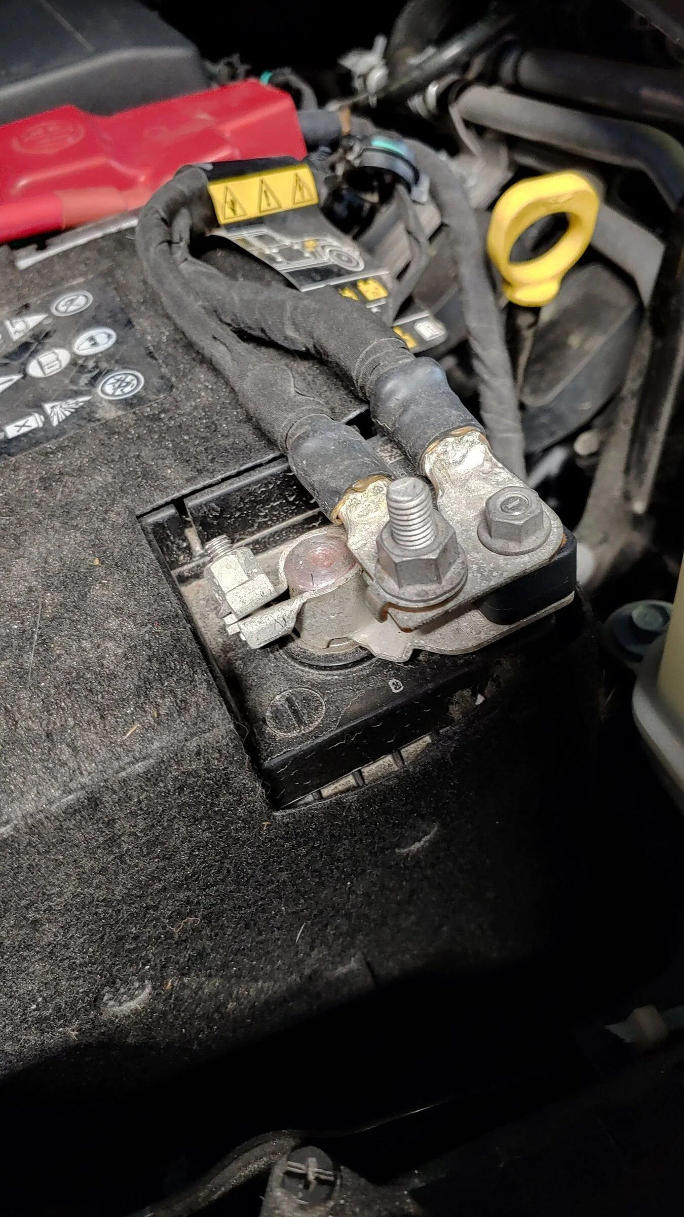

Jeep Gladiator Your battery voltage - truck off and at rest JT-neg-bat-post
This is where they moved it to - it's the fat black cable right next to the cable coming from the battery negative post. ->
Jeep Gladiator Your battery voltage - truck off and at rest JT-body ground
Wait a second. You are running your winch through the IBS? Is the IBS capable of handling the max amp draw of your winch? Sorry if this has been discussed before, but I did a quick search and didn't find anything.
I could just as easily bolt to the battery terminal clamp bolt.........
The IBS is a low resistance shunt and the very slight voltage drop across the IBS shunt is measured along with actual battery voltage.
(It's the same as used in ammeters of cars dating back a few decades (not the full current ammeters like in the early 70s and older))
Here's what I have on the IBS -
Given that an IBS does use a resistive shunt at its core for current measurements, there is a loss associated with it being in-circuit. However, by incorporating shunts with extremely low resistance values, this loss can be negligible over most of the current range. For example, a 100 µΩ shunt only causes a loss of 1 W at 100 A of current. That is a 0.083 percent power loss if you have 100 A being sourced by a 12 V battery.
On the real-world test, the 35-inch, 4- AWG positive battery cable has a resistance of 788 µΩ. This means there is nearly eight times more power loss in just the positive battery cable than there is in the IBS. The use of such a low-value shunt should permit the IBS unit to operate at a current range of ± 600 A continuously and ± 2,000 A in pulsed applications not exceeding 900 J.
And this is what I have from another forum describing how they work -
The IBS may be the most robust sensor on the car, as its sensitive element is essentially a bar of copper capable of carrying 1,000 Amps of current. It has a tiny laser cut in it that causes the minuscule voltage drop that is used to measure current flow based on the voltage drop.
