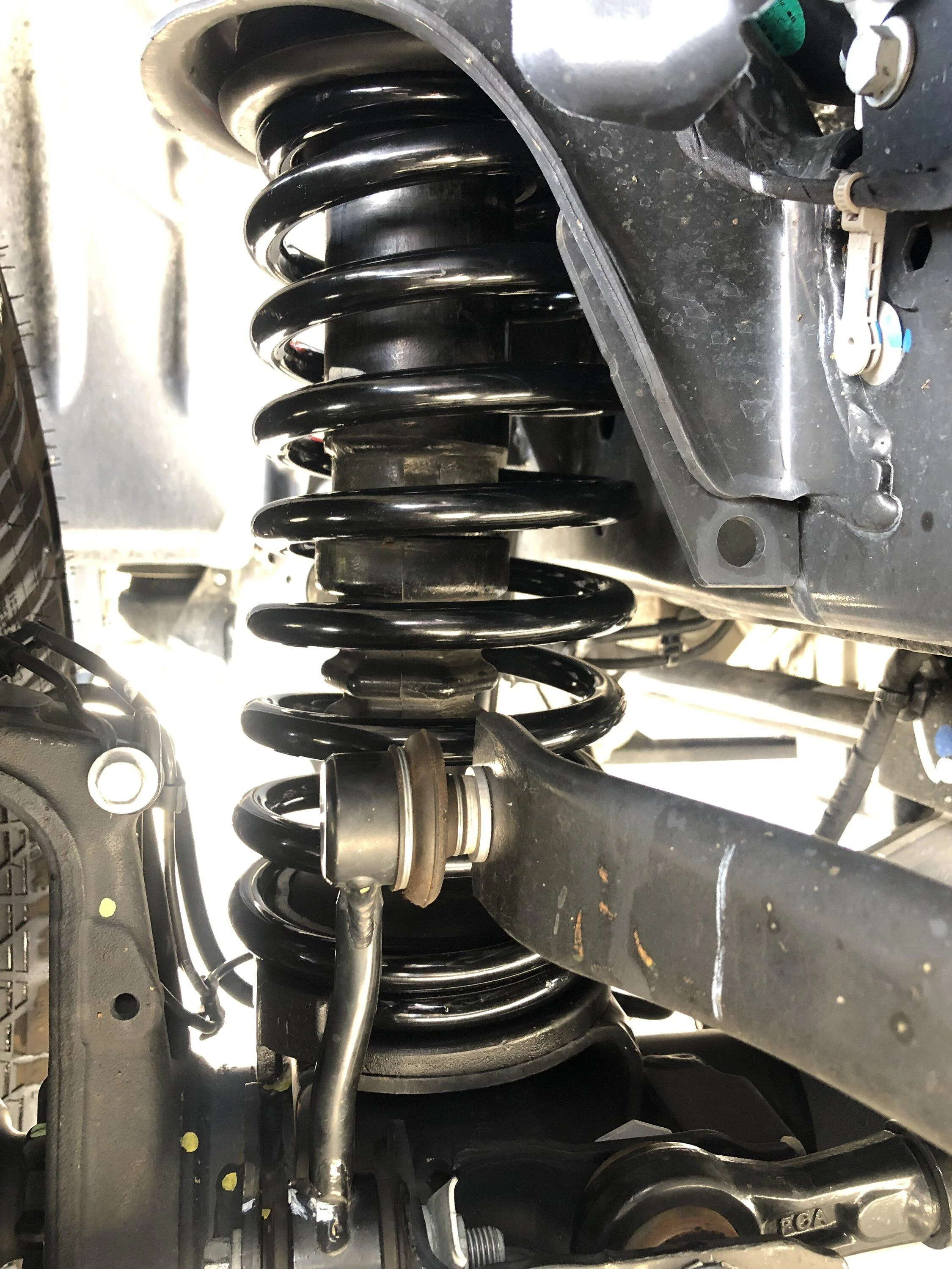

Today I installed the Clayton diesel front springs along with the metalcloak coil pads and daystar 3/4 in spacers front and rear. Already had the metalcloak bump stops installed as well. The ride has significantly improved and no longer bottoms out. The Clayton springs are well worth it if you cant get the fix at the dealer.
Jeep Gladiator Your stock Rubicon diesel JT bottoming out? Here’s the fix!! IMG_8637

...and I did the Clayton springs at the same time. Those 2 are the only suspension items that have been done on mine and it has fixed it 100%. ZERO bottoming out in the last 4 months, including 1 offroad trip.

For me, the Clayton .5 inch diesel springs and a daystar 3/4-inch spacer along with Metalclock front bump stops were enough to fix the issue. I am completely satisfied with the ride now.
