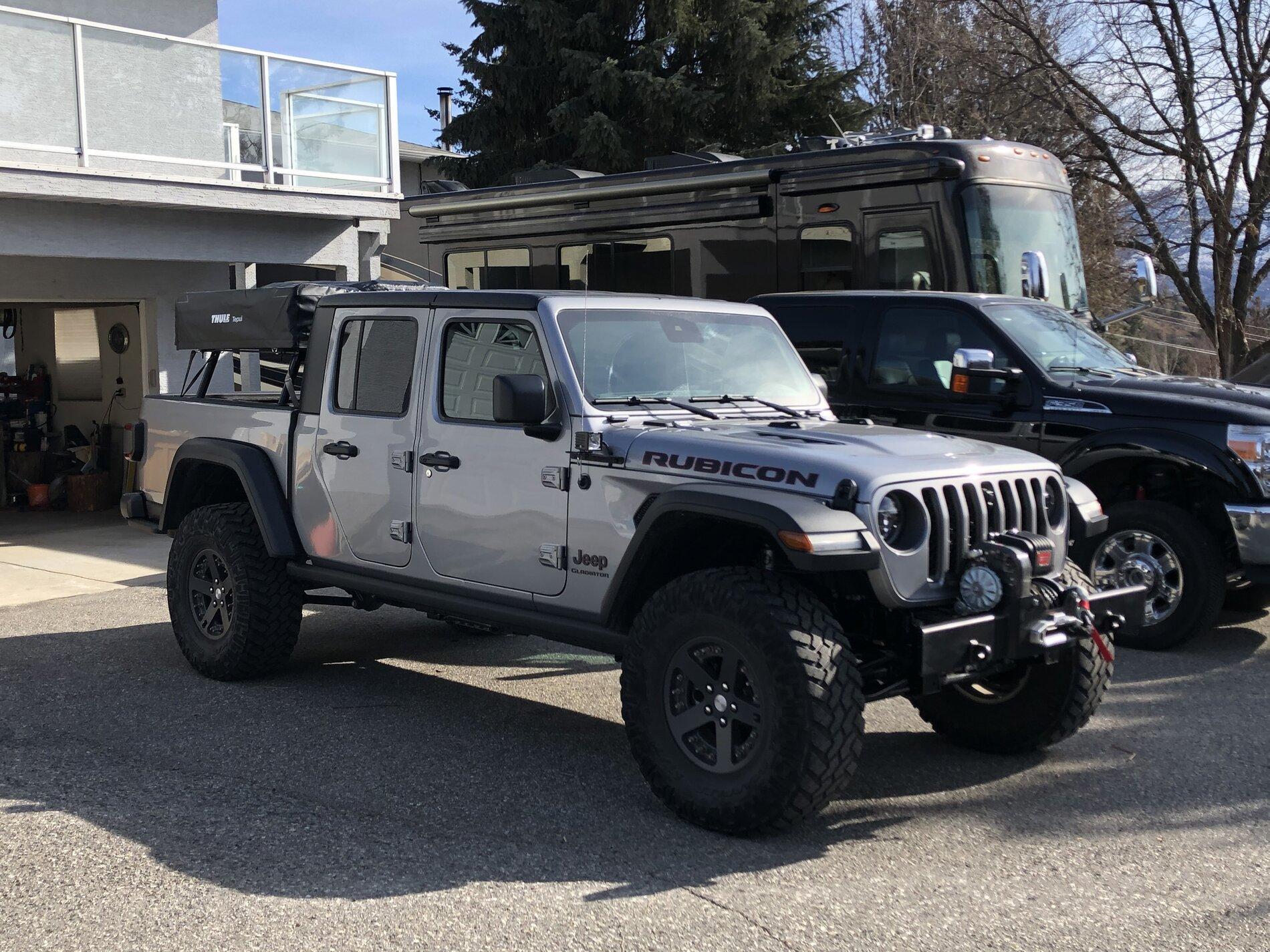

If youd like your vehicle to drive like stock for a longer amount of time . Get the mopar 2” . Bushings outlast most any aftermarket product no matter what they claim . Stay away from 20” tires . Even at lower pressures they ride rougher, and you will be more susceptible to pinch damage . More of a mall crawler thing. You get a far better contact patch with air down and sort of better articulation due to the fact the tires allow more compression . For 37s Youd need a 3.5 lift with anything but a rubicon . A rubicon with a 2” is plenty clearance.

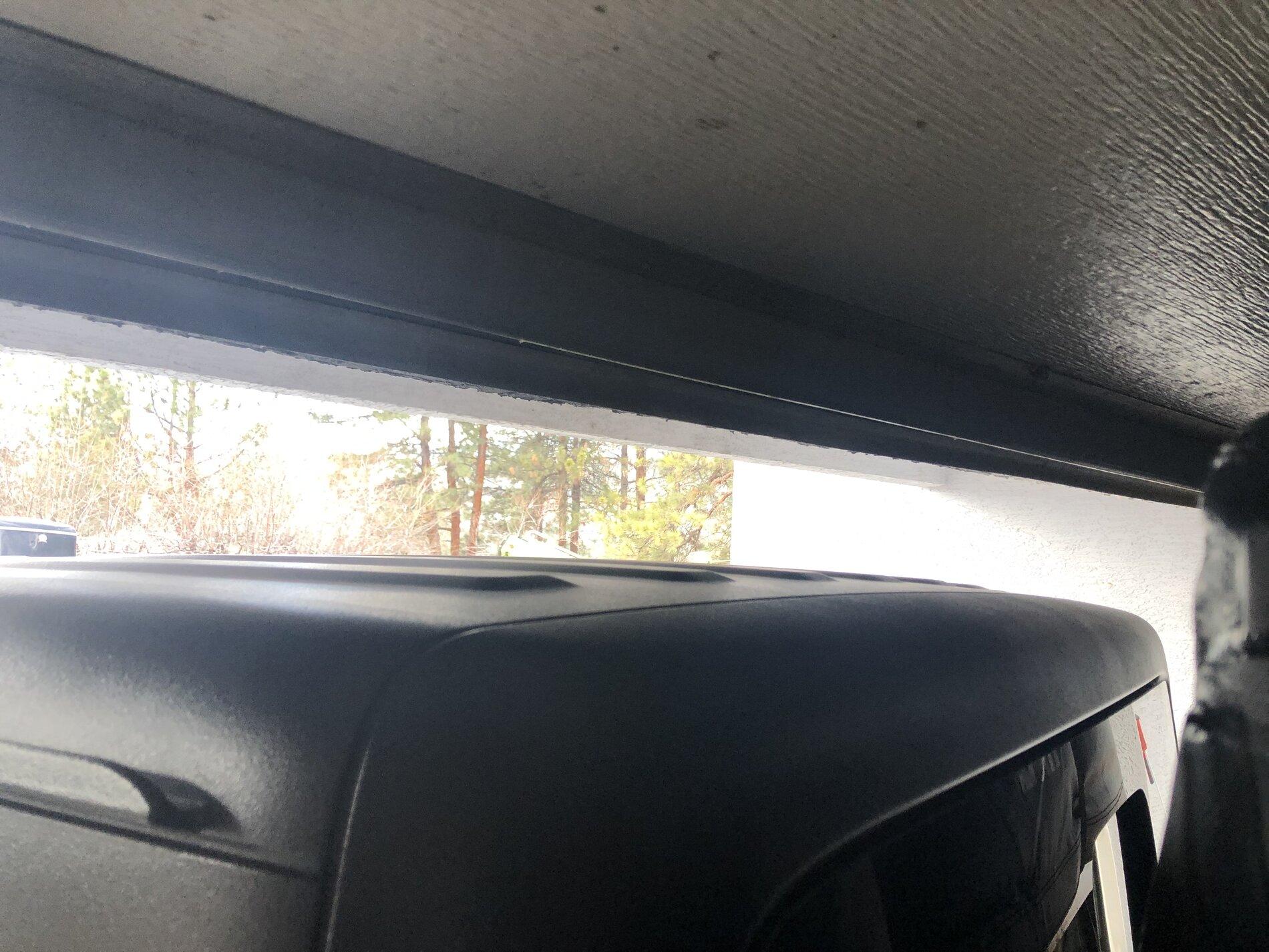

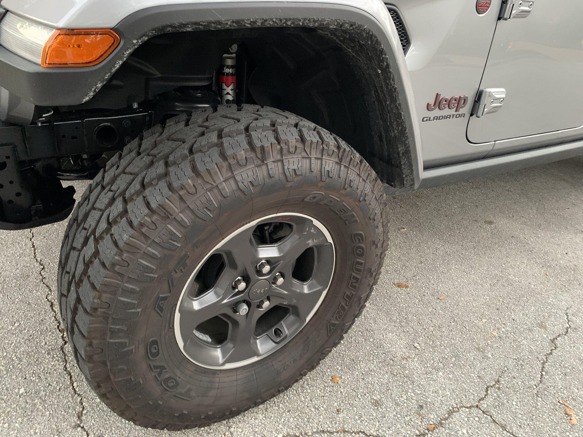

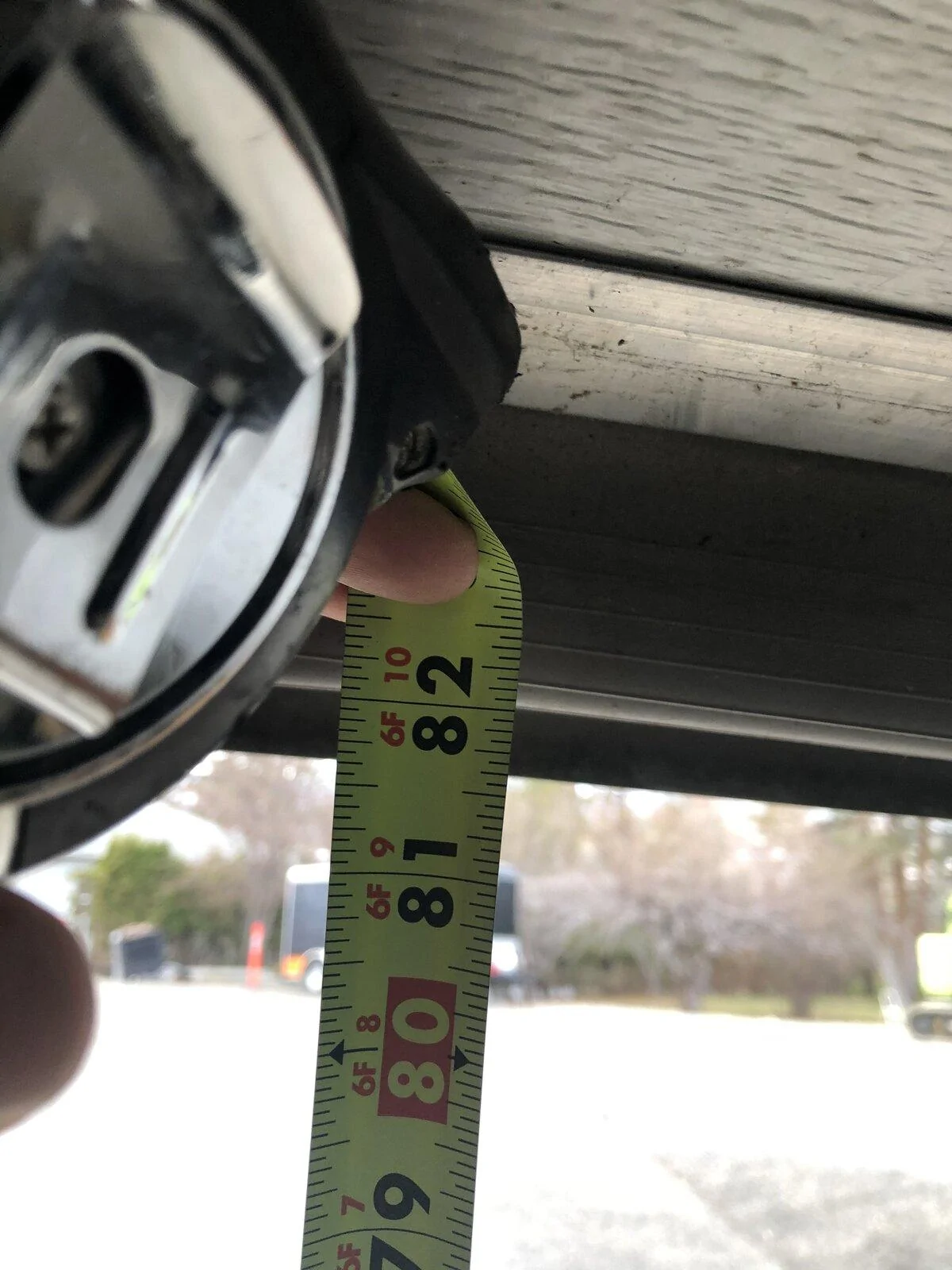

1. you will fit in your garage with an 82" opening with either size lift and 37" tires. The Mopar lift is OK to start out on but leaves a few things to be desired, but at the moment it is one of the only lifts right now offered for the diesel. What 3.5 lift are you looking at?
2. This is going to be a preference thing, some will say its a must with 37's but with the diesel you have more torque compared to the gasser, plus you are on flat land as you stated, so I say you can wait and see if you feel the need to regear at a later time. You may decide that you need to regear.
3. If 20's are your thing, then rock it.... I prefer the look of 17s so the cost of it being cheaper to run 17's is a bonus for me. I also believe the 17's will have more tire selections, but I haven't shopped for 20" tires so I cant say for certain.
Another benefit to going with 17's is you get a better ride because of the larger sidewall. Also look at the load range when shopping for tires as most overlook that and then come here and complain of a harsh ride when they have a tire that is E rated.

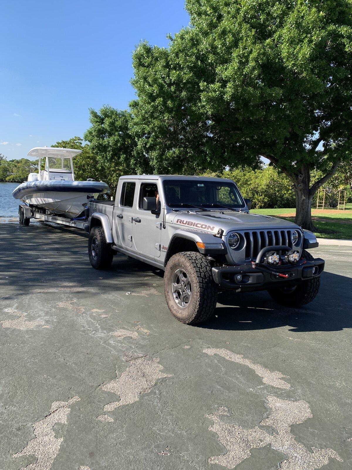

There is a diesel Rubicon with a 1.5 inch leveling kit and 35 Toys which is a true 35. Remember the diesel weighs 400lbs more and there is a winch, bull bar, and off road lights.
35 and 37's are different animals, I have made the same mistake doing what looks cool vs what is more economical and friendly to get in and out of, less maintenance, and the list goes on.
dont do gas over diesel because of city driving and re-gen. I sold my Launch gasser to a friend and they drove my diesel and sold their gas to their son to get a diesel. Diesels are no maintenance and dont have to re-gear if you go bigger tires. If you do gas you better get 4.10's and remember you will have one of many many gassers when you sell.
you want top shelf it sounds like so buy a Jeep that can be financed and full warranty. the only company in history to ever take a Jeep off the assembly line and modify it and then offer it for sale on dealer Jeep franchise lot with full warranty and financing, thats what we call a Jeep with a pedigree with the best re-sale also. this is where the big boys play:

The brakes are quite good and decent size . Nobody can choose wheels but you. I find 90% of them to be cheesy and plain old fugly . Leveling is something to carefully consider . Nothing sillier looking that a truck with hardly anything in it and squatting at the back. Rake looks sporty .
The mopar 2” lift actually feels much stiffer than what my stock 2020 felt like a Cadillac.
The diesel lift kit is stiffer to hold up the extra weight. Feels agile and fun to drive. And added benefit that doesnt get mentioned is after market stuff starts to squeak like hell unlike the stock . The last go round we with aftermarket long arm full meal deal lift had to re bush twice in the time that one of the jeeps which was stock bushings was still tight and drove like new. . AND we all ramped out the same .
