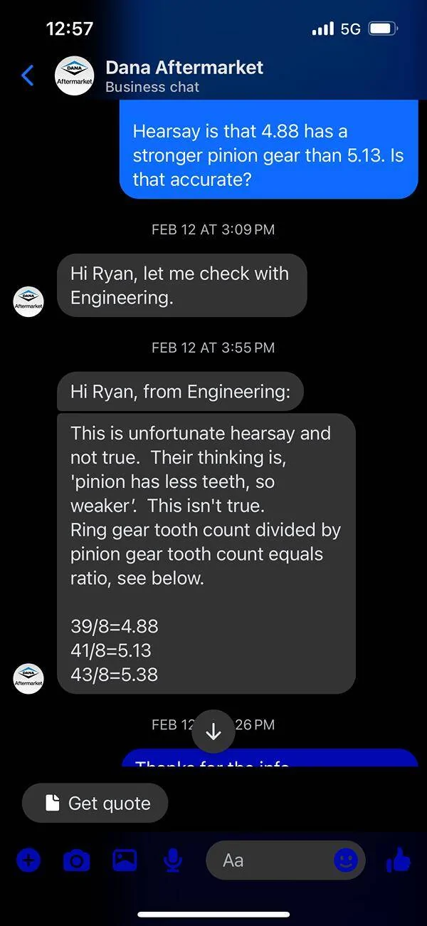

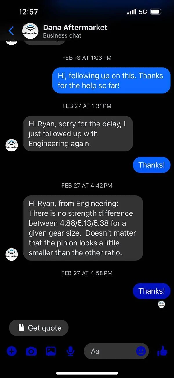

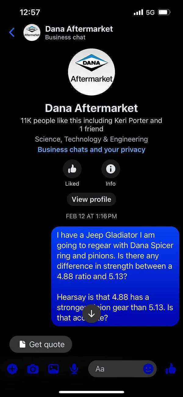

On a Dana 44, some believe the pinion gear is too small for long term durability in ratios above 4.88.
Interesting to hear you say that. I was told I was worried about nothing on this forum when I said I was worried about pinion input speed as the justification for why I went with 4.56 gears as opposed to 4.88s or 5.13s

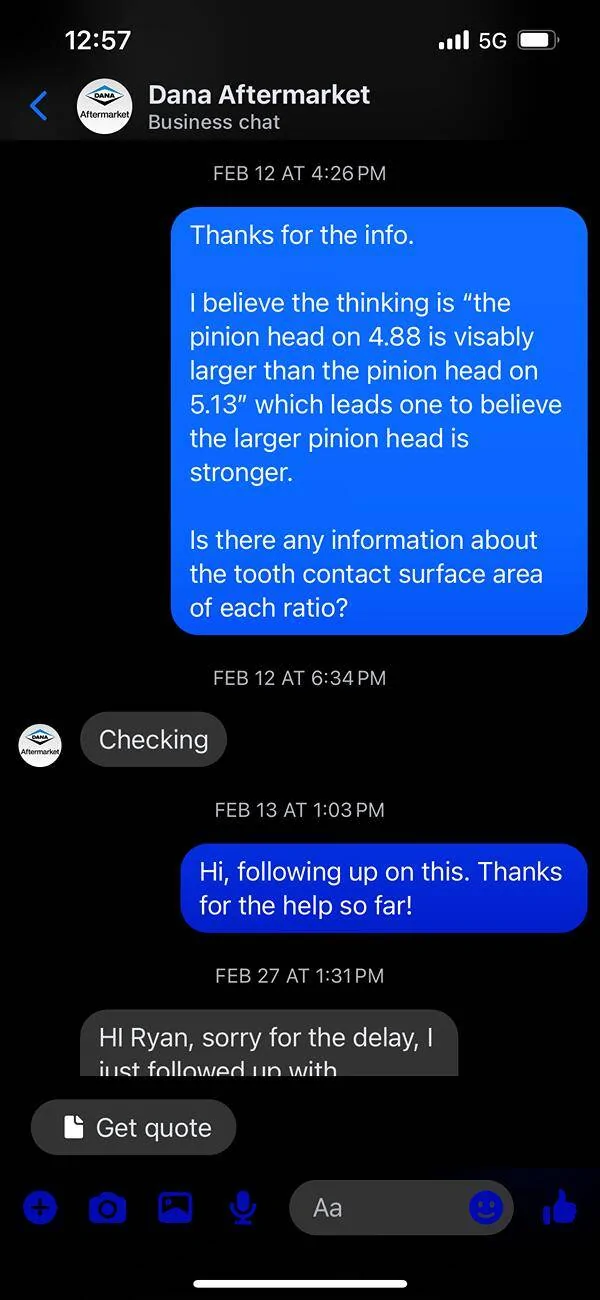

I don't think there is enough strength difference between 4.88 and 5.13 to warrant choosing one or the other for that reason.
The biggest factor in gear set strength is the tooth contact surface area. I think when people conclude that 4.88 is stronger than 5.13, they are just looking at the pinion head and thinking "yup, it's bigger".
I reached out to Dana about this. I'll post when I get their response.
Did you ever get a response from Dana?

I’m happy to hear that response from Dana. I’ve had my Spicer 5.38’s for over 20k miles and they’ve been fantastic on and off road. I wouldn’t say that I’m overly hard on them, but I’m not super easy either. The truck is super peppy with my 37’s driven as a daily.

Facts!!! On the forum. Thx
