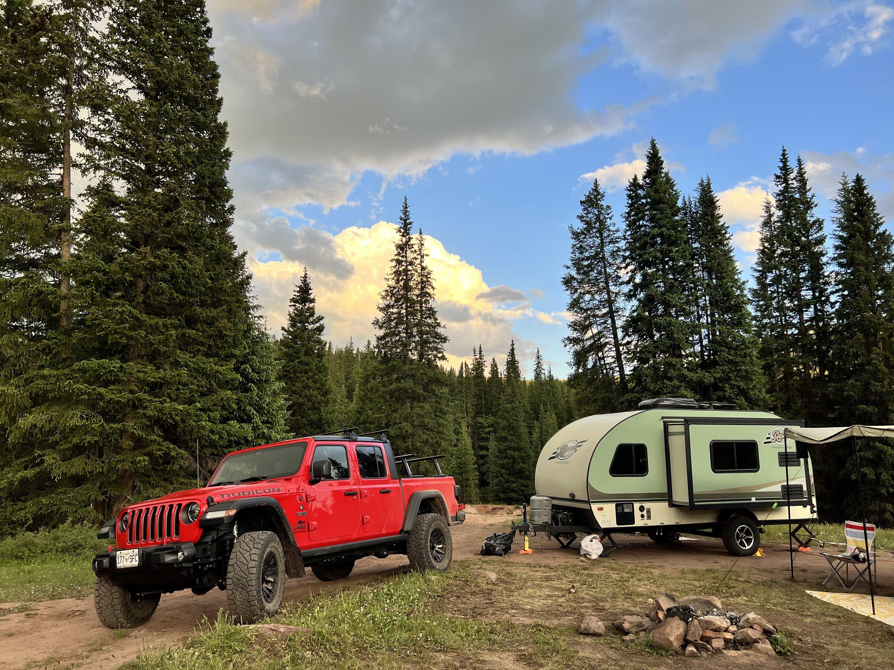

I know folks have had issues with their 3.0 but my experience has been good so far.
90% of the 19k miles has been towing my 3500lb travel trailer in the mountains of Colorado.
I drag my trailer all over the place and use starlink to work remotely.
The only issues I have had are derates and high temps if pushing the motor up hills in the heat. I’ve learned just slow down a bit and let the motor work and it will get you there.
The other thing I hate is how bad the turbo lag is from a stop. It’s bad enough to where it will cause safety issues if trying to cross a 4 lane road with limited visibility.
I do have a Mopar 2ā€ lift and 35ā€ tires on this gladiator rubicon ecodiesel.
Would you do the GDE tune or regear to speed up your acceleration from a stop?
