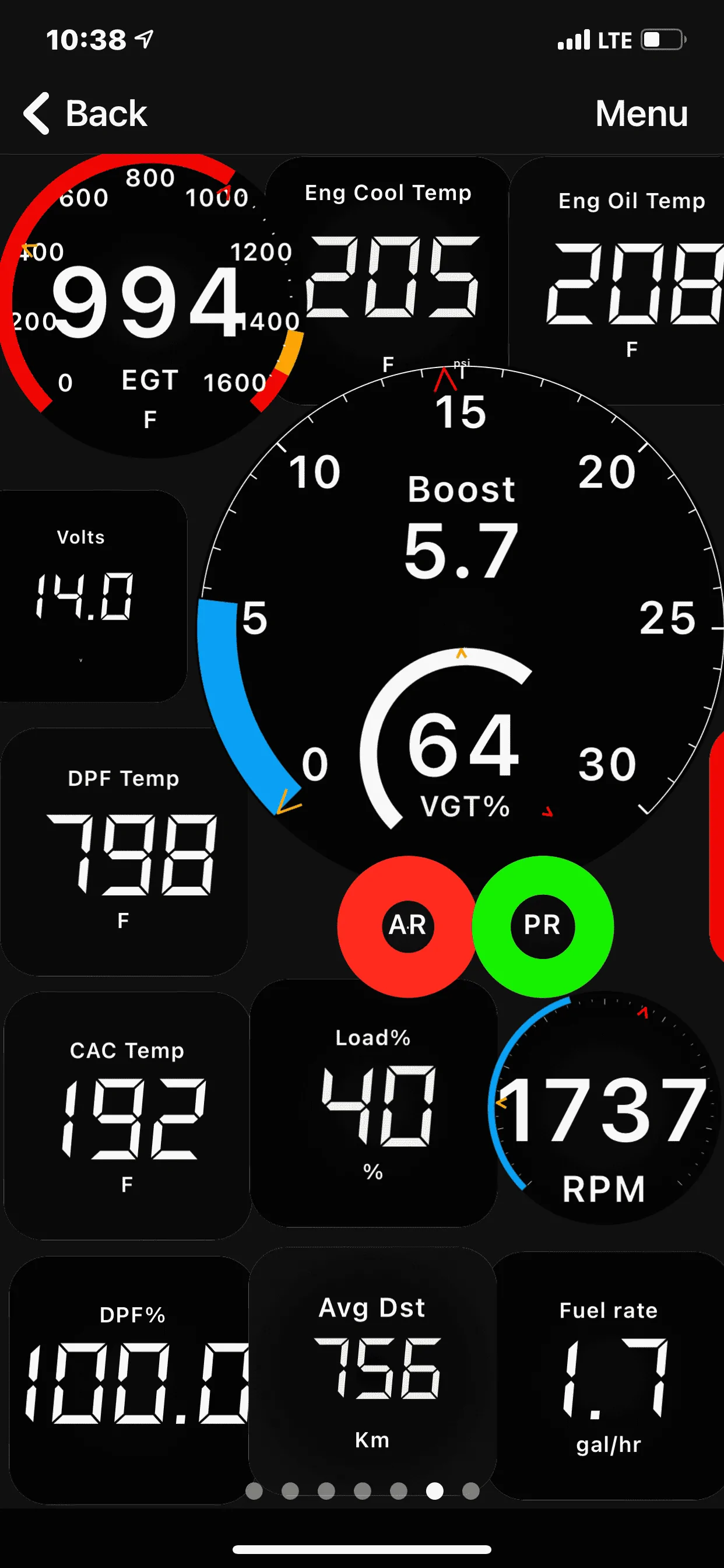

It does. I’m building myself a dashboard. Still work in progress. Testing readability on road etc. I just wish they were compatible with CarPlay now that would be wonderful.
Nice! I like that!
I like the boost gauge on the side. I’ve just begun to play with the dashboards
There are so many settings and configurations it’s overwhelming.

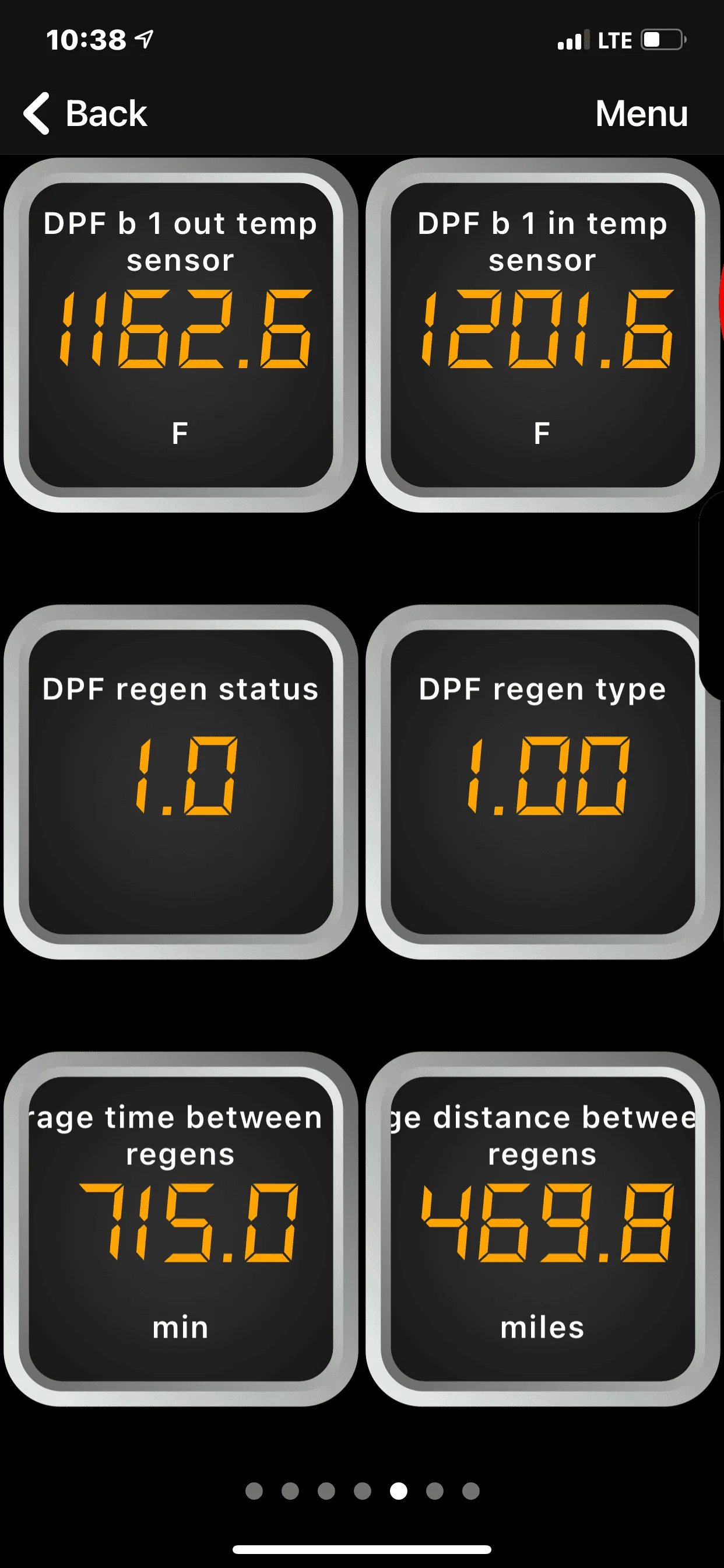

I have written about this extensively in other threads here (let me find some of them) ... I use the OBD Fusion app on my iPhone with a bluetooth OBDii scanner.
I’m right about 500 miles between passive regens.
The distance between regens is only for ACTIVE regens, Passive regens should happen almost every time the engine is fully warmed up and you're not in stop and go traffic.
Otherwise, if active, the instrument cluster notifies you. It will say something about keep driving at a speed above 45 miles Regen needed or your vehicle will not restart.
The ONLY time you would ever see this message is because an Active Regen was started and did not complete multiple times (most likely because you shut the engine off DURING an Active Regen on multiple occasions).
The only way to know that an Active Regen is happening (on the first try or second try) is with a gauge that can read the OBDii. See screenshots below during an Active Regen:
Jeep Gladiator Average Miles Between Regen 2021-03-04 10.38.30
Jeep Gladiator Average Miles Between Regen 2021-03-04 10.38.34

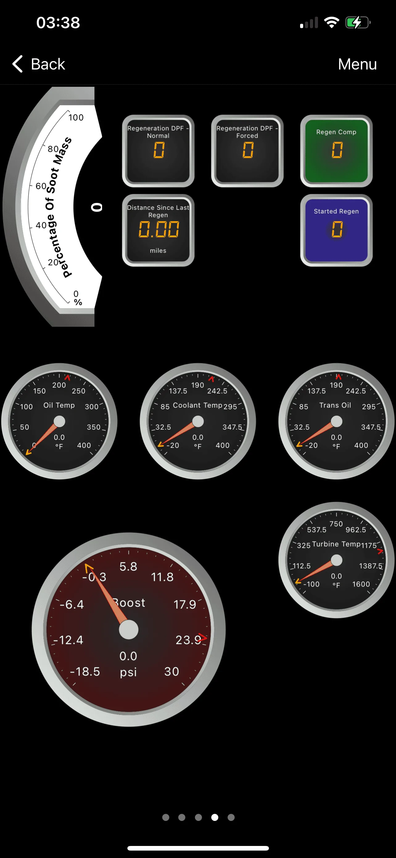

This is what I’m seeing also. My commute to work and back is a short one, 7.6 miles so I’ve been tracking my regents since day one. MX+ and OBD Fusion for the first 2,300 miles until I got the Banks Derringer and iDash. I was seeing active regents about every 450 miles, after I installed the Derringer they went to over 800 miles between regens but even then the DPF never up to 80%, more like 50%. This would line up with there being both a soot level trigger and a miles/hrs trigger.

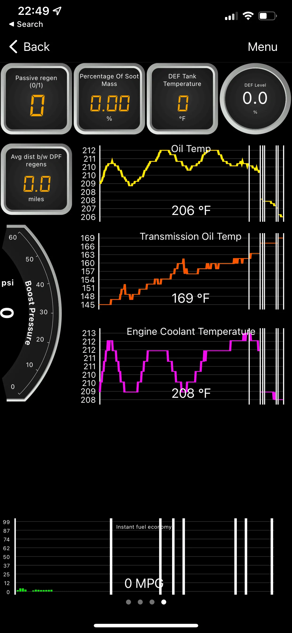

I’ve noticed that passive regeneration triggers @ 80% soot. If temperatures are not high enough when passive regen starts, it will fail. I typically see about 800 miles or more between passive regen. That’s assuming I’m driving mostly highway. Because of the cold weather I tend to idle more, either remote start to warm up or killing time in the truck before work. Soot increases faster on idle.
I set an alarm on Regen to turn red when active, makes it easier to see. I also keep the count of completed vs attempted regeneration. Sitting around 50% with 6 cycles complete, 11 failed. Never have triggered an active regen though. && most of those regen were when my wife was driving, stop & go, short miles.
