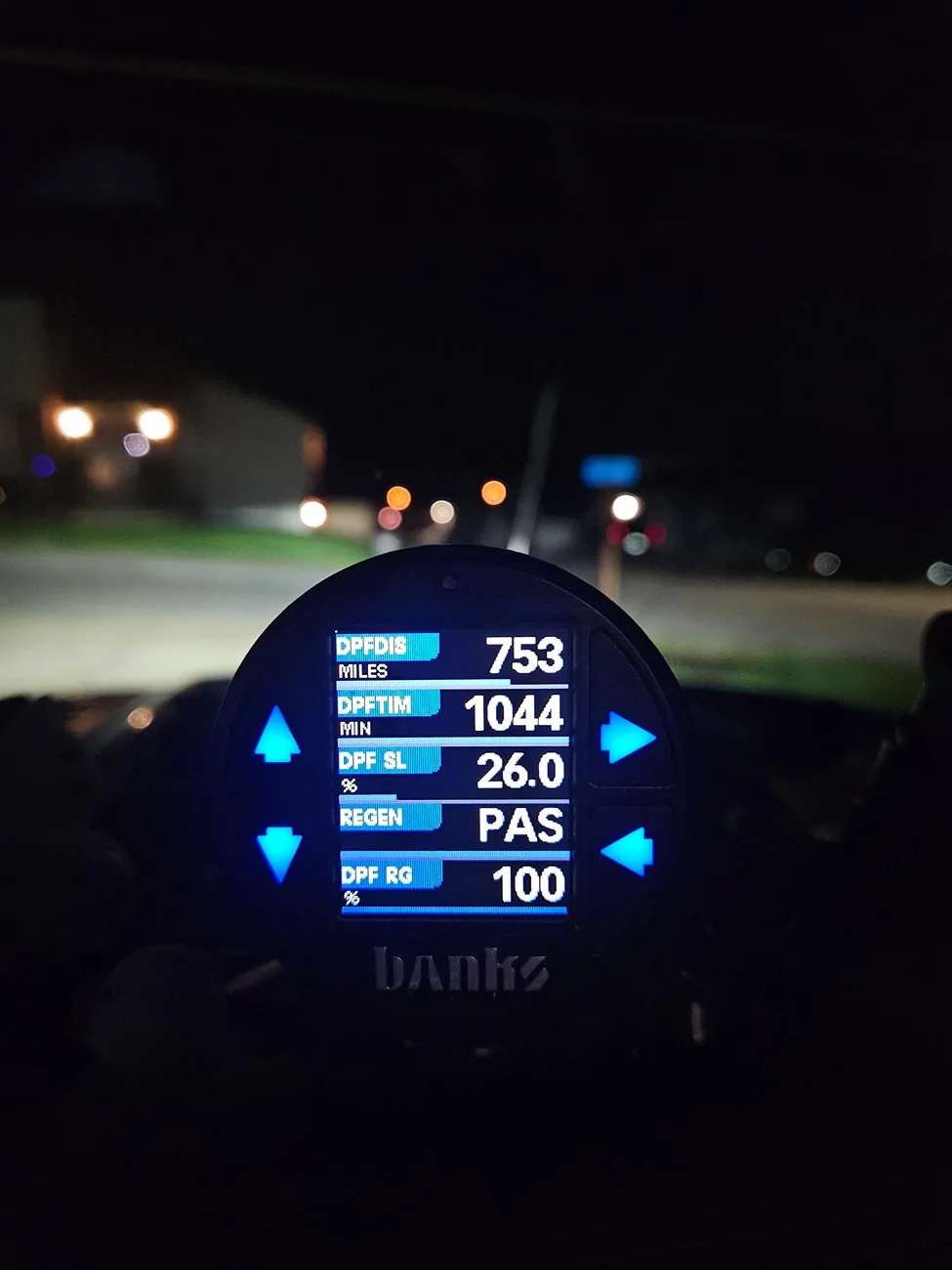

I have a 2023 Ecodiesel Rubicon. I added the GDE hot tune with transmission tune and Regen message. I also use Archoil every fill up. Here is my observation. I have gone into regeneration every 996 to 1000 miles except for once at about 300 miles after what I believe was dirty fuel. This week, I was towing and my SL was 16%. My truck went into regeneration at 996 miles. It took just as long to complete regen. SL is always at 9% when finished. I believe there is a maximum distance before regen happens regardless of SL.

Do you get the regen message, or do you have another way to monitor? I have the IDash to tell me %
12,538
33,255
Transplanted to Razorback Country
'22 JTRD, '11 370Z Nismo, '07 Honda VFR. ;17 Compass
Muff Diver Union Local 69
I have the iDash gauge. Have over 64,000 miles on the clock. Lately my regens have been less than 800 miles and 1,000 minutes. SL% normally is around 40% for a long time then shoots up to 75% to 80 % before regen starts. When finished, it's at 9%.
Deleted member 57233
I get the regen message on the dash. I'm also running the iDash and Derringer/Pedal Monster combo.
12,538
33,255
My iDash gauge.

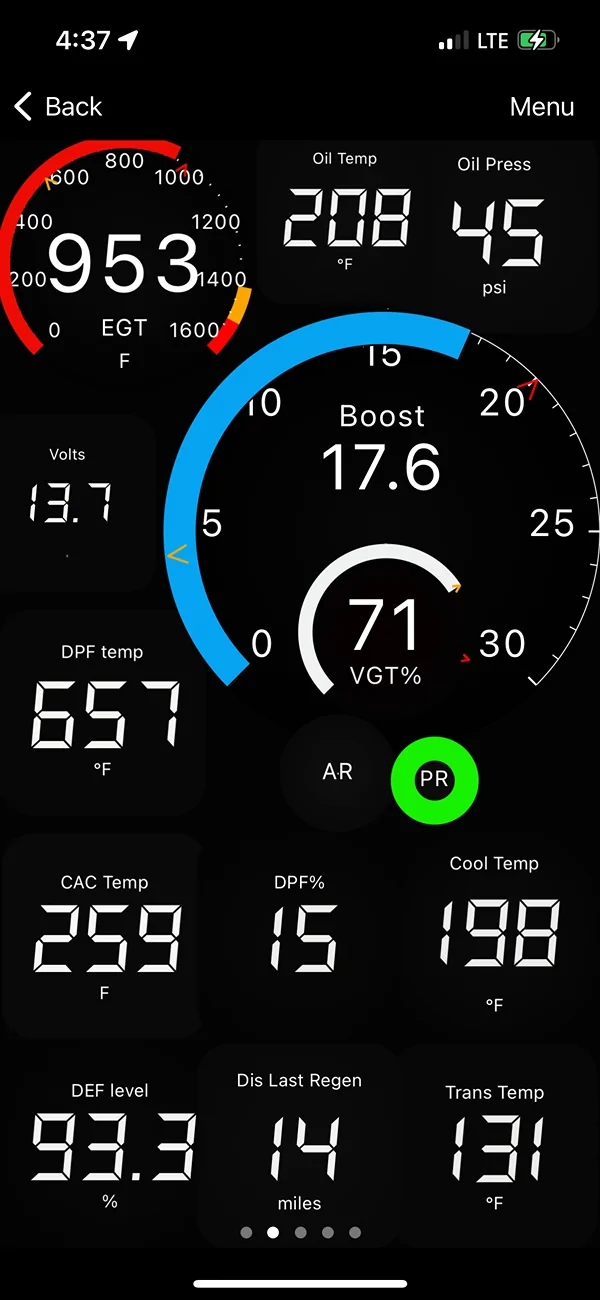

Can I see when the regen happens, and see my Soot Load, by using the JScan app on my phone, connected to VeePeak OBD + plugged into the OBD port?
I don't have an iDash or any other 'gauge'.
Thanks!!!
GRDIESEL
Gabe
Apr 8, 2021
127
131
Michigan
2021 Sport S Diesel
Yes - you can use your Veepeak OBD adapter and an app like OBD Fusion to create a dashboard of gauges. You can monitor DPF% and and Regen T for active Regen.
