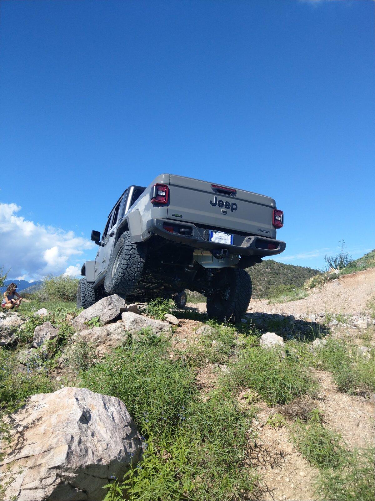

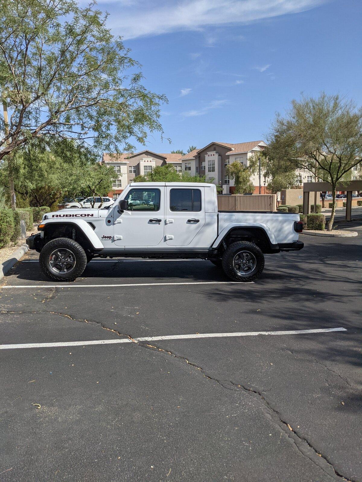

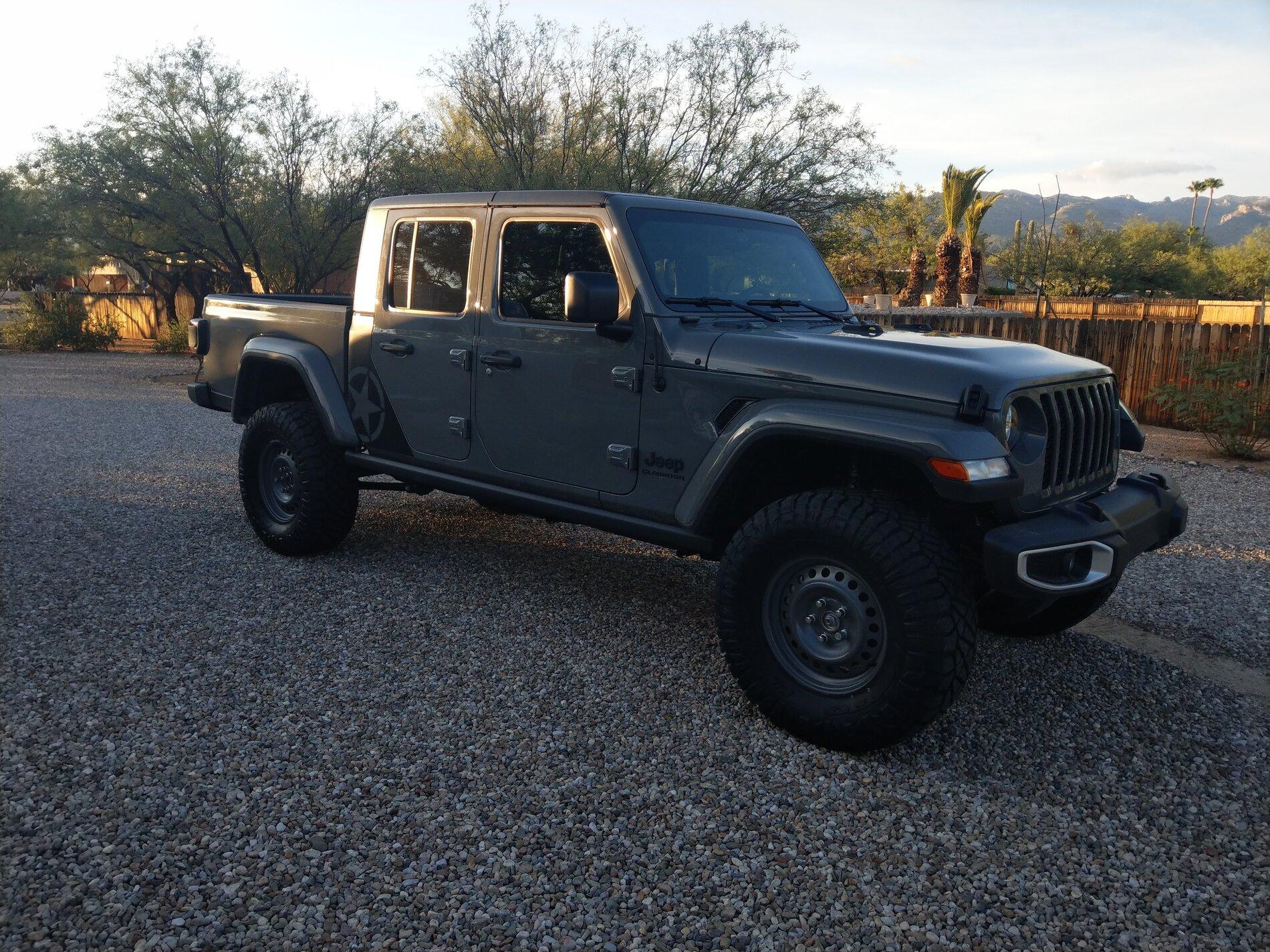

I did my install this past weekend. Didn't need an alignment. Didn't need trackbar. I used daystar 3/4 level.Install was actually pretty easy and straight forward. Took me and a buddy a little over a 4 hours in the garage and. The hardest part was breaking control arms loose.

Can you post more pics tire and wheel specs?

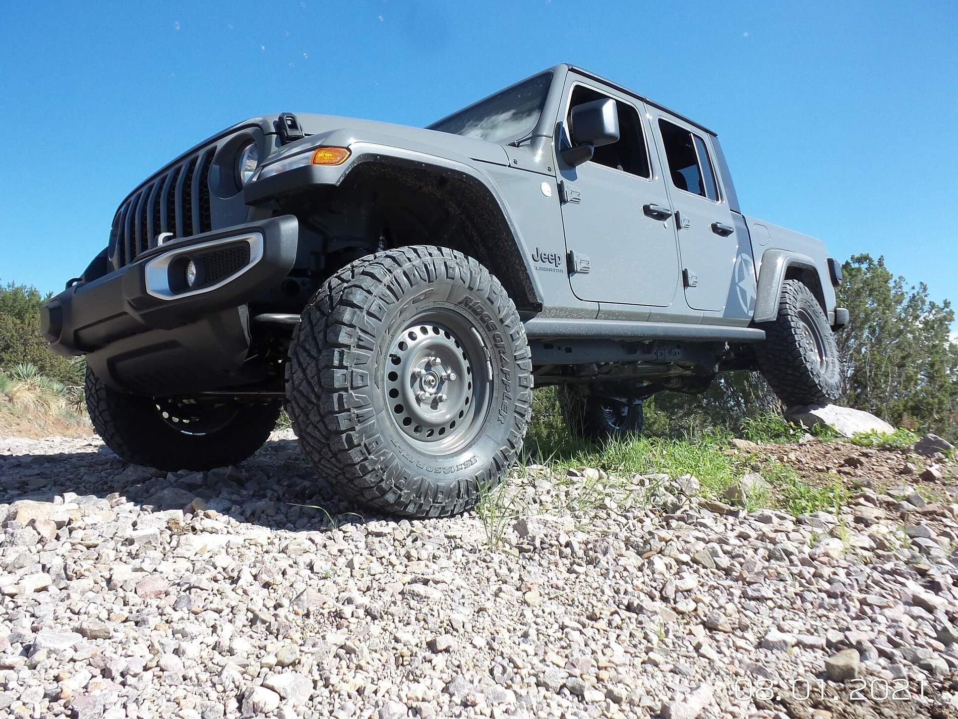

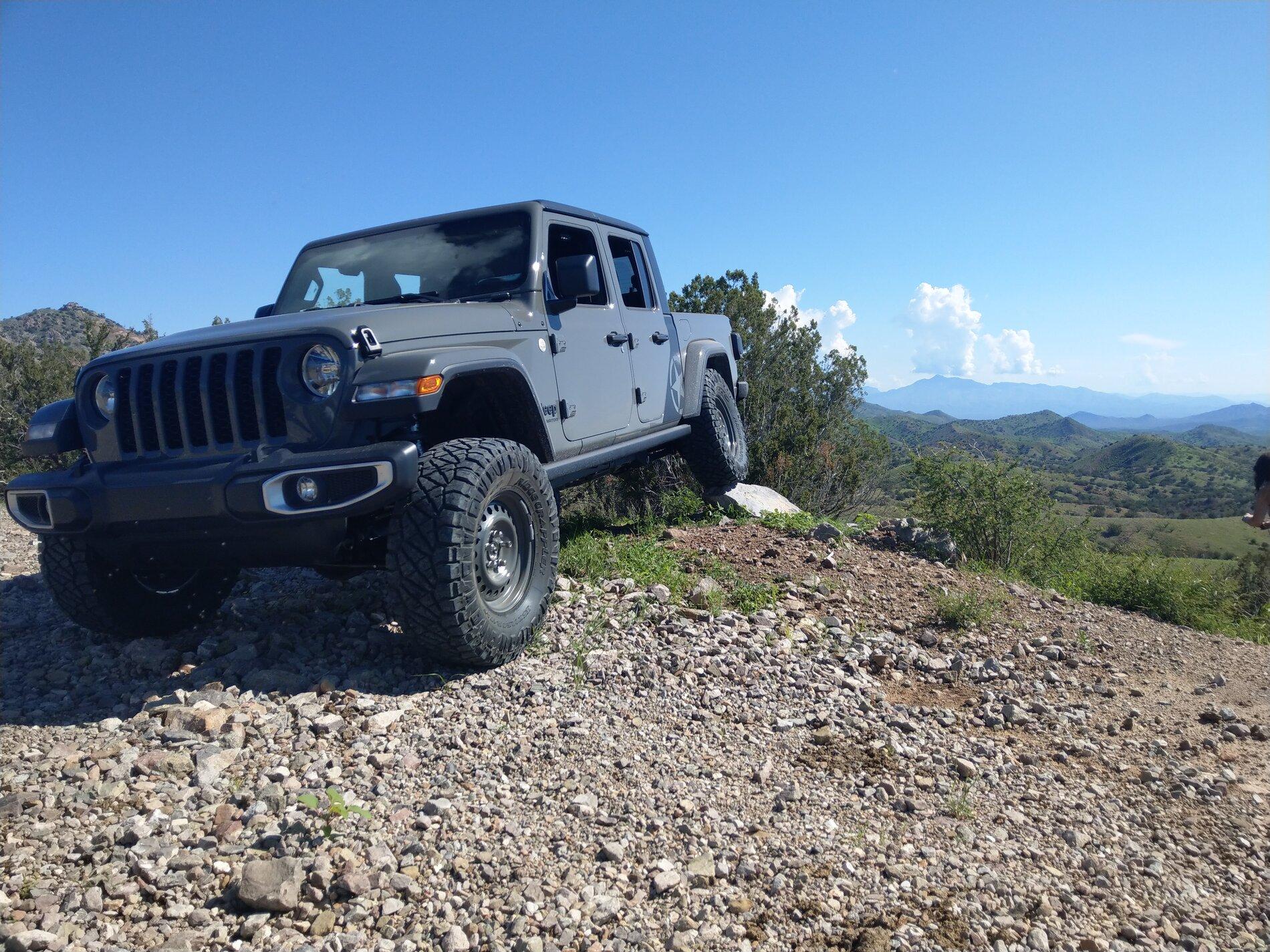

@Pfitter the rims are actually the stock steelies. 17x7.5 with 35x12.5 ridge grapplers

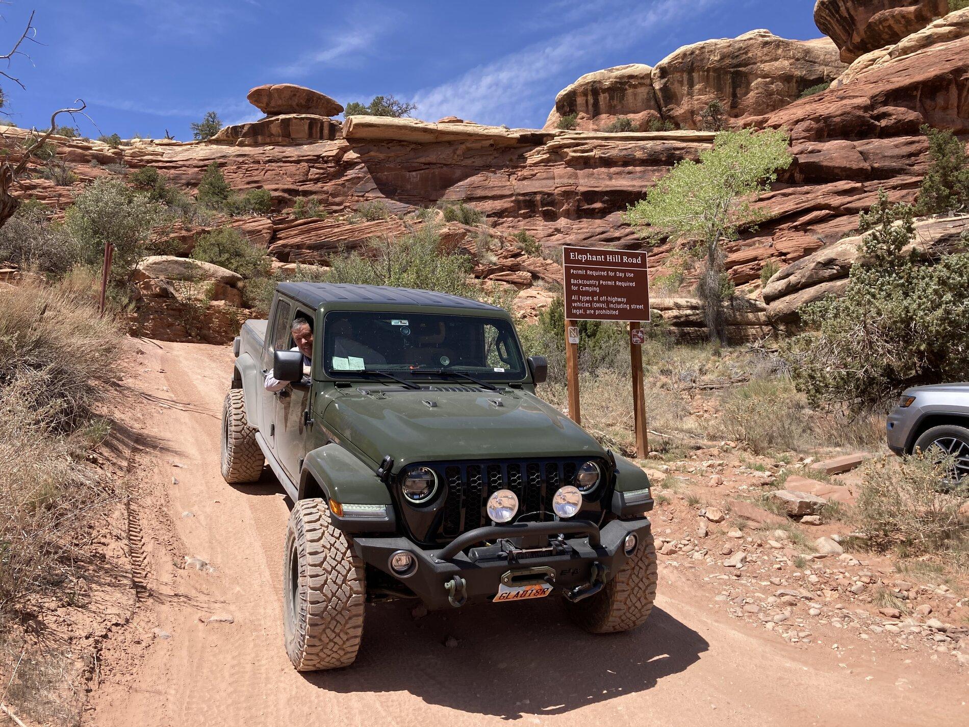

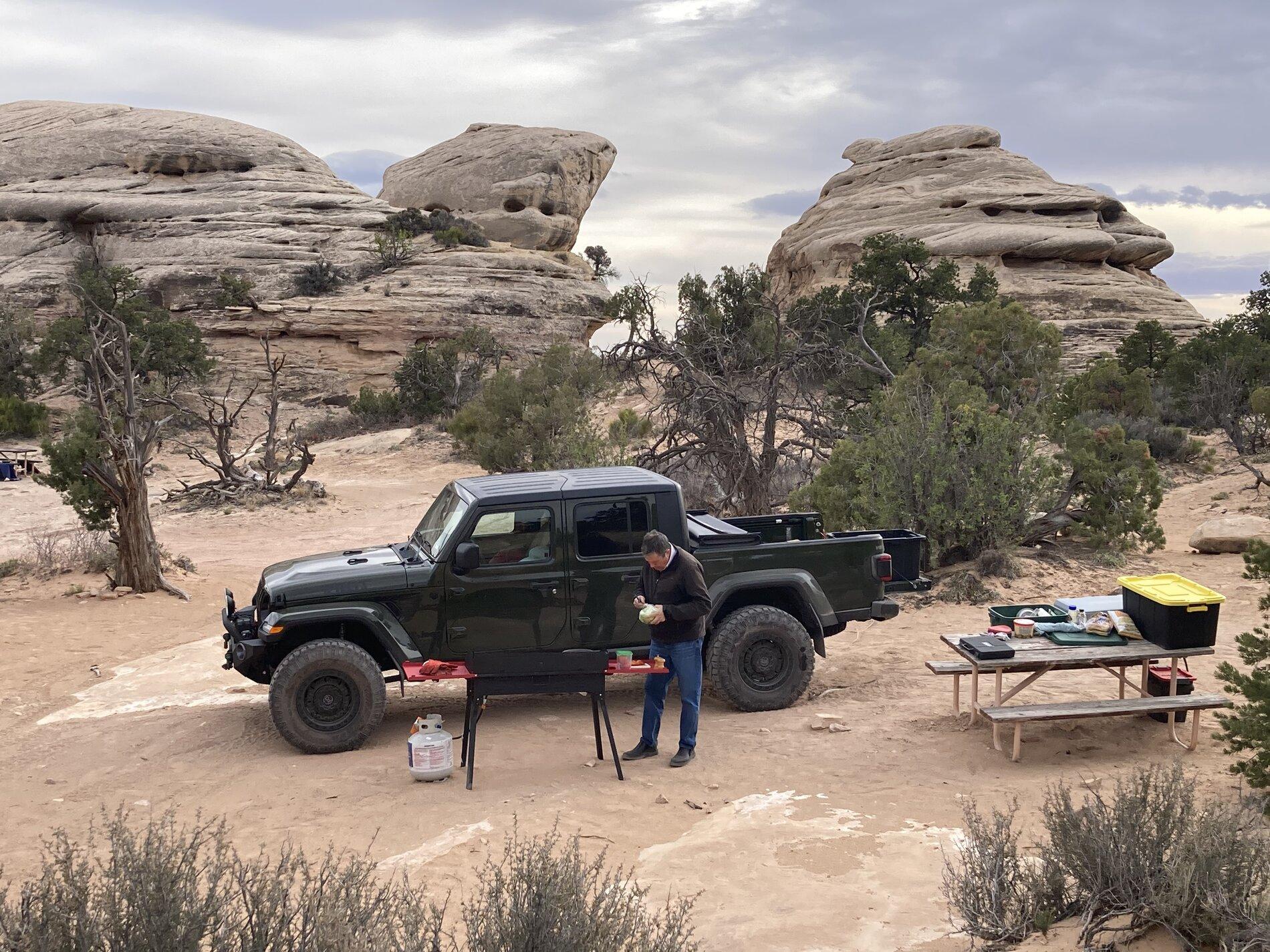

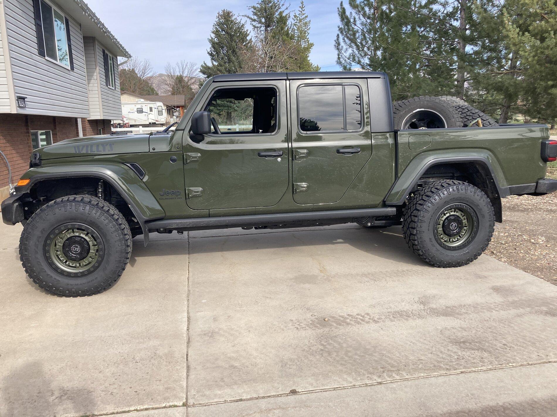

Back in March I had to make a lot of calls to find the Mopar 2” diesel lift kit. I got the last one in the state of Utah. The dealer knocked 10% off the list price. I called different dealers for installation and found one willing to do it for $450, including alignment. I didn’t add any pucks or track bars. I then mounted 35‘s on Black Rhino Abrams. I’m happy with the way it rides and drives, I found the highway and down in Moab.

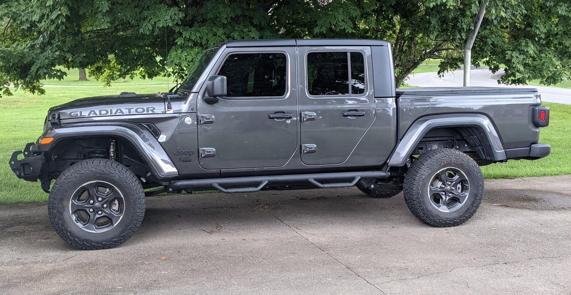

Has anyone with a diesel had this lift done but kept the stock size tires? I Would like to see pics of this setup.
Just did mine this weekend. Currently 33s on it. Will be doing wheels and bigger tires at some point.

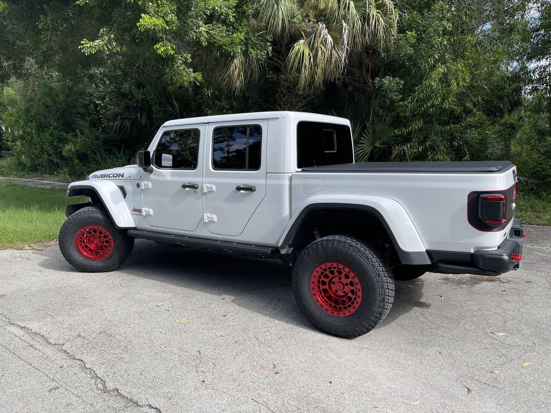

Jeep Gladiator 2 inch Mopar lift for JTRD 512D52B8-5E23-4FD5-A8C4-F9B4FBC43A5C
About 4 hours to install Mopar Lift, back was the toughest.
35’ Nitto Terra
17’ Black Rhino
