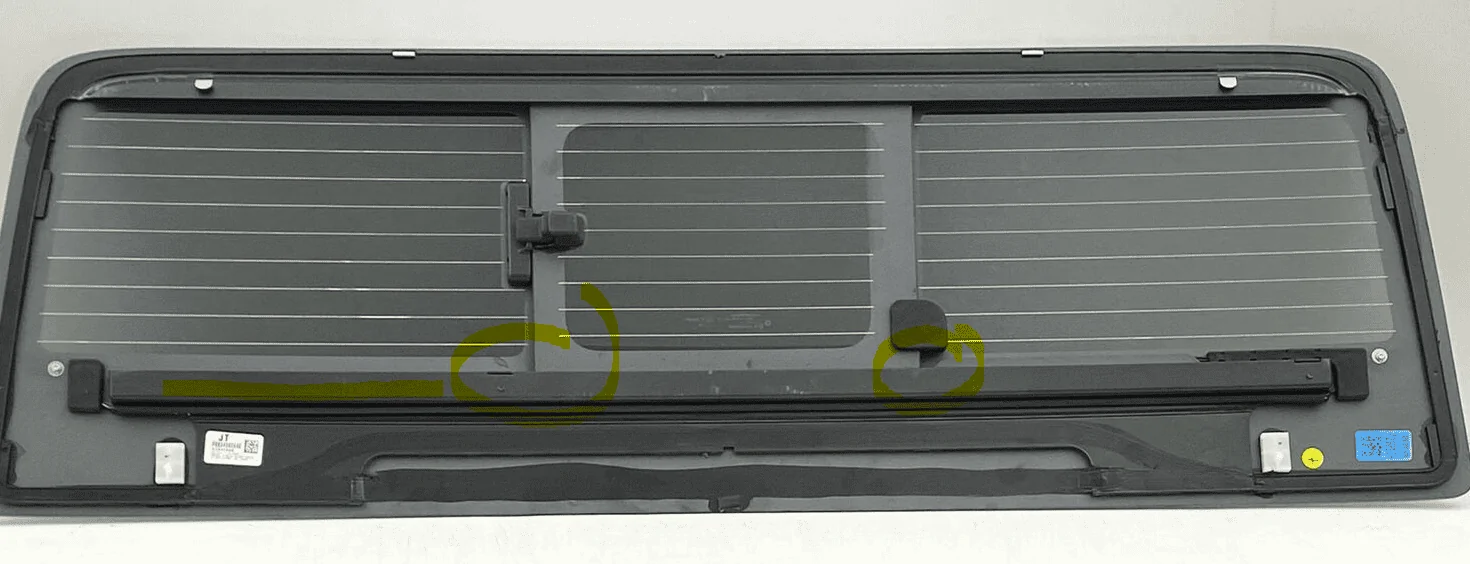

Most of the water that hadn't dripped on the sub, my tools or our gear was in the yellow marked locations.

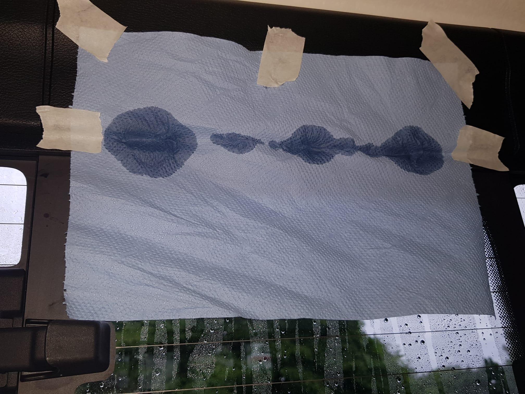

If it looks like this, the dealer will replace the entire rear window under warranty. There's an entire thread on people that have had this done but I can't locate it right now. I did have to wait about 3.5 months for the repair but the amount leaking was minimal and was contained with a towel.

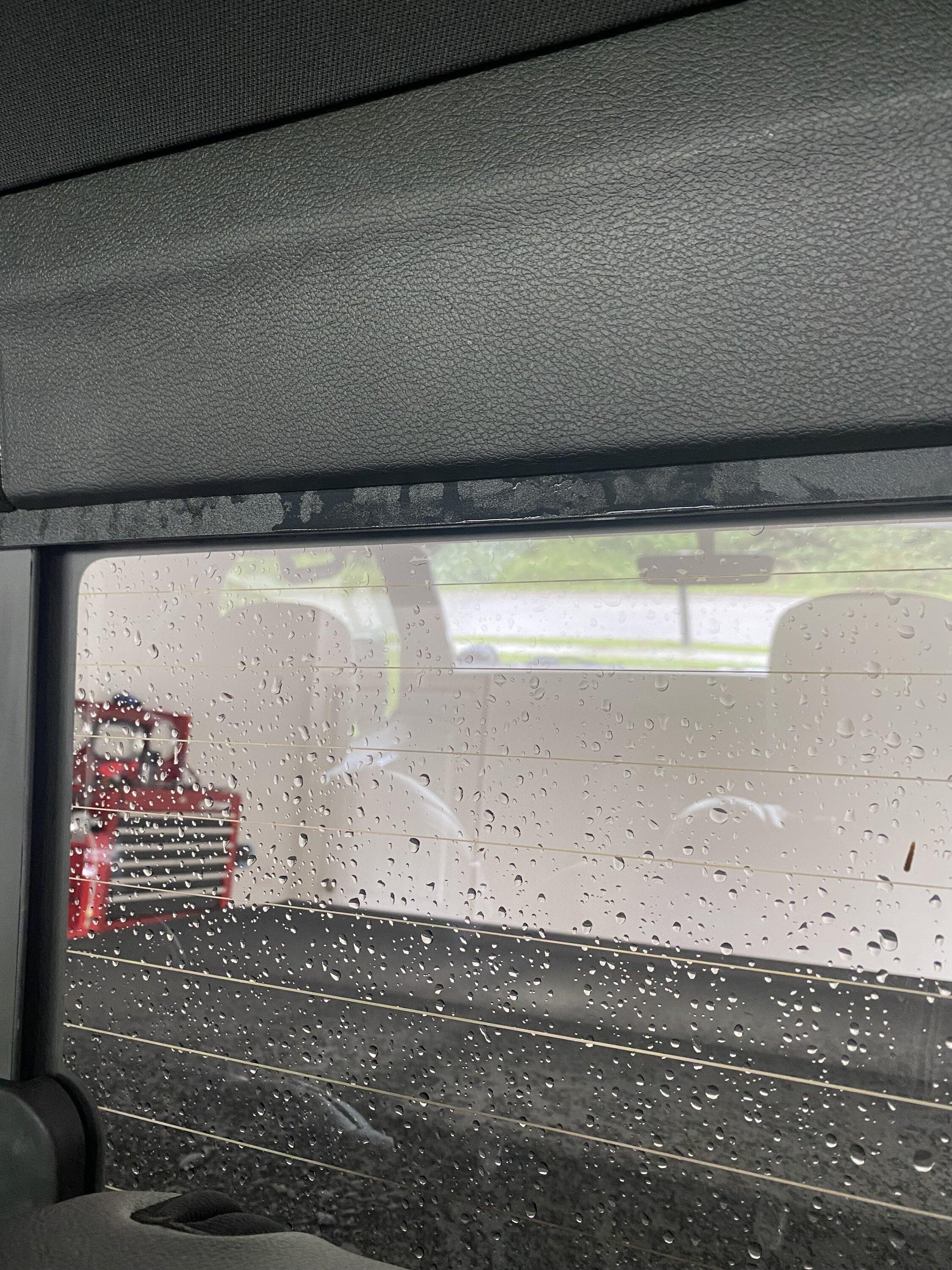

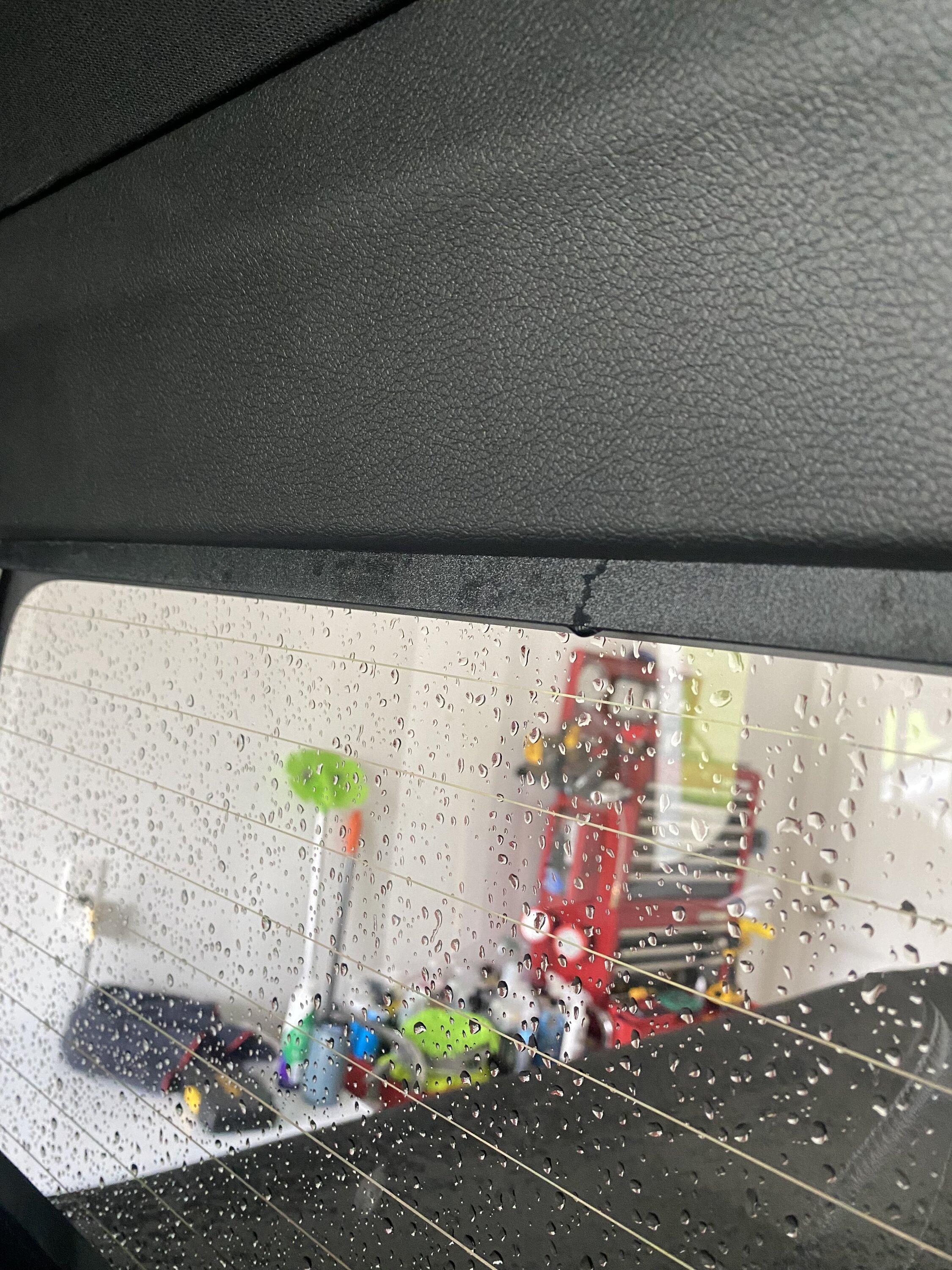

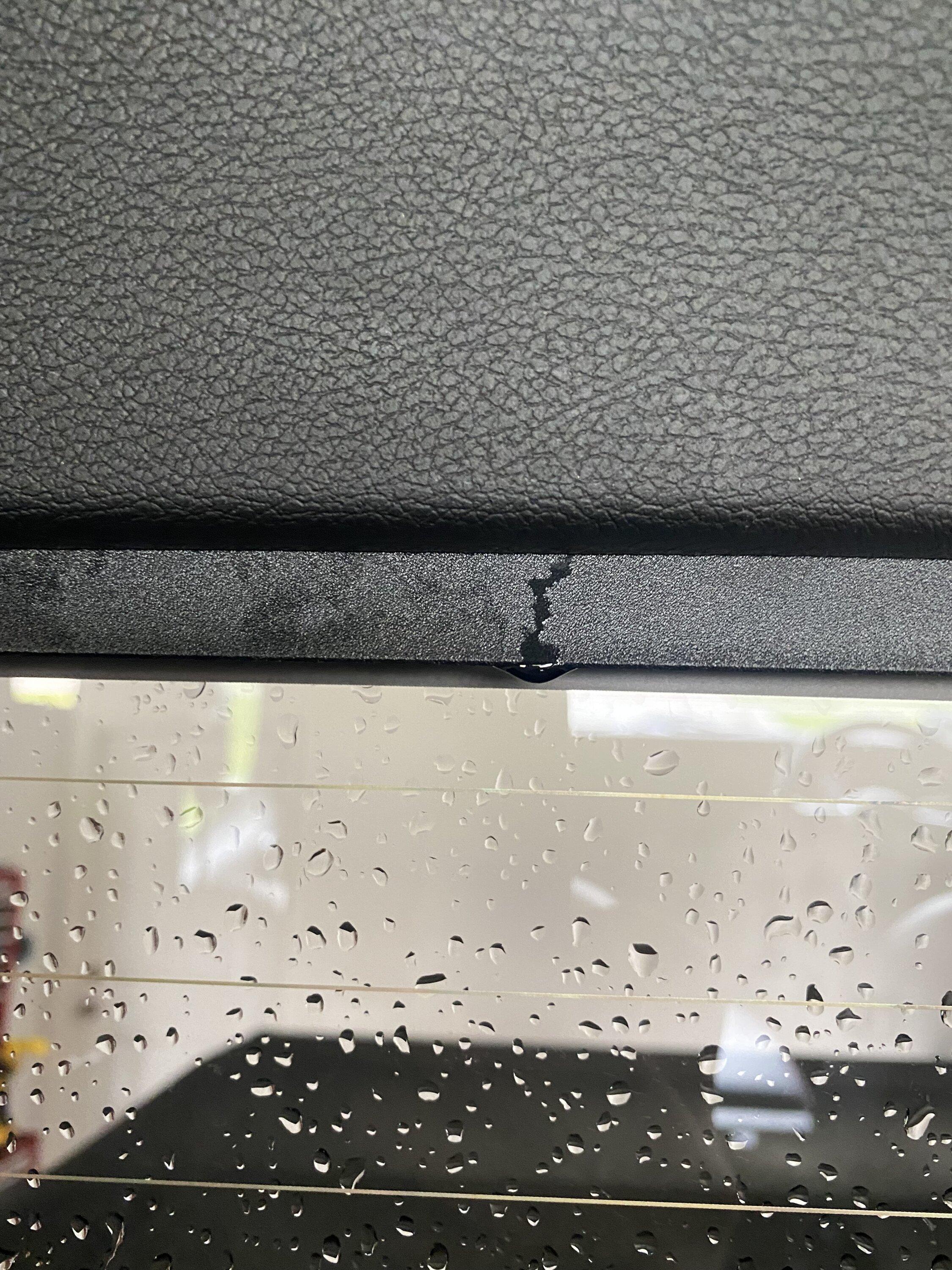

A few seconds with the pressure washer at the car wash...
Jeep Gladiator 2020 Gladiator rear window leak (so far i suspected the actual small opening window, but actually it is entire top of the window) IMG-20220628-WA0003
Jeep Gladiator 2020 Gladiator rear window leak (so far i suspected the actual small opening window, but actually it is entire top of the window) IMG-20220628-WA0001
So it is the large window at the top. Like @Ankh showed.
The fun starts now then.
Calling Jeep Germany to see what they are willing to do on an import.
It is not too much here, but on our trip we had close to a 100 l/m² and everything got soaked as it was pressed up against the rear wall right under the window. It sucks to have no dry towels for the dog and no dry, clean clothing. The tools I sprayed with wet protect and seem to function again.

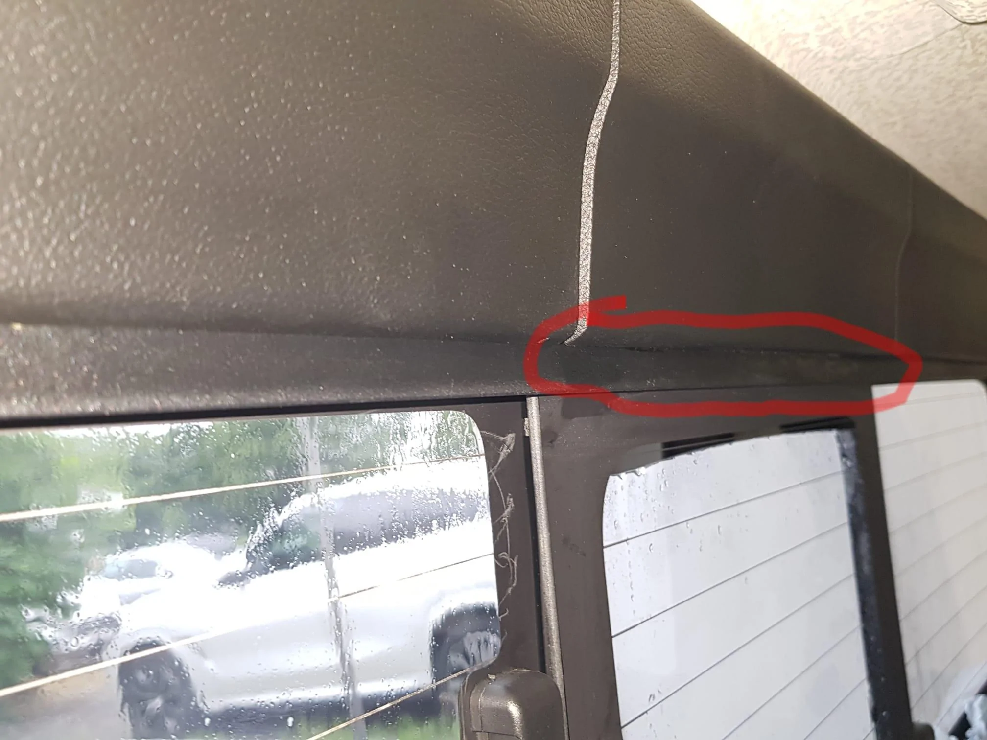

I guess I have joined the club! ?. I am very attentive every time I wash the JT to make sure there are no leaks on the rear window. For almost 2 years now nothing! I drove 45 minutes through moderate rain and when I arrived home I noticed I had some water drips coming from back window. From what I read this is enough for Jeep to replace the whole back window.
Jeep Gladiator 2020 Gladiator rear window leak (so far i suspected the actual small opening window, but actually it is entire top of the window) IMG_1915
Jeep Gladiator 2020 Gladiator rear window leak (so far i suspected the actual small opening window, but actually it is entire top of the window) IMG_1916
Jeep Gladiator 2020 Gladiator rear window leak (so far i suspected the actual small opening window, but actually it is entire top of the window) IMG_1917
