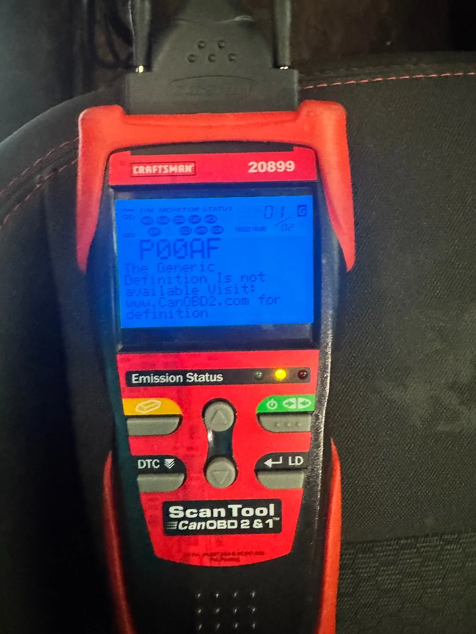

Well it’s P00AF I’m going to try and take my jeep into my dealer who in the past has been of no help. Let’s see what they will do.
Told ya where to bring it. They have a great diesel tech here
