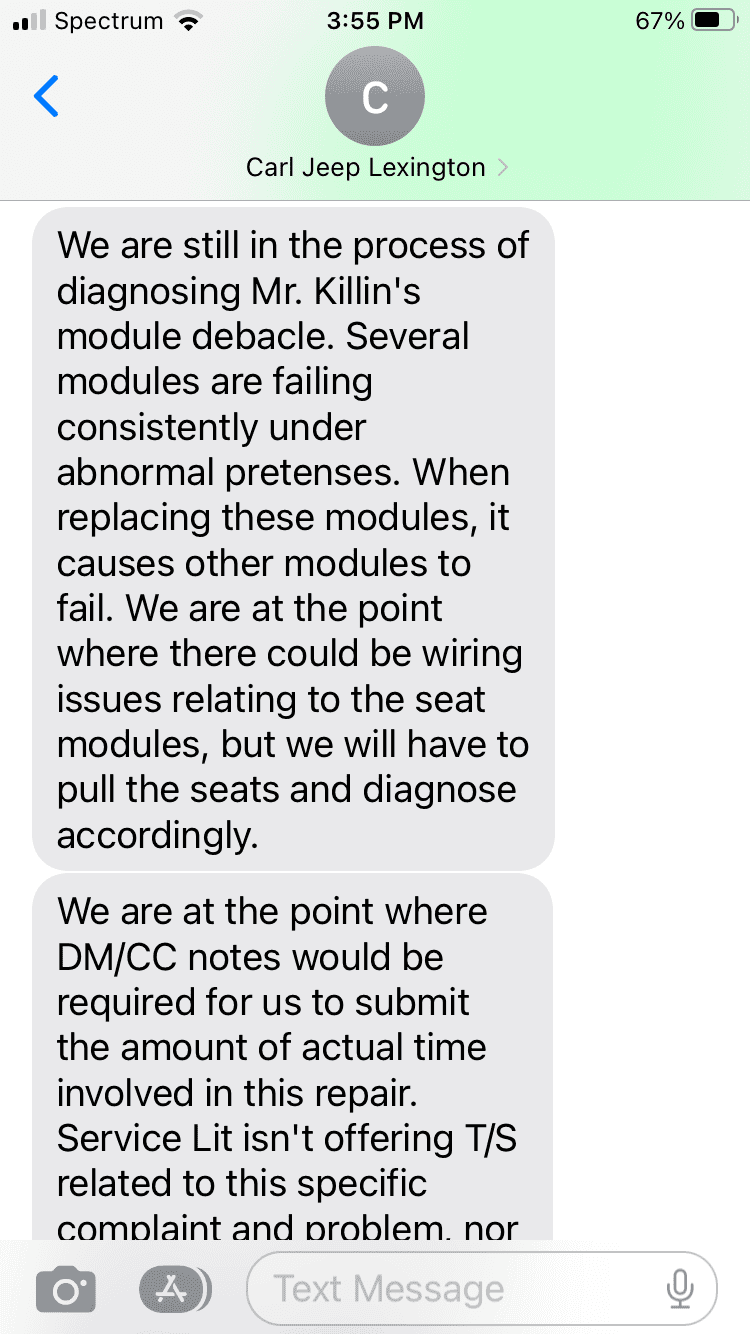

21 Jt rubi
Did you atleast get it home or have to leave it? My dad had his Ram hit by lightning and same deal where had to keep throwing more burnt modules at it until all the electronics would start working. We were 2 hours away from home for that.
I wish. Insurance would have bought it totaled.. it’s in Ky and I live in fl. (12 hrs)

They opened a stars?? Case after the batteries and first module change…
250
40,602
54,291
STAR = Service Technical Assistance Resource
Engineers may then look at it and give them suggestions.
Hootbro had it right - just start tossing modules and chase things around like that old wild goose chase.
People just don't diagnose or troubleshoot these days -
They often don't know how
They are often hand-tied by corporate
Or both

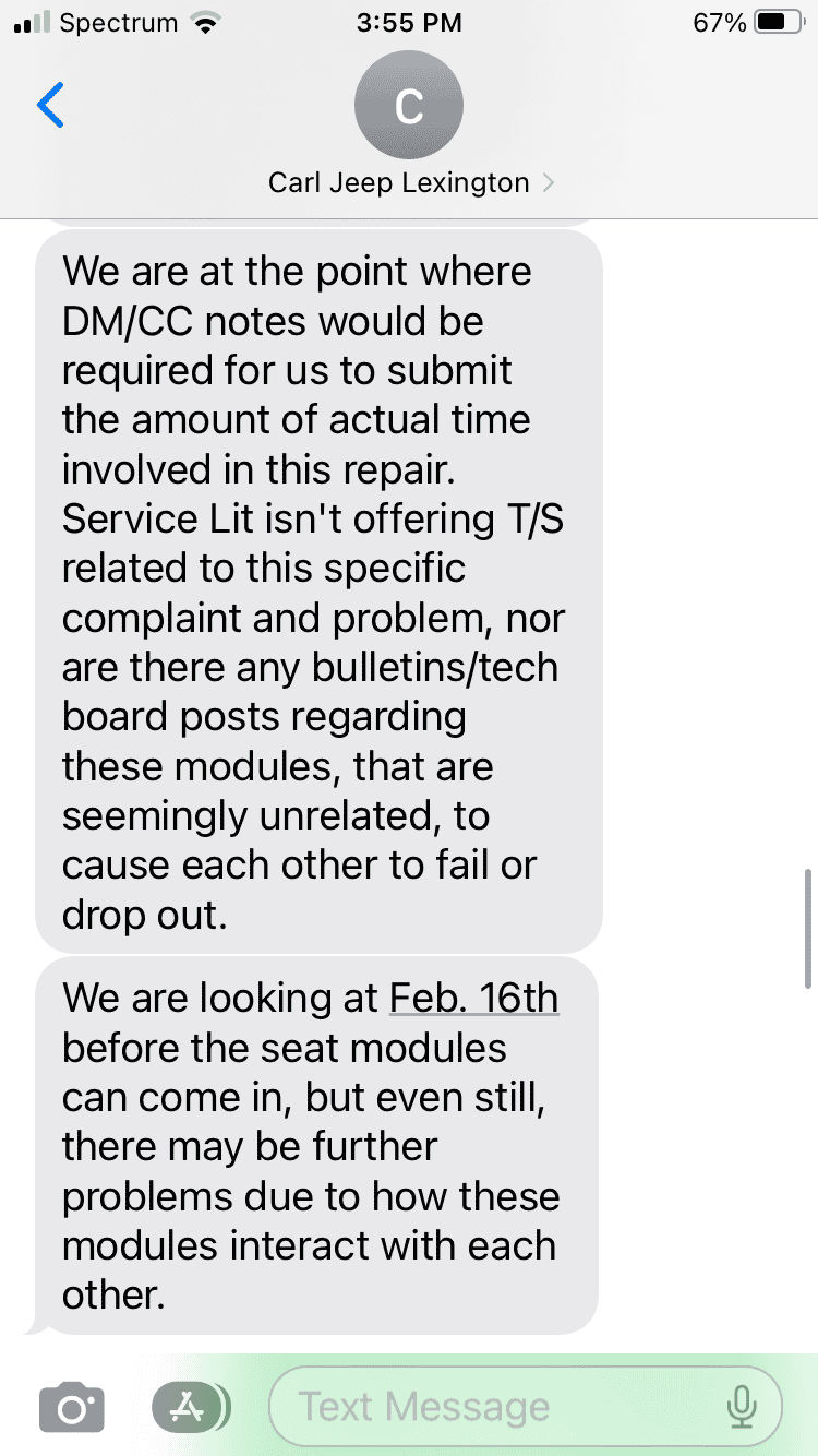

Problem is I went to the store. Then next morning nothing… except dome lights…
Killinbill
Jan 5, 2023
54
Flagler beach fl
21 Jt rubi
They where replacing modules but didnt check wiring before? Whoever the tech is, or the dealer them self, you should probably fire at this point
12 hrs away… 17k miles on it…
