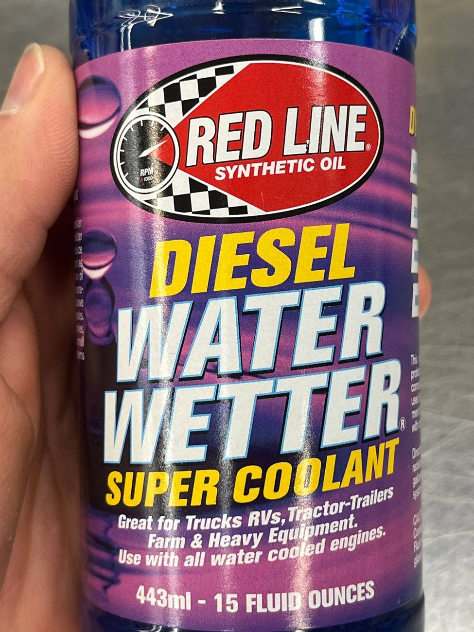

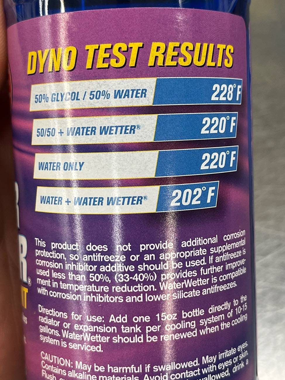

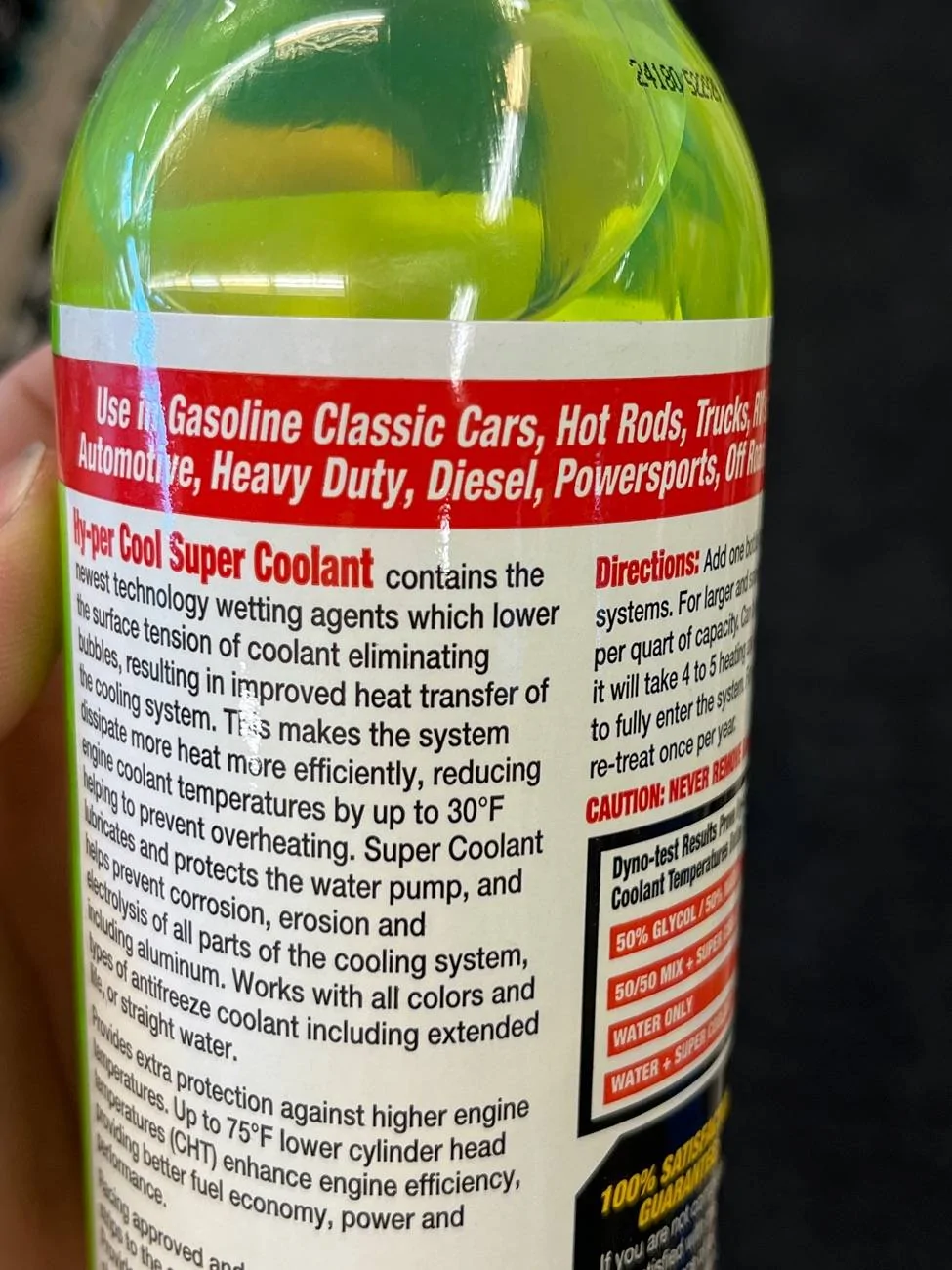

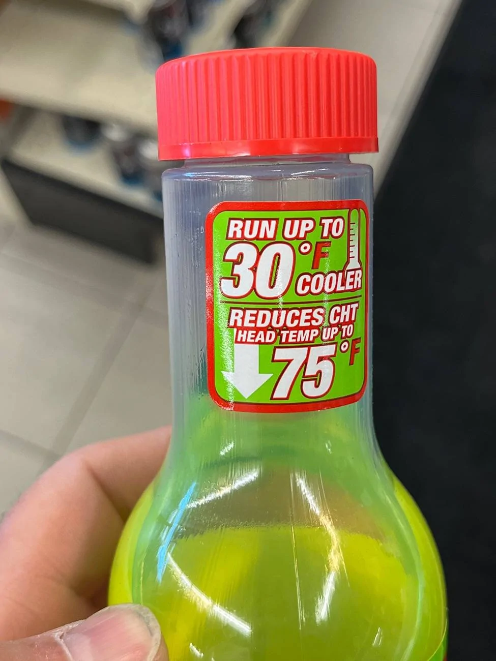

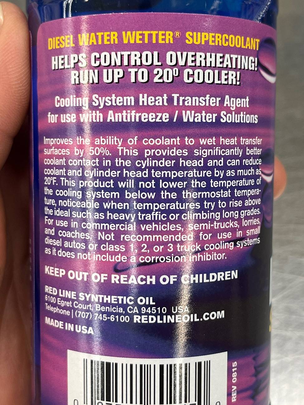

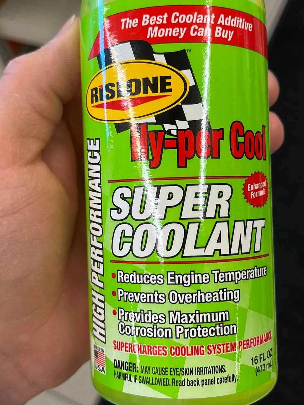

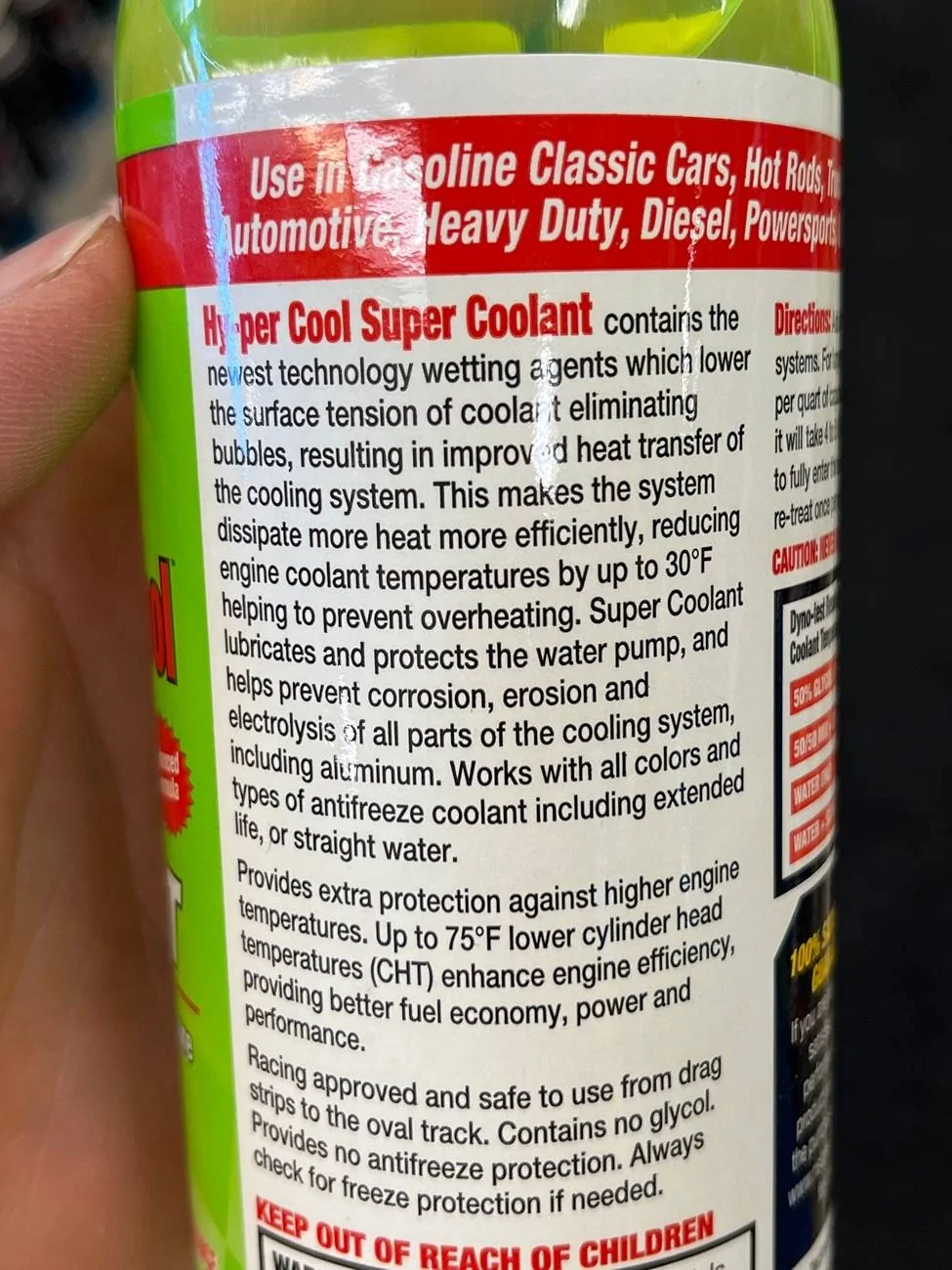

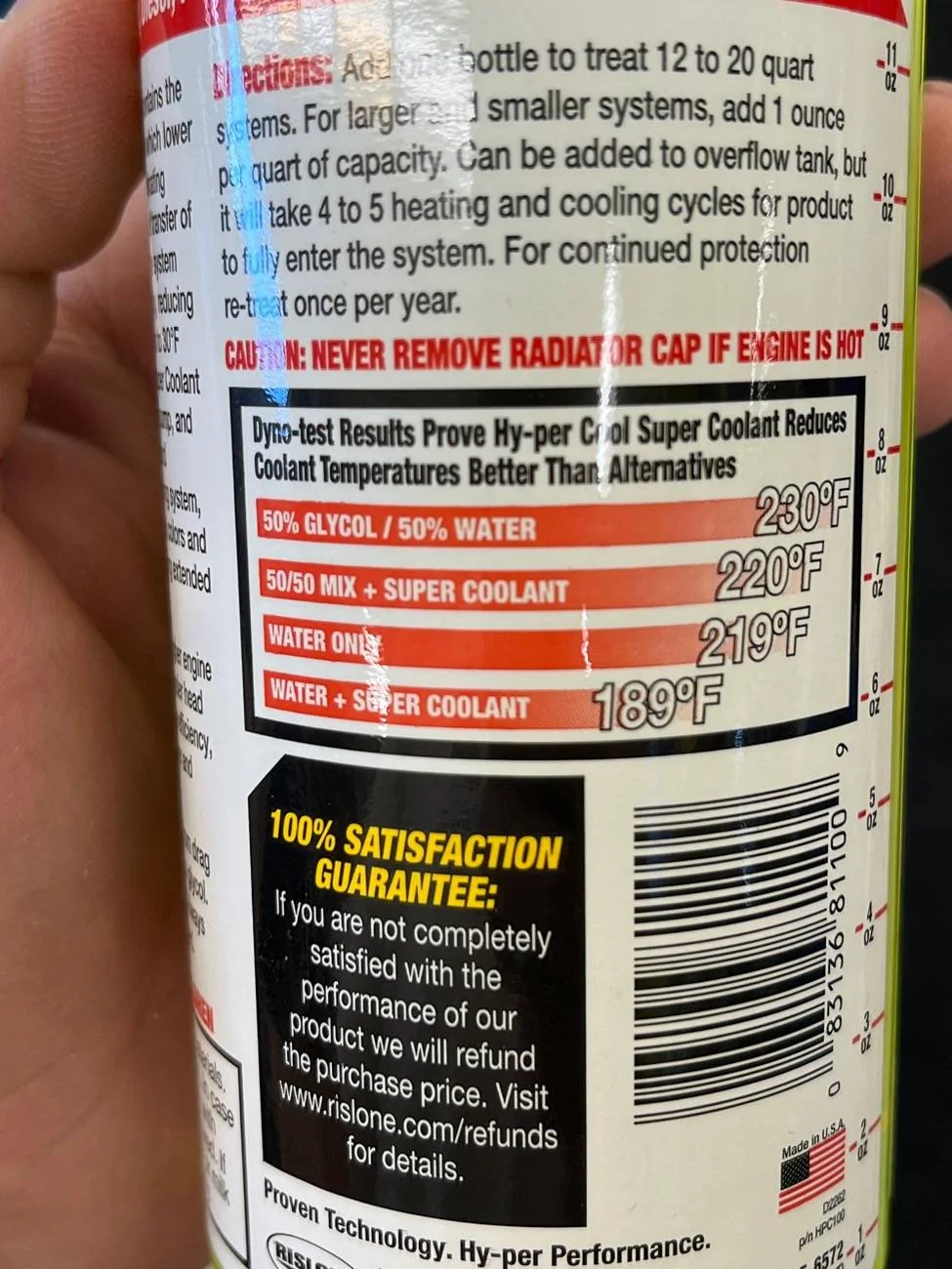

Ok, great explanations and I’m learning a ton here. So focusing on cooling ideas, I frequently visit Auto Value in Calgary a few times a year and I spotted this stuff you add to your coolant that cools temps by changing the coolant chemistry. Immediately thinking of all you 3.0 heat problem owners, I discussed this stuff with the owner. He said it’s not “snake oil” and has been tested and works.
Just another idea that might work when everything else has failed. IDK 🤷🏼
Tried these, specifically the purple bottle, absolutely does not do anything to improve the coolant wetability to improve cooling efficiency. Snake oil!!!
Figured I might be a bit late to the game. I hope you all find a real solution. Peace
Their dyno test results aren't real clear, but I wonder what % of the capacity they are talking about? Are they adding a single 16oz bottle to an 11qt cooling system and seeing results? Are they replacing 50% of the capacity with their product? Did you just add a single 16oz bottle and see no benefit? Water only seems to be more effective than their product plus the typical 50/50 mix so there's that option. They had a 3 pack of the hyperlube brand for $22 on amazon so I'll drain out enough to add 48oz of the stuff and see if it helps. Next desert trip is 2 weeks away so I'll keep everyone posted.
The water wetter works to a certain degree, but that doesn't help much with the oil temps, which is what the biggest issue is. In order to reduce oil temps, you would need to go to a larger oil pan. Even adding an oil by-pass system might help a little since that should increase capacity by nearly a quart.
I added a deep oil pan with cooling fins on my 2015 Ram Ecodiesel. It increased the oil capacity to nearly 12 quarts. That made a noticeable difference when towing on long steep grades. My truck no longer sees those derate temps that I used to see.
My concern is, is it compatible to the OAT coolant. I looked at a “coolant conditioner” from another source that states on their bottle “compatible with all coolants”. Further digging into that conditioner, the base was “propylene glycol”.
From the reading of my owners manual, OAT is an ethylene glycol and can’t be mixed with propylene and if it is mixed, must be flushed out. I contacted that company and told them about this.
I asked the Auto Value owner if these two products were compatible with OAT, his reply was “it should be”.
That’s not concrete enough for me. I need to find the data sheet or MSDS sheet on these products to know for sure.
Here’s a write up from Summit Racing that shows it’s compatible with both ethylene and propylene glycol, our OAT coolant being ethylene.
It also speaks of the mixture and what % does best.
https://static.summitracing.com/global/images/instructions/red-diesel water wetter supercoolant.pdf

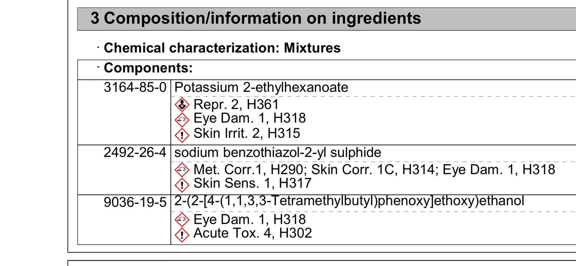

I looked up the MSDS data sheet for both Rislone and Red Line Super coolant and did not see propylene glycol as their base chemical. I’m not a chemist so can not speak to the compatibility of their base chemicals used and our OAT coolant. That would take someone with a much higher pay grade and IQ and understanding than me to know which packages work better.
This first one is Rislone Super Coolant:
Jeep Gladiator 3.0 Derating Problem SOLVED…(maybe) IMG_4720
Trying to find the Red Line MSDS sheet is a bit more problematic. I can find one for their pink solution but not the purple stuff, or I need to sign in for a PDF. Will keep looking
It says 1% water wetter? So for our 11qt cooling system we only need 3.2oz? If that's the case, and especially if it is less effective at higher concentrations, I'd bet that almost everyone who's tried it is using way too much and that's why they aren't seeing results. Being that it's rarely below freezing where I live I think I might try dropping my coolant to 33% and adding 1% water wetter and see what happens.
