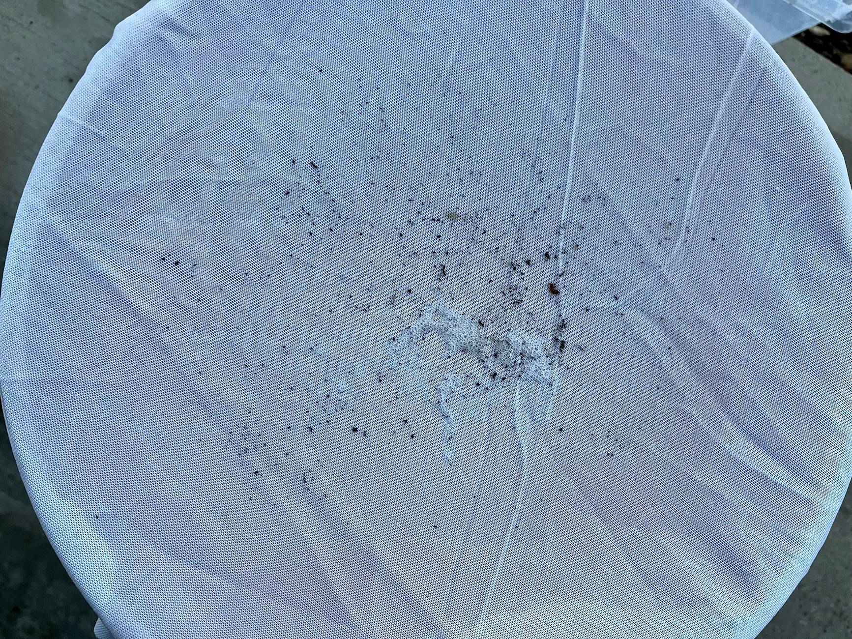

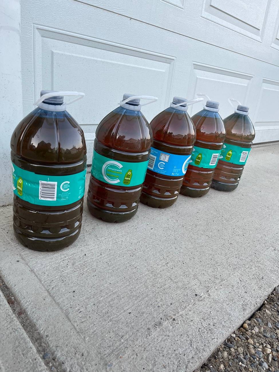

Also, if you haven’t done a flush yet, I’d highly recommend doing one if only to rid the system of assembly sand and other debris floating around in there. I did the flush on my second 3.6 at just 10k klms. …well actually, I ran 5 jugs of distilled water through, draining each one after reaching full temp, then strained it all through a rag into a bucket. This is what I no longer have floating around creating havoc.
Jeep Gladiator 3.0 Derating Problem SOLVED…(maybe) IMG_0980
Jeep Gladiator 3.0 Derating Problem SOLVED…(maybe) IMG_0981

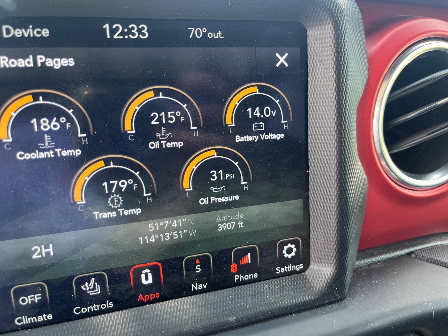

UPDATE: So, wanting to try the Red Line Diesel Water Wetter product on my 3.6, I did 3 coolant flushes today using 3 - 4L bottles of distilled water. I didn’t tamper with the small plastic drain valve at the bottom driver’s side corner of the rad and just went with pulling the bottom main hose off at the bottom middle location of the rad. Pulling the hose off here doesn’t dump everything out but good enough. I put in a 4L jug of water and ran it to temp and even encourage the thermostat to open and fluid to cycle through before shutting it off and dumping the fluid (x3).
After the 3rd flush, I did a test of the fluid and it showed a boiling point of 156F and freeze temp of -12c so I figured I had run enough through and there was plenty of watered down solution in the engine cooling system. I dumped the whole 15 ounce bottle of Red Line Diesel Water Wetter in and then poured a full 3.7L jug of 50/50 Cummins Fleet Guard OAT coolant (yes, I run this in my 3.6 gasser) in and ran it for a while to get the bubbles out and for the thermostat to open.
It took a very long time but I managed to get it to 222F before it opened and temps dropped to about 198F. I then drove it off the ramps and went for a drive out on the highway and up a steep grade near me. Now, I can tell you I frequent this highway often and when I’m going up this grade, my coolant temps will get to 222F. The oil temps can fluctuate a bit but are typically close range together.
After doing this flush and adding this one bottle, the coolant temp was nowhere near what I was expecting.

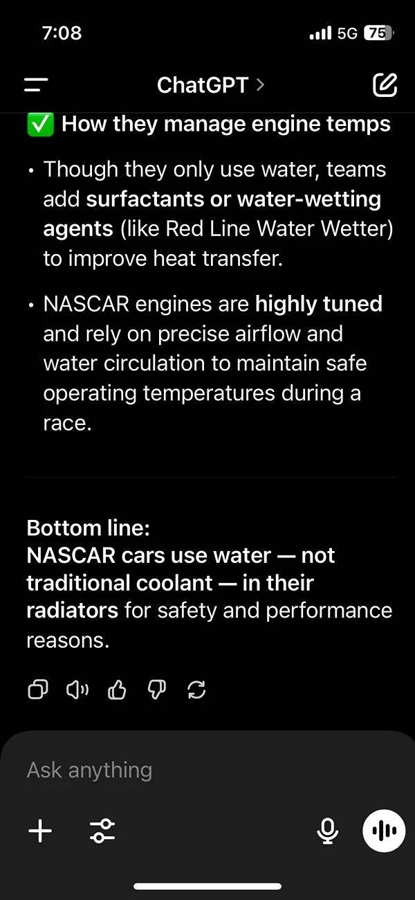

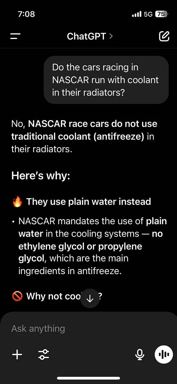

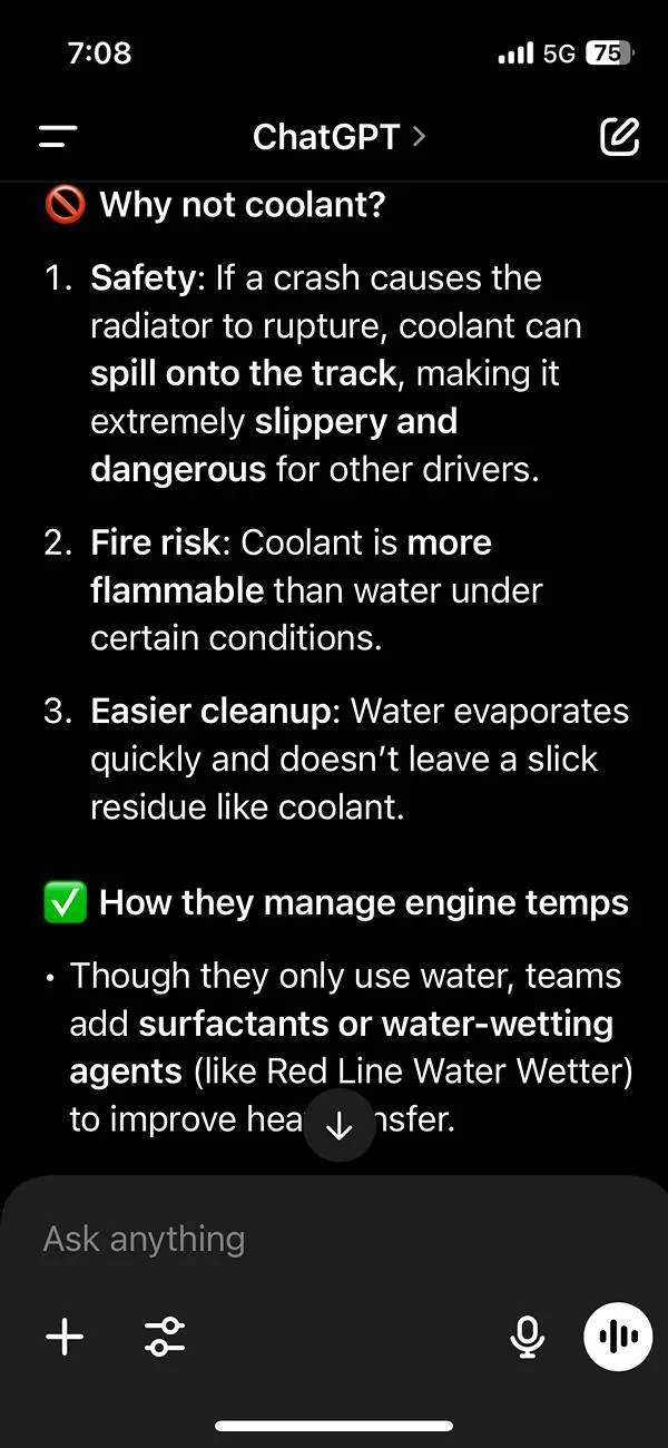

Here’s a little FUN FACT for all you Americans that would appreciate this little info. I once heard many years ago that the cars that race NASCAR don’t run with any coolant and it dawned on me yesterday as I was concerned I was running more water and Red Line Water Wetter and less coolant in my rad flush.
I asked the question to GPT and this is how these cars keep cool. They also run under load, they run hot and they also race on hot days. How do they manage so well??

Water has always cooled better than antifreeze/coolant or any combination of water and coolant. There are 3 major issues with running straight water on a street vehicle. Number 1 is freezing, although that's not an issue for a lot of us. Number 2 is corrosion. Straight water will rust out everything from radiators to coolant passages in the block. 3 is cavitation wear (think of erosion on a hill side in a heavy rain). Straight water will eat the pump impeller amongst other things rather quickly. Chat GPT got the no need for anti freeze part and the safety due to the lubricating nature part, but missed the other 2 factors which aren't an issue for Nascar engines as they are constantly being torn down and rebuilt. It was confidence inspiring to read that cavitation wear certification is done at 33% coolant which is why I'll only be running 33% going forward. Plenty of wear/corrosion resistance and plenty of anti-freeze for my use. That plus the water wetter seem to be the best we can do on the street. We'll see if it helps.

This is true of almost any track motorsport, although glycol based coolant is banned you almost have to use some kind of non-glycol additive, like Water Wetter, to effectively cool the engine.
