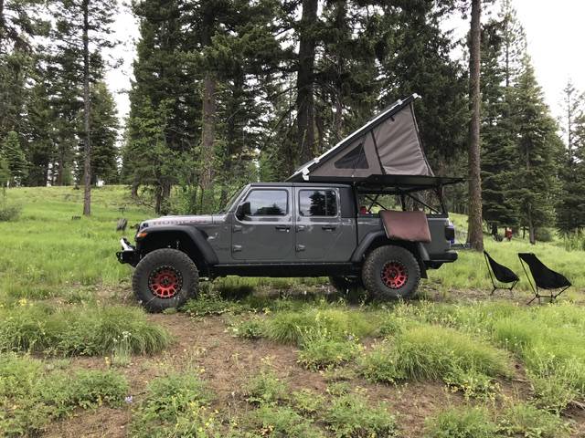

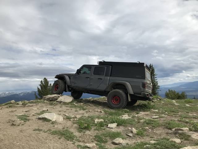

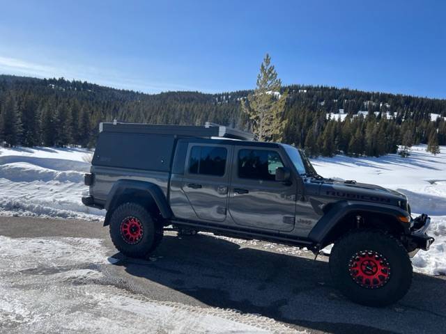

I have owned both - 4 door JL Rubicon’s
2018 JL with the 3.6 on 33’s. We put ~40k on it, my wife’s daily driver for work. Not a single problem with it. used Prices were crazy so we sold it for what I paid new and ordered a 2021 Diesel. Very impressed with the reduced engine noise on the highway and fuel economy/ range. It’s on 35’s and gets 21-22 in town and 26-28 on the highway. 65-72 mph seems to be the sweet spot for interstate driving, anything faster fuel economy get worse quickly (same for the 3.6, but only 19-21 mpg)
Passing power and pulling hills is much better with the 3.0 Diesel.
We enjoyed the wrangler enough that I sold my GMC diesel and toy hauler to build a Gladiator.
I couldn’t be happier with the diesel Rubicon!
Running 37’s with a 3.5” lift.
Fuel economy is down from the wrangler but still pretty good at 20 in town and 22-23 on the highway. It’s not as fast as the wrangler but it’s heavier and on 37’s. I’m sure it would be better with 4.56 gears, but it’s fine with the stock 3.73’s.
We’ve been to Moab twice, Colorado, southern Utah and all over Idaho camping and exploring.
Jeep Gladiator 3.6 with air intake vs. 3.0 ecodiesel IMG_5074
Jeep Gladiator 3.6 with air intake vs. 3.0 ecodiesel IMG_5054
Jeep Gladiator 3.6 with air intake vs. 3.0 ecodiesel IMG_4117
We have over 80k on the wrangler and 20k on the Gladiator with no issues whatsoever from either vehicle. Just routine oil and fuel filter changes.
