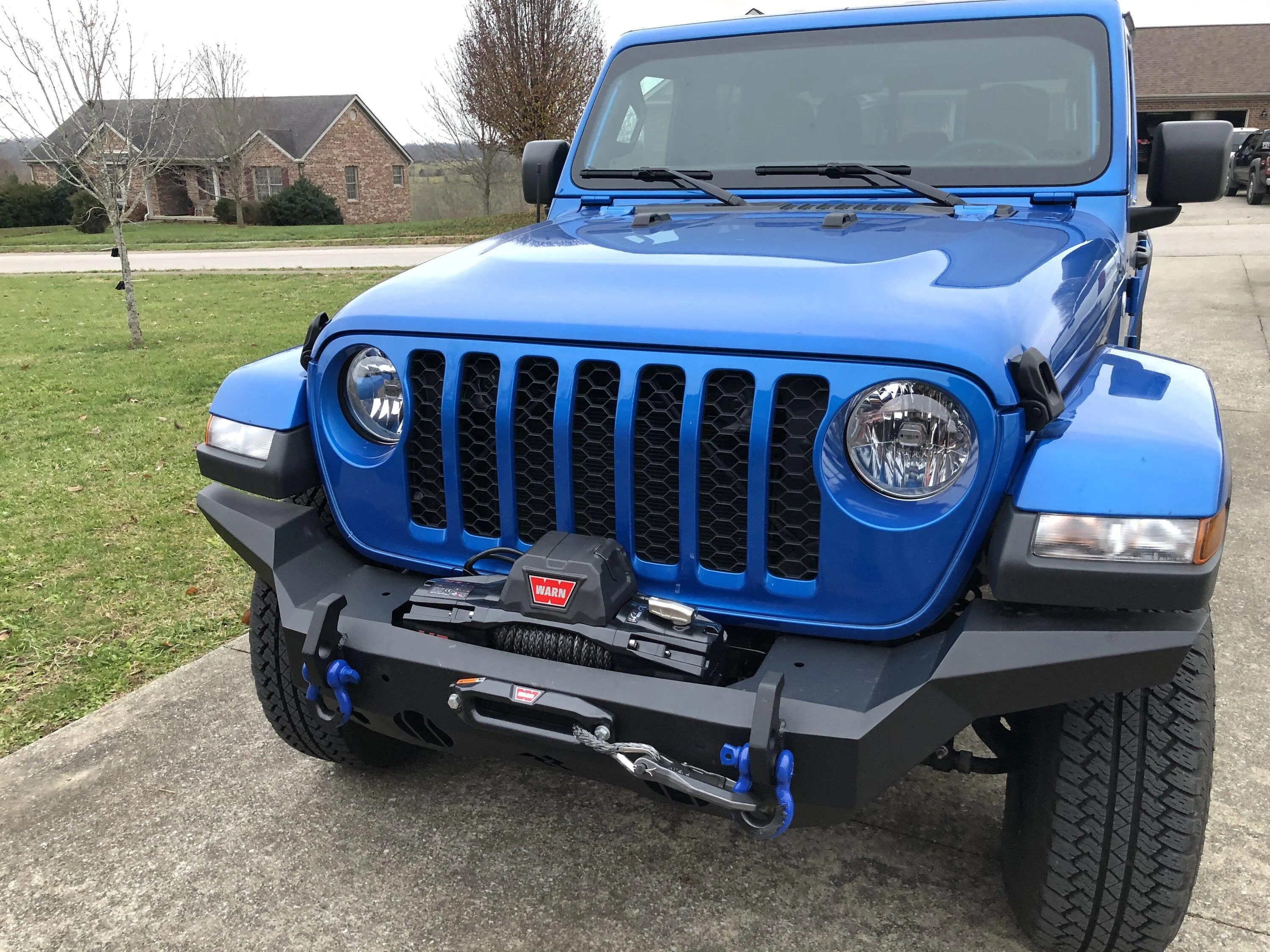

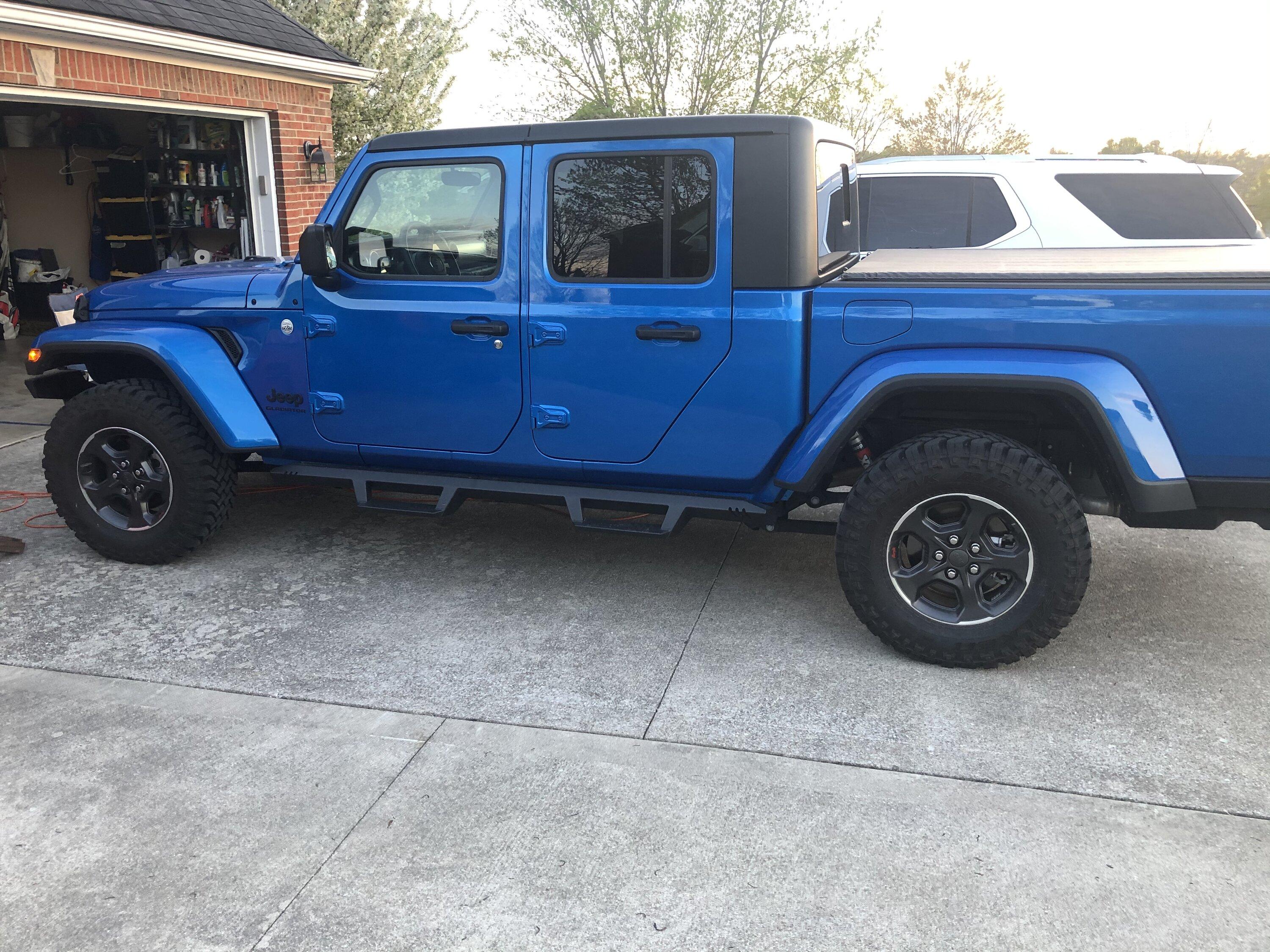

I have a 2020 Sport S, 3.73 gears, with Rubicon takeoff suspension and 33” MT. I also have a mid width bumper and winch. You can see the air gap between bumper and fender.
I average 16 mpg. I drive like an old man, and routinely see all 8 gears. But, I wasn’t happy with the throttle response.
