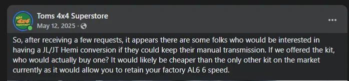

I think Tyler at Tom's is working on a manual kit.
Jeep Gladiator 392 V8 Engine Swap is In and Running!! (2023 Gladiator Mojave) 1769641528990-p2
To answer another question I believe Tom's is now offering DIY kits as well.
