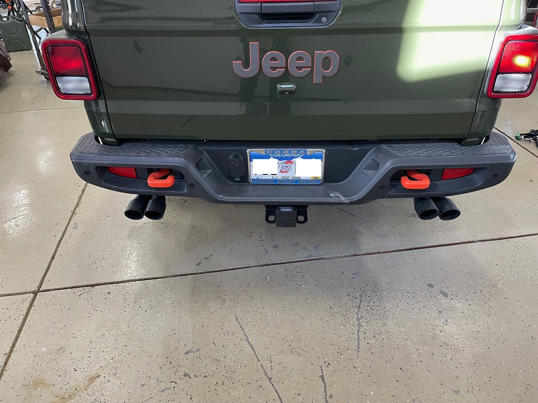

Here's a shot of the tail pipes. I left the Coastie emblem for all the Coasties out there! You know who you are!! - Tim
The double duals in black is subtle. Nice.
Also: A Coastie in Colorado?
Did you do the "getting out and walking cross country with an oar over my shoulder and stopping when someone asks what that thing is" move? :P

BourbonRunner: Funny! LOL Coast Guard sonar only makes two sounds (Too deep too deep), (Knee deep knee deep). ; )
Hey a fellow Coastie! I retired 3 years ago after 20
Jay: Yes saw that in your profile! Thanks for your service!! I was in from 86’ to 90’. I did get to pickup a new ship USCGC Forward (911) one of the 270’. So I’m a plank owner at least!! Tim
