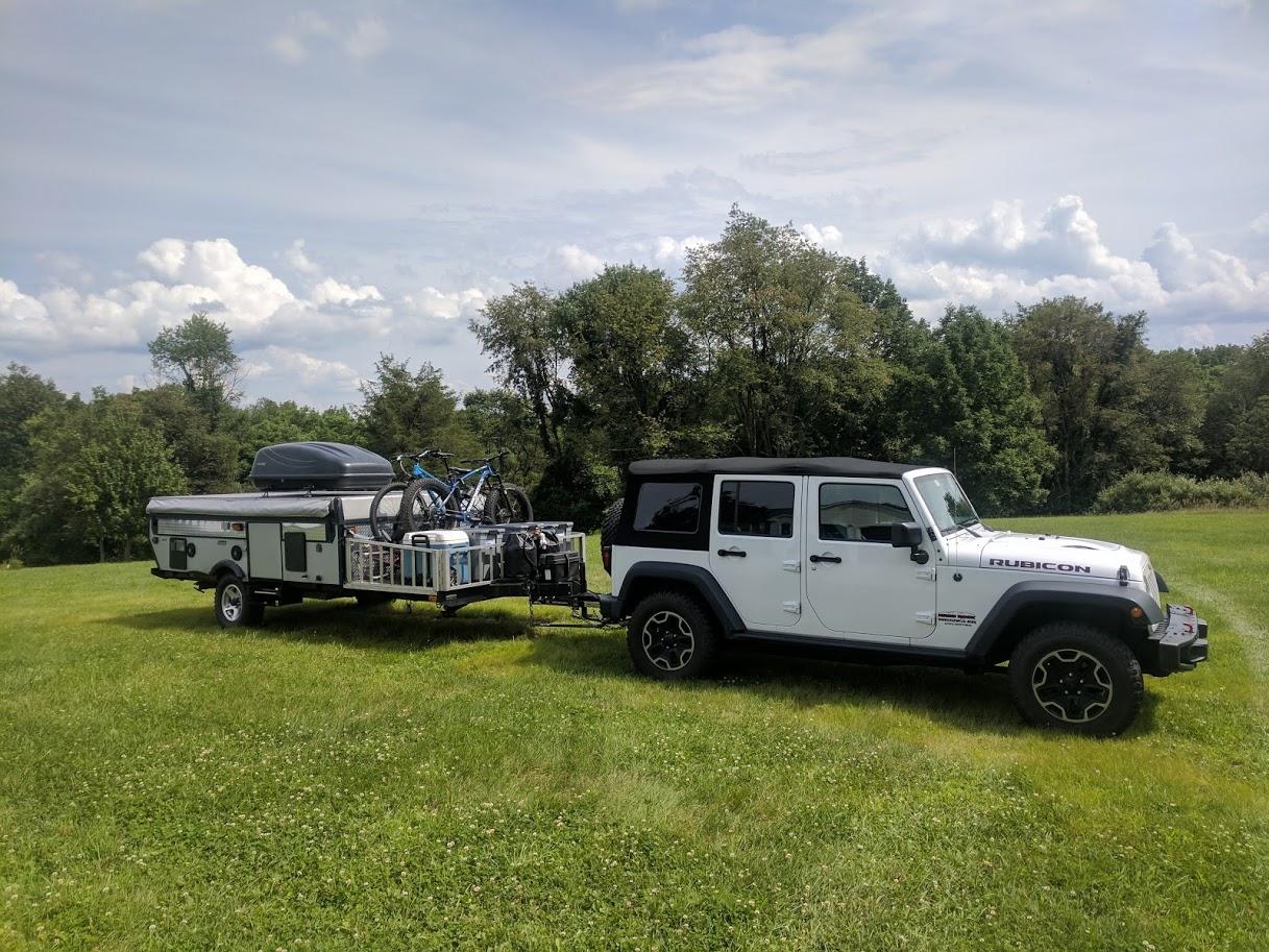

This is somewhat disappointing to me, but I think I'll be able to survive. The primary reason I was excited for the truck was a safer towing experience pulling my Coleman Evolution 3 camper trailer. Right now I yank it with my JKUR Manual. I use a brake controller and have air bags in the rear. I'm confident the trailer load is ~3500 and probably more like 4k pounds. The JKUR survives, but I wouldn't say it is a confident or relaxing experience. I do LOVE driving manual transmissions. So since the announcement of the JT I've been salivating over a significantly increased tow rating. 7k for the Rubicon really got me excited. Now to see 4500 I'm a bit more disappointed, but I still think I might go for the manual. My thinking is this: I haven't killed the JKUR manual yet. 90%+ of my miles are driving around without the trailer and I LOVE the manual experience. That 10% of the time with the trailer should still be vastly improved over my current setup thanks to the longer wheelbase and more trailer-oriented rear suspension design. I think I'll get the benefits I am looking for, even if I don't have potential to significantly increase my trailer load in the future.

I am in exactly the same boat. I pull an Evolution E3. It’s modified with dual 6 V batteries and a receiver hitch with bike rack on the back. Loaded and full of water I come in at 4600 pounds. I really really want a manual. I am currently pulling with a Chevy Colorado V8 and airbags on the rear springs. I know I’m going to take a hit on pulling capability with a manual/pentastar Gladiator. Utah has some pretty substantial mountains. The decision is largely emotional. I hope I’m not making a mistake.

I try not to think about my E3 too much behind the Wrangler. It gets the job done with weight distribution and antisway, and obviously a brake controller. I'm planning a MANUAL Gladiator. If the suspension and brakes can handle 6k lbs with an auto, I'm sure from a SAFETY standpoint you'll be fine at 4600lbs. No one but the Jeep engineers knows just what the weak link was, but it must be after the engine and before the transfer case. Pretty much either the clutch or the trans itself.

I see in your picture that you are using a weight distribution hitch. Sitting pretty level. Which hitch are you using? Are you happy with it?
I honestly don't remember the brand. It was included from the previous owner when I bought the trailer. It's just one of the typical onces that uses the chains to the bars. The anti-sway is the generic brake pad style from etrailer. I also put air bags in the rear coils. It rides very level.
