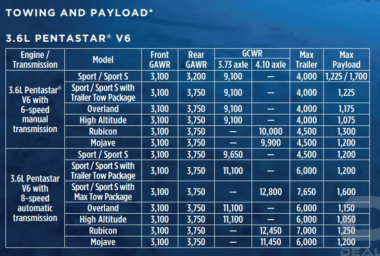

If your JT has a manual, it doesn't have "max tow". Only automatics have that - here's the latest chart from a 2021 order guide right off the mopar site - and it mentions 80th anniversary being on the Sport S level - and Sport S can't have max tow on manual transmission.
Check the window sticker or build sheet - nothing else counts.
Note by the 6 speed manual transmission area only "Trailer Tow Package" is available.
By the 8 speed automatic section - that's where Trailer tow package and max tow are listed.

The trailer tow package reduces that payload - based on Jeep's chart.
That 1700 is for Sport S, no tow package.
With tow package, Sport and Sport S are 1225

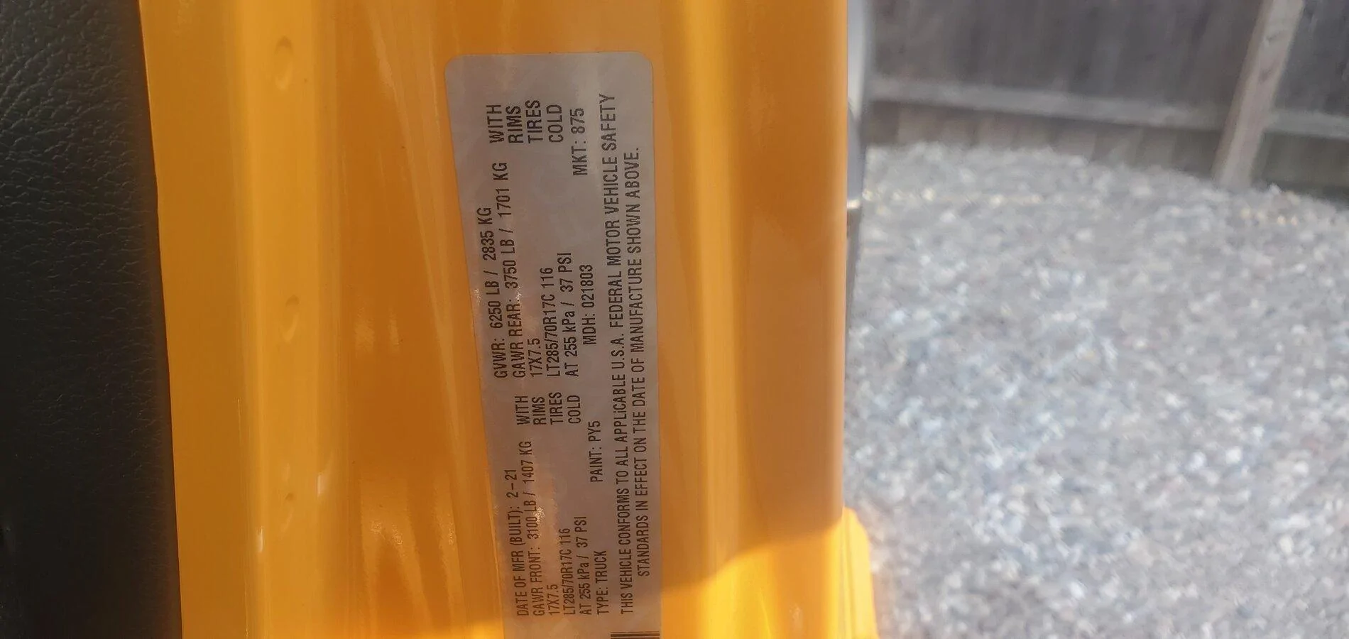

Oh - I know it. I have the MT and 4.10 rear, but no max tow! Speculation will disappear when the sheets are posted! And maybe a pic of the door jamb sticker...
Only thing is towing capacity is not on the door jamb. Just axle capacity and GVWR.
Jeep Gladiator Why no max tow with the manual transmission? 16282024975043114232139793226162

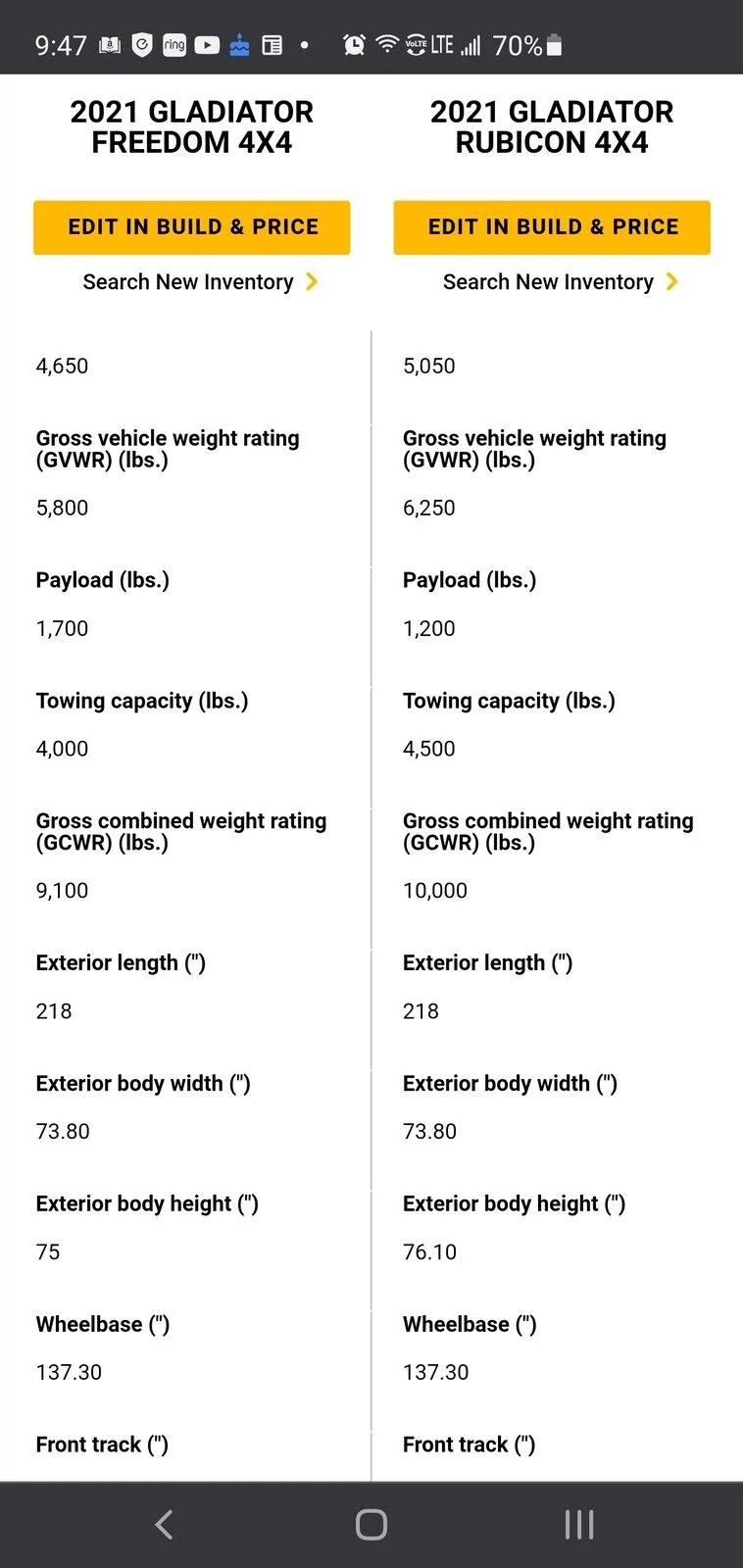

I just built a freedom on jeep.com with tow package, and it said 1700. Strange. If jeep doesn't know, where are we supposed to get out info from! One of their charts is wrong. Could have changed for '21 though, because my manual says my max payload is 1200, but I think '20s got 1300 lbs.
Jeep Gladiator Why no max tow with the manual transmission? Screenshot_20210824-214719_Chrom
