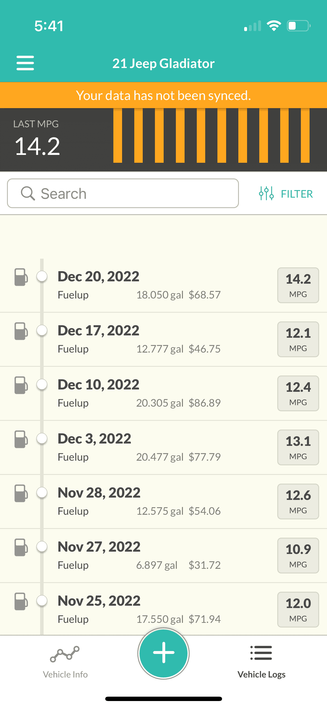

Trending positive…the attached pic shows my recent fill ups. My lifetime average is 13 mpg.
I only had one fill up since regearing. I admit it could be a bit skewed by slower overall speeds during break in but I also had a lot of idle time due to heavy snow/ice and extremely low overall temps which hurts it.
What app is this?
