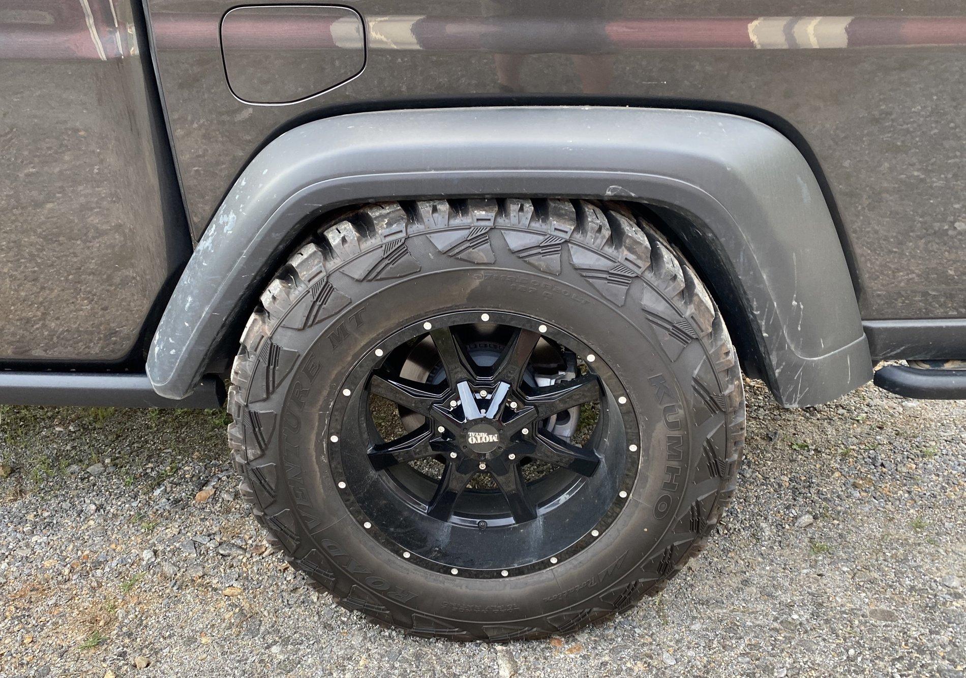

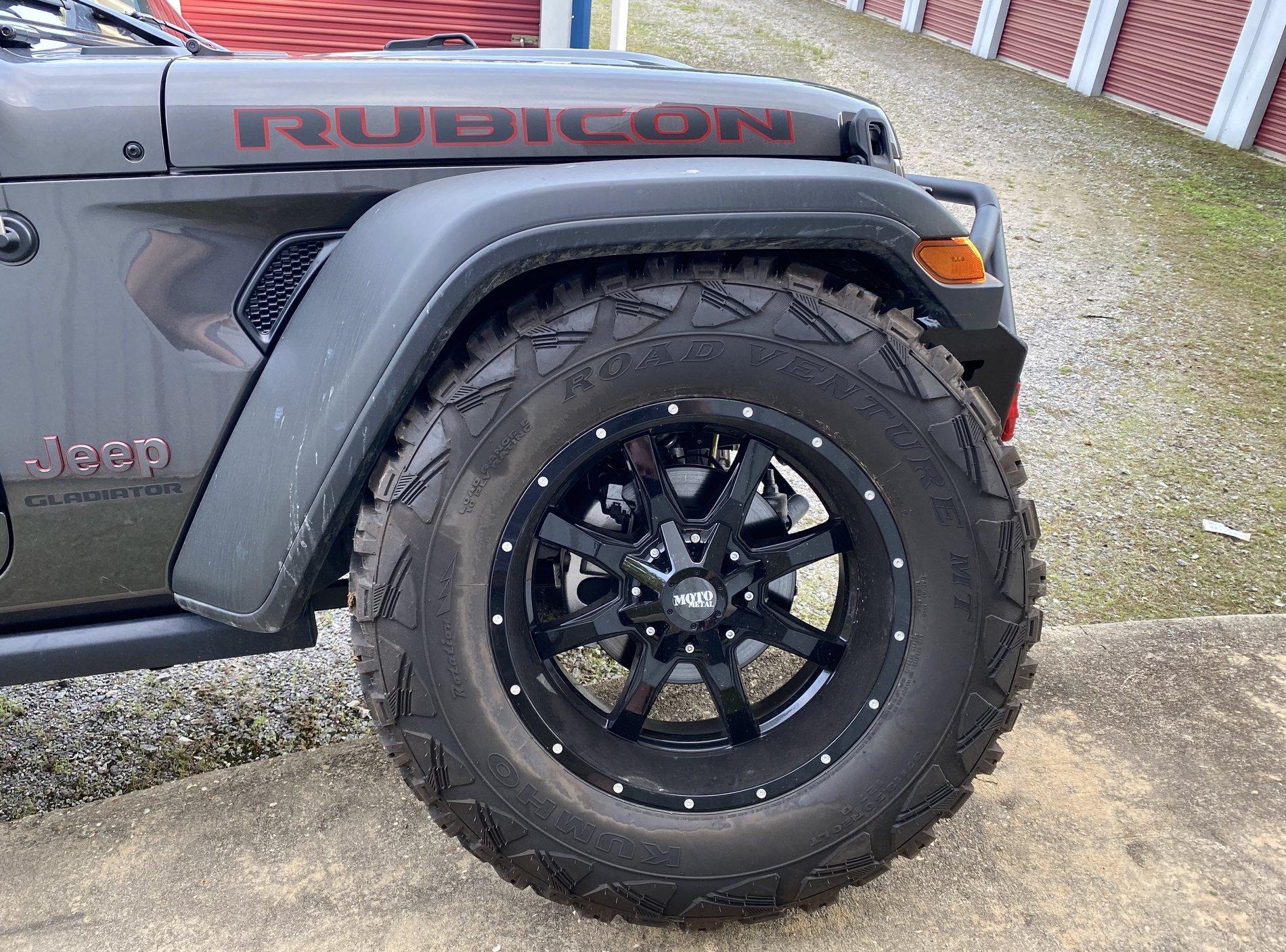

Cost may be a factor, but trust me, he's not wrong... I've made that mistake in the past on other vehicles. I learned to ALWAYS stuff as much tire as you can safely clear and still have room to flex. That's why I'm stuffing 37's with a 2.5" lift on my JTR.
These are at full-flex with the current 2.5 spacer lift setup. I should get plenty more with the Evo Enforcer 2.5" Stage 2 Plus lift that i'm fixing to put on there. Already got the lift, just waiting on the time...
Oh man... That doesn't look too bad. And I'm sure with 3 1/2" there should be a little more clearance, but I have a sport, so my fenders could possibly take a beating. I haven't ordered anything yet, but maybe I'll look at going with 37's anyway.
Thanks for taking the time to send me the pictures.
