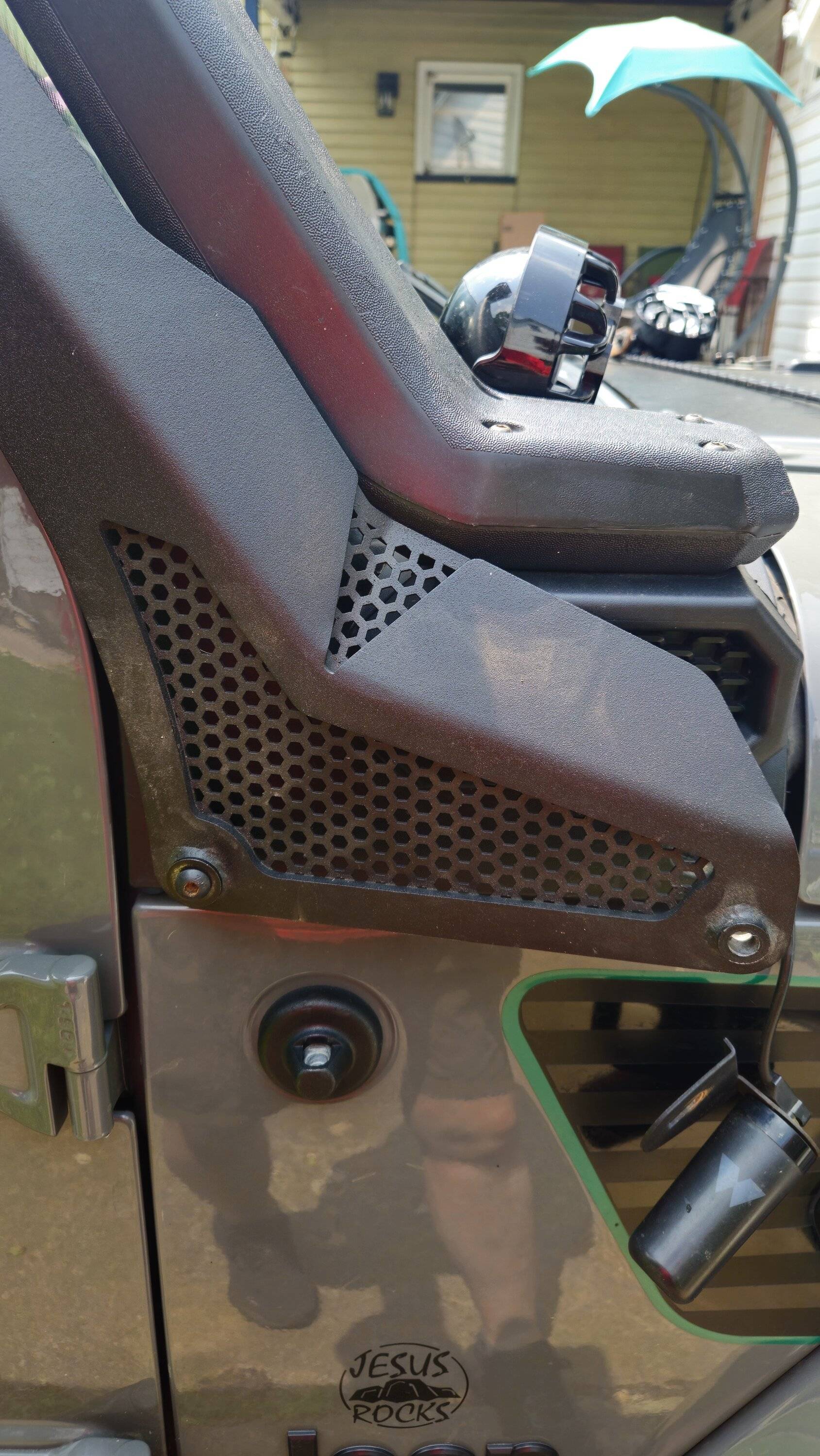

The GoRhino light bar brackets sits away from the frame. It minimizes how much paint damage you get and I was hoping would give me more clearance for the snorkel.
Turns out it's not enough.
Jeep Gladiator So I'm doing a thing....with a snorkel 20250607_120801
Jeep Gladiator So I'm doing a thing....with a snorkel 20250607_120755
But I've spent the money so....
Out came the heat gun!
Jeep Gladiator So I'm doing a thing....with a snorkel 20250607_122509
I got the cowl section to give way and make room for the bracket. I need to go back and play a little more to make it a little prettier but it works, and I can still remove the snorkel tube if I need to.

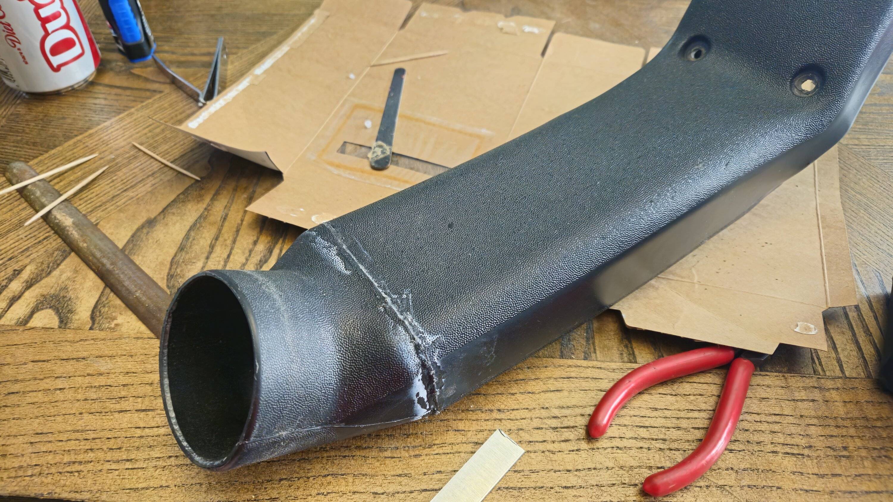

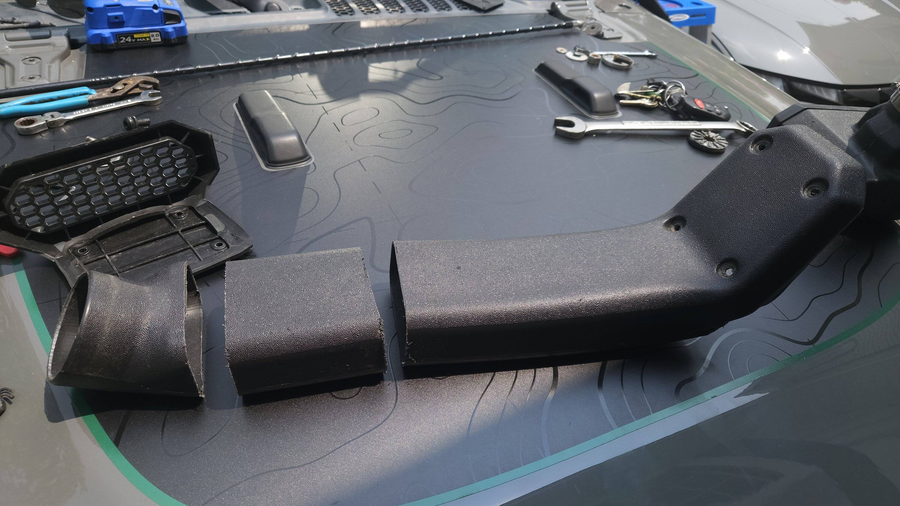

Next was to deal with the height of the snorkel. It was simply too tall and interfered with the light bar. So it needed to get a little shorter.
Jeep Gladiator So I'm doing a thing....with a snorkel 20250607_135012
Thankfully the tube doesn't neck down, so cutting out the central section and gluing the pieces together worked well. I need to go back and melt some metal screening or something to ensure the pieces stay together.

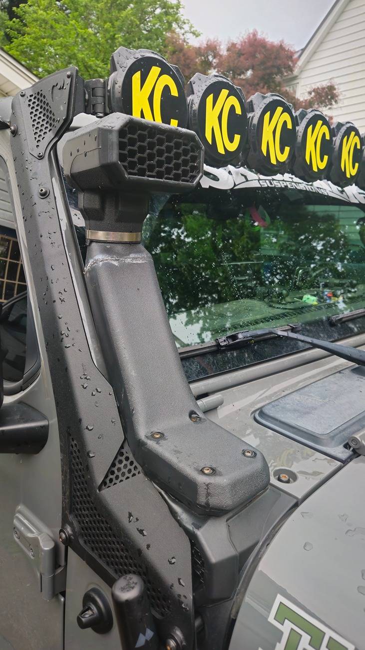

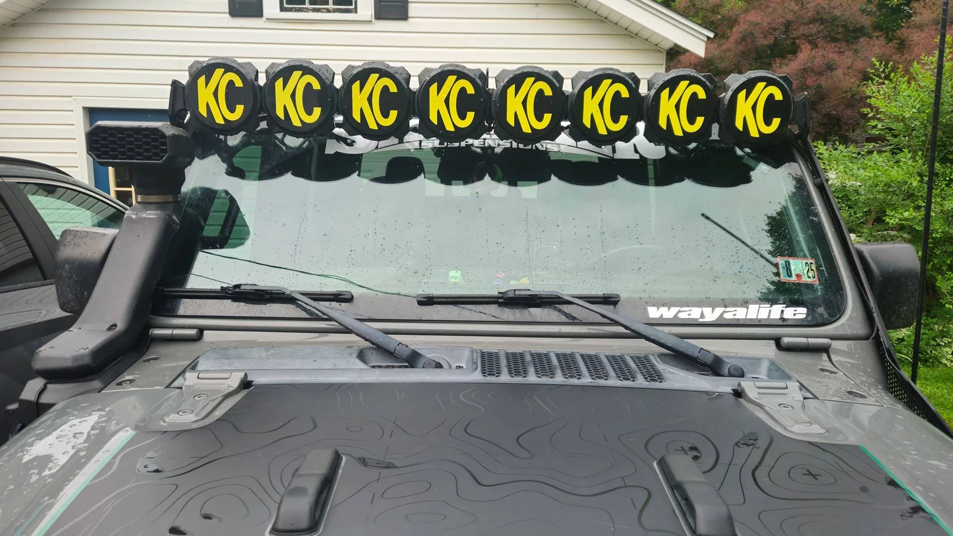

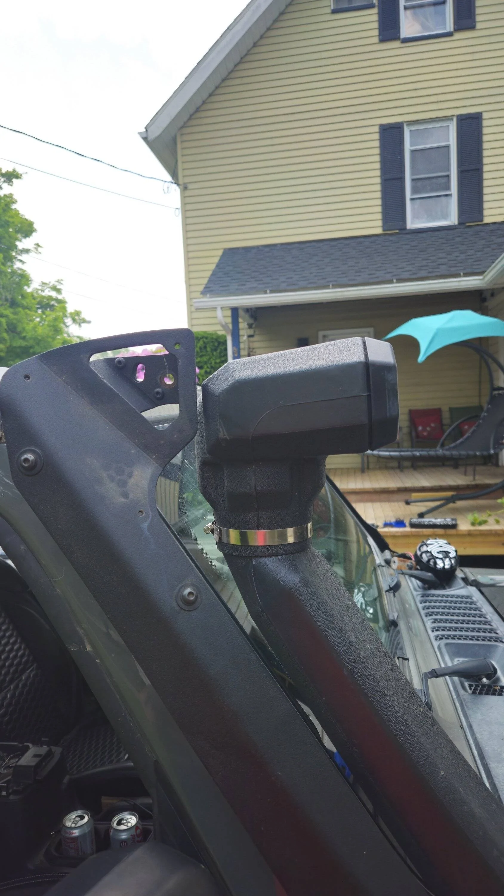

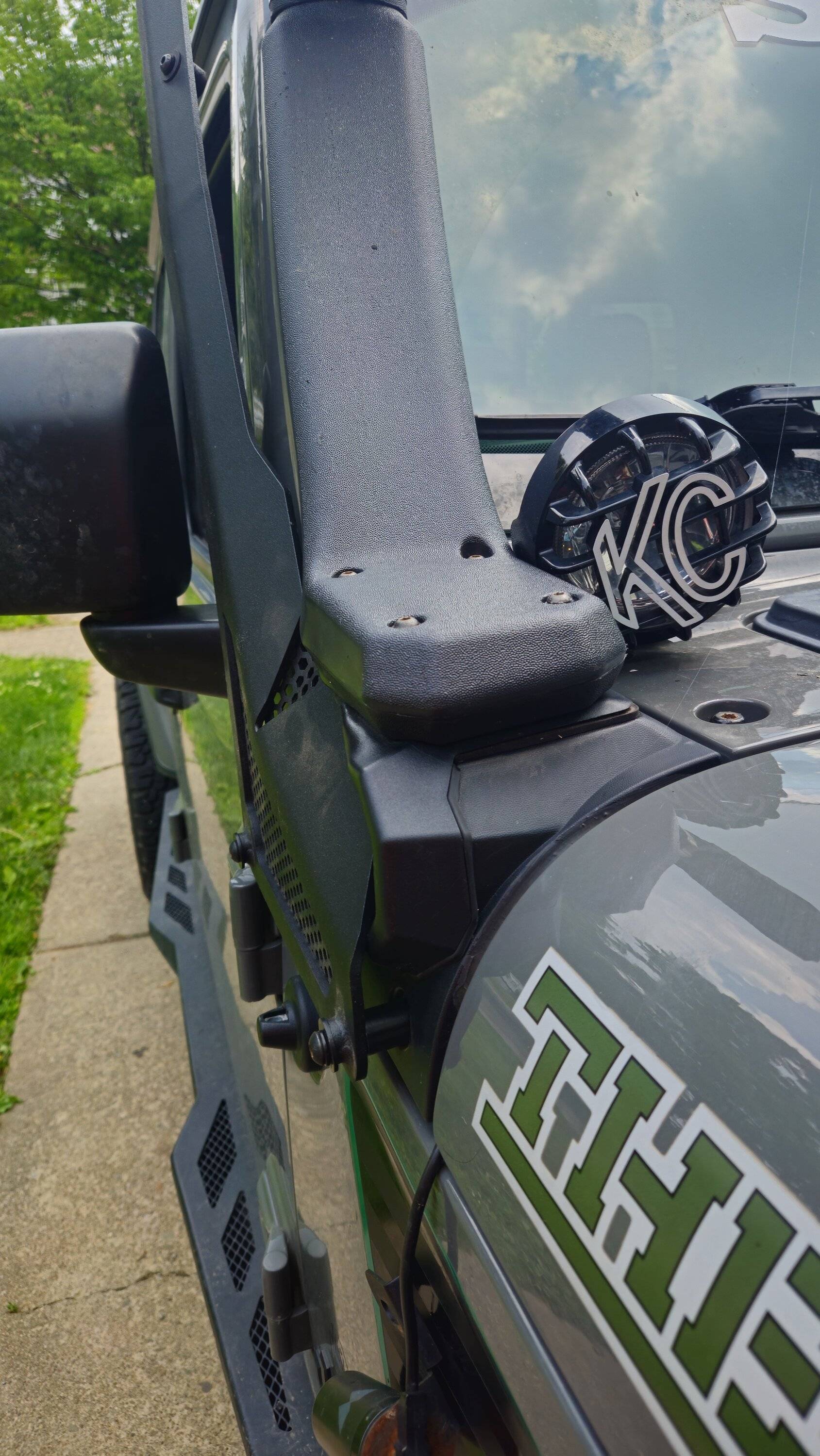

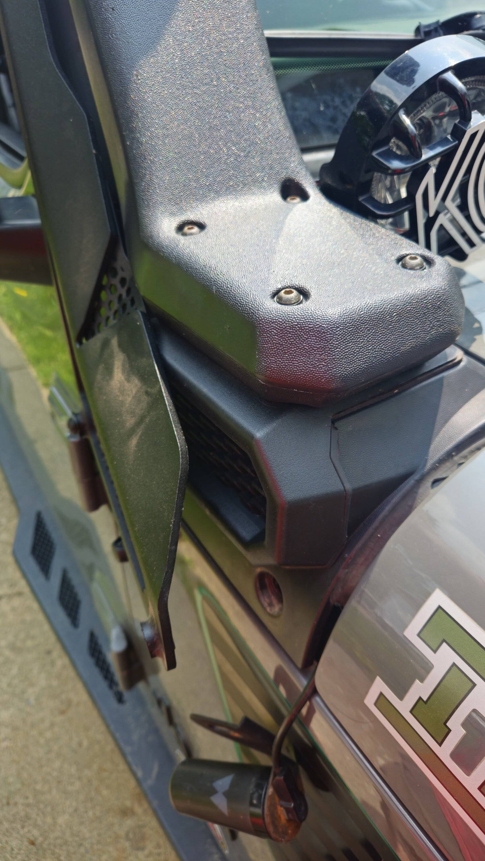

Here's the results
Jeep Gladiator So I'm doing a thing....with a snorkel 20250608_203513
Jeep Gladiator So I'm doing a thing....with a snorkel 20250608_203525
Now, I've just got to pull the snorkel off again and paint to cover up the seams and the ugly discoloration the super glue left behind

I’m not a light bar or even a light guy but it looks great! Snorkel is still high enough, nice job….Jack
40,501
54,021
Like that snorkel a lot better than cutting a hood. And it all fits nicely.
Sort of an old-school look I like.
