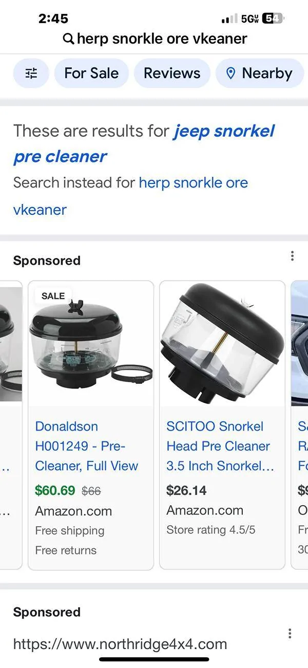

I wonder what the round pre-cleaner type snorkel top would look like , might be a cleaner look? There are a few different styles out there, might be smaller and a neat idea to catch the big dirt before sending it to air cleaner….Jack

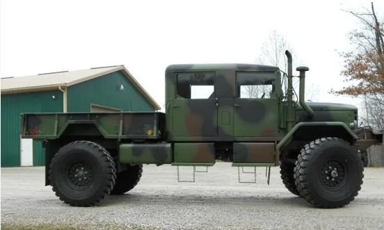

I don't hate that. Very Deuce and a half. The Gladiator does look like a mini bobbed Deuce.

Agree. But is highly doubtful that any of those prefilter tops would clear the windshield in the back or the lights. Too bulky.
For the deuce n a half look....now something like this should clear.
(and before you say "I don't hate it"....know that you really should ;) )
(and ya I know this is for exhaust - just wire it open)

LMAO, my only regret in buying this was not waiting for a Diesel. And If I had gotten that diesel I'd be going to great lengths to make it look like a mini deuce. CARC paint and all!
