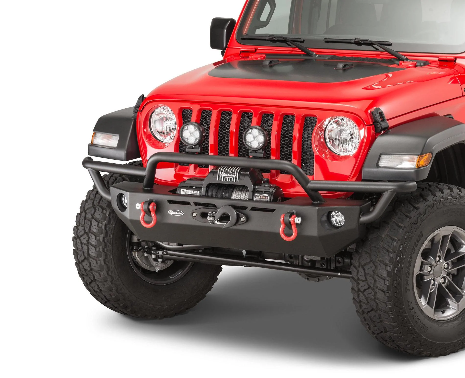

Fab Fours certainly isn’t my favorite design, but Quadratec has their front stubby bumper for $379. Then they have a $200 rebate, so it’s really $179 with free shipping. Still a little too high, too, but an option.
https://www.quadratec.com/special_offers/fab-fours-jeep-parts-200-rebate
It looks like the Quadratec Stealth winch sits a bit lower in the Quadratec steel front bumper:
https://www.quadratec.com/p/quadratec/qrc-front-winch-ready-bumper-jeep-wrangler-jl-gladiator-jt/full-width-12000-lb-synthetic

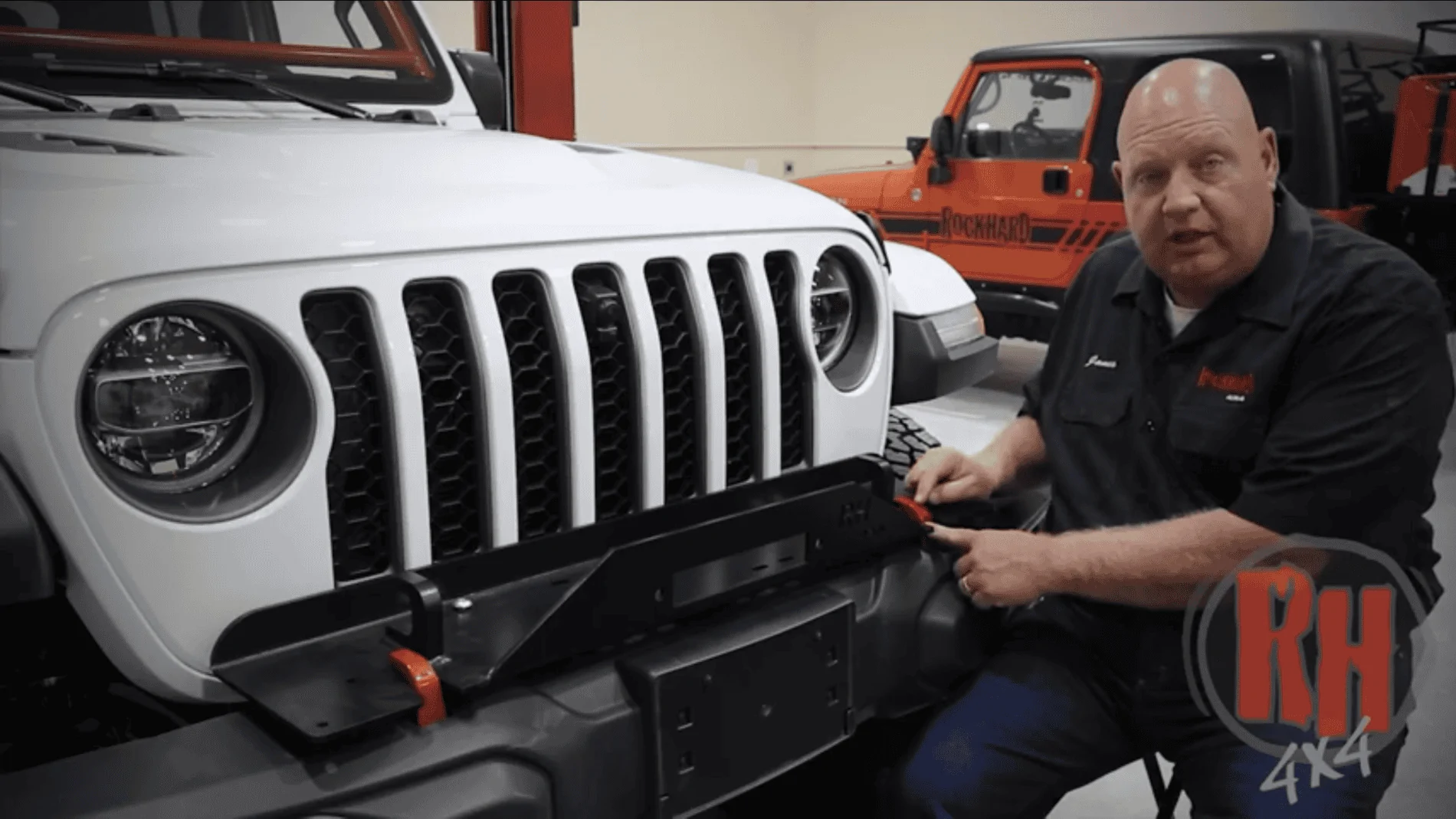

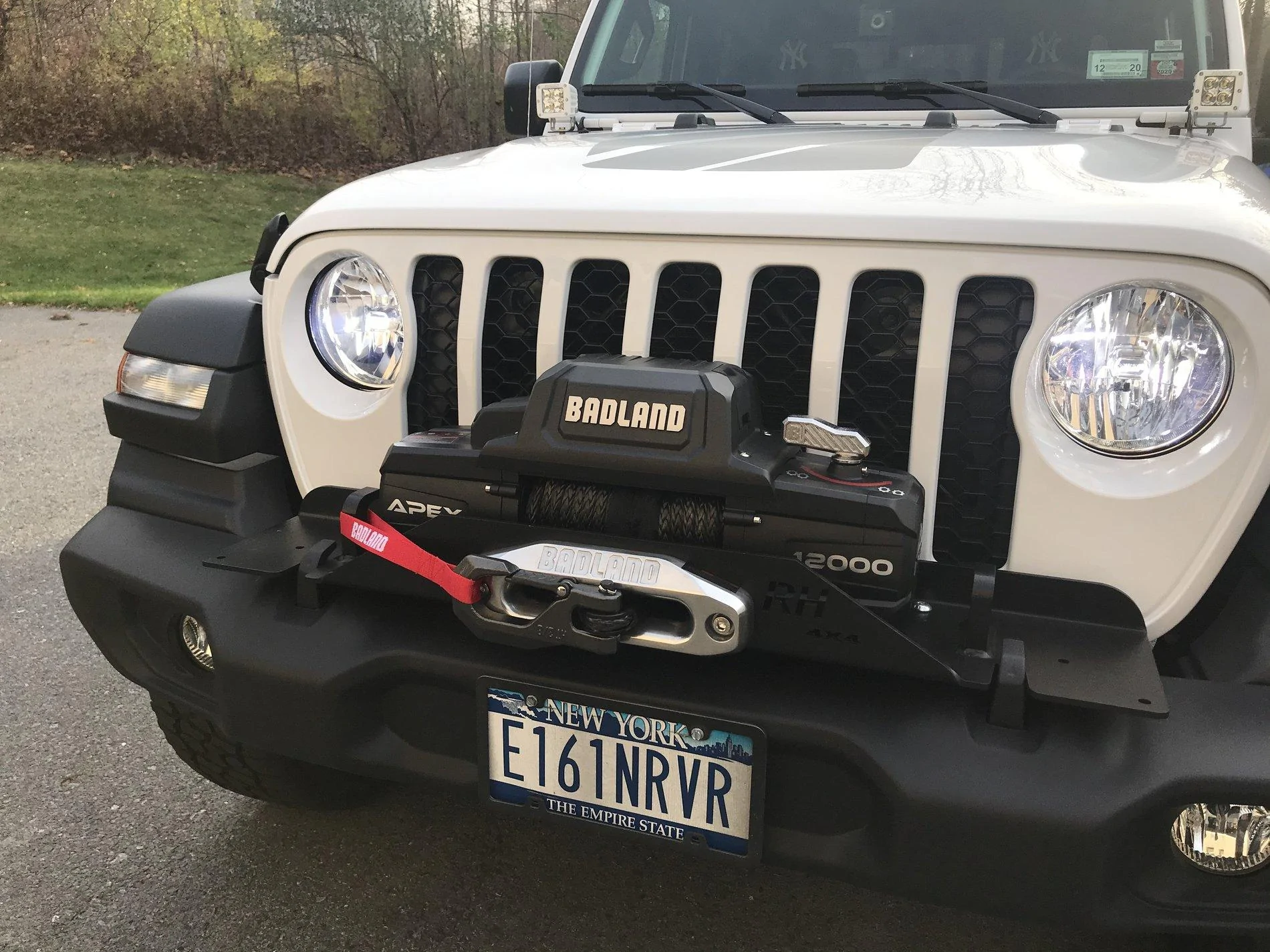

If you do it right the winch plate is the only thing under any amount of stress. I pulled many of trees out of the woods with my JK setup.
Wait... explain this? I thought the winch plate was on the flow hooks somehow and they were adding support?
alM
Al
Oct 13, 2019
NY
2020 Jeep Gladiator Sport

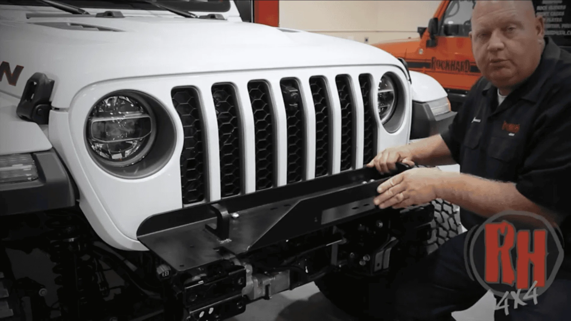

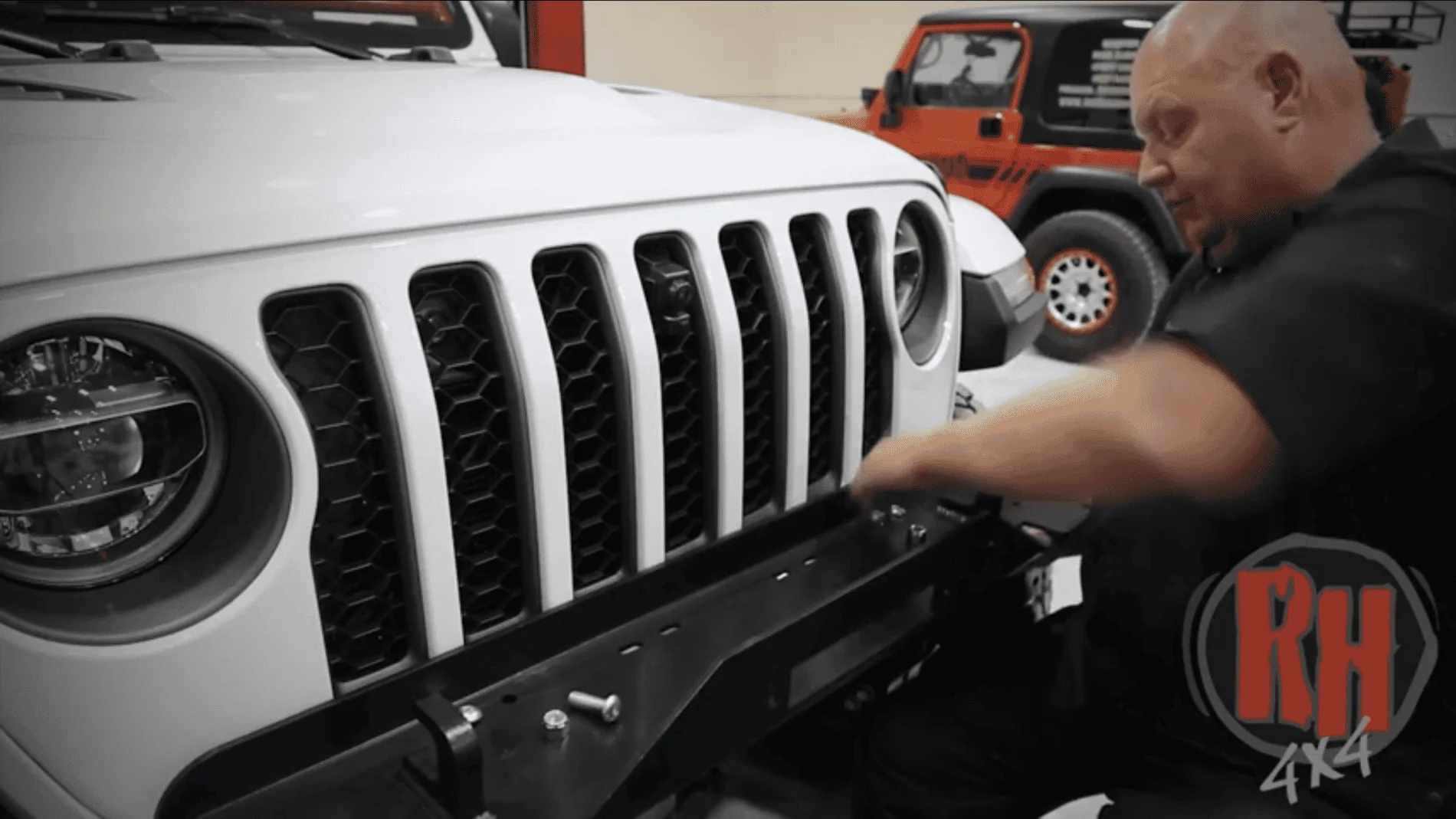

Are you sure it's supposed to be on top of the plastic bumper? Looks like big gap between it and frame

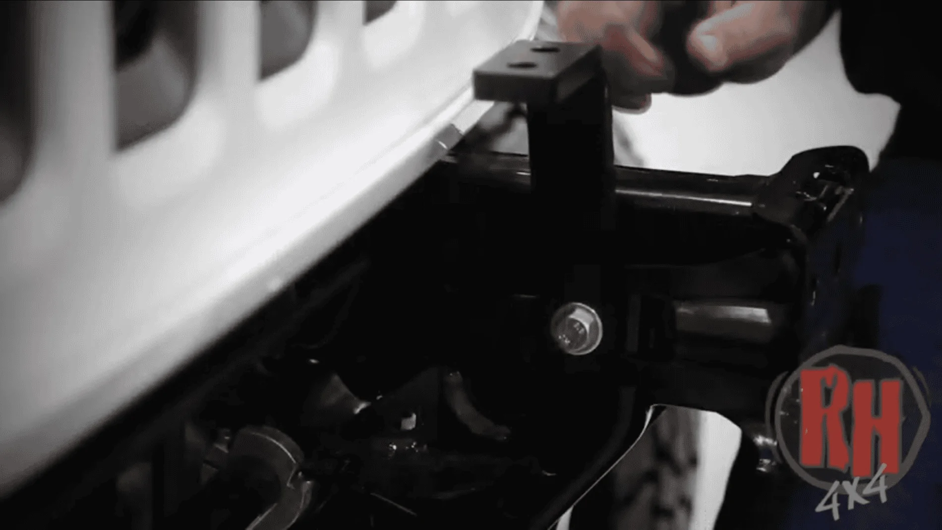

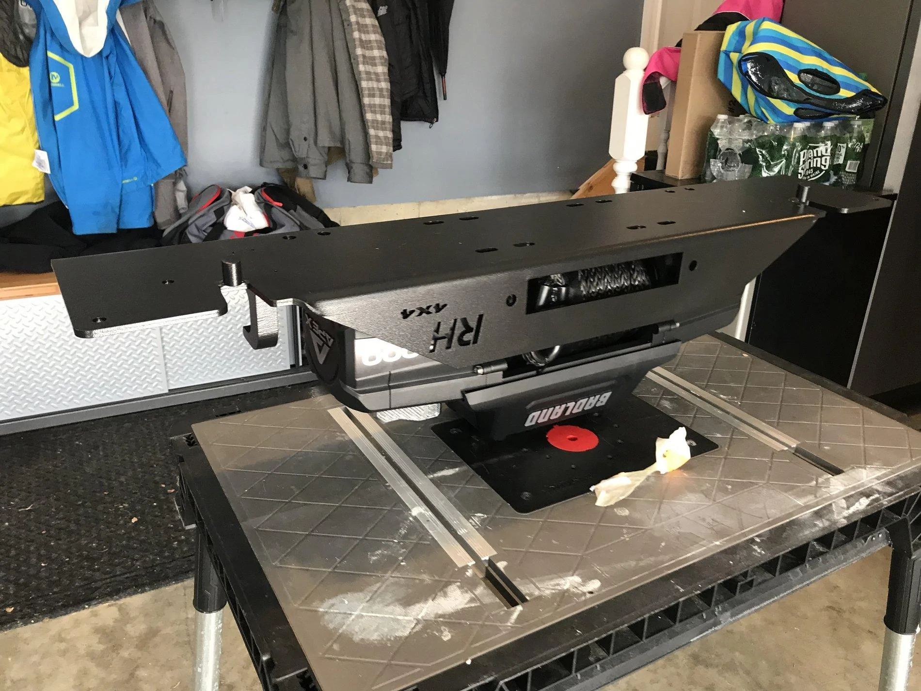

it actually is engaged with the tow hooks and support by the two post below and attached to the frame by mounts at the rear of the plate. If you watch ROCkHARD 4x4 video on installation you will get an idea of how it is engaged with not the bumper but the actual frame. It does not really even touch the bumper. It is supported above it by a very small amount. It’s marriage to the tow hooks is where it derives it’s strength and is engaged with the frame.

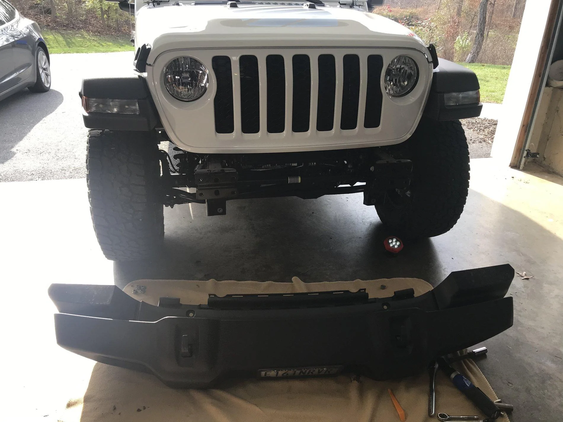

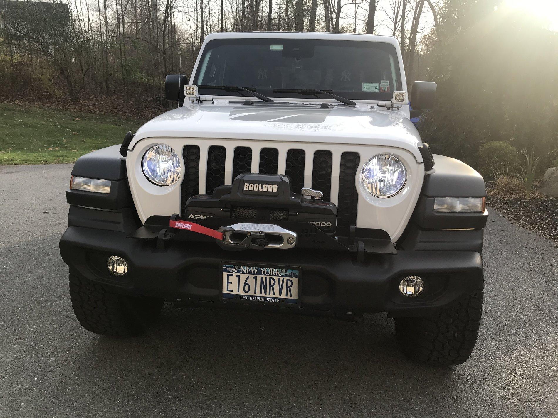

I have admittedly taken this companies word that their design was worked out and tested. Just as anyone takes their winch plate companies word.
The plate has absolutely no play and is locked in place behind the tow hooks with two contact points right beneath the area it meets the tow hook is a steel post that supports it on the curve of the hook that is out of site below the bumper. You can see these post in my photo with the plate and winch upside down on my work table.

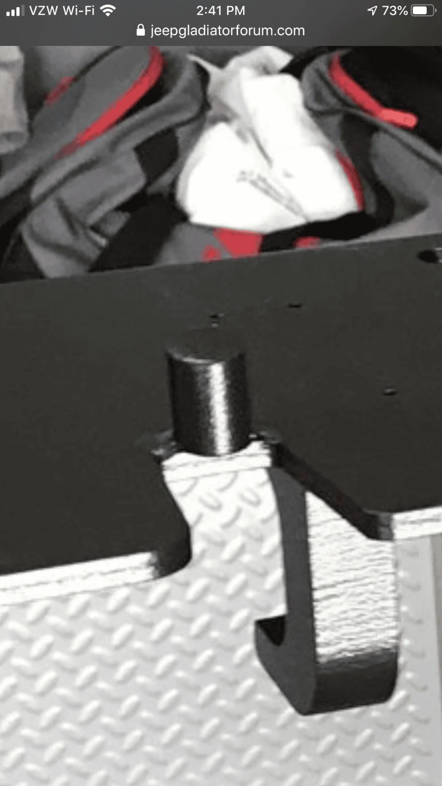

Here is a close up

I realize in reality the tow hooks are attached to the bumper which is attached to the frame by the 8 bolts which attach the bumper.
This may be viewed by some as not sufficient. But if the tow hooks are rated for the vehicle and could be attached otherwise to recover then why not in this circumstance.
I am not saying this my forever solution and may next spring upgrade the bumper and allow for lower winch placement.
I am just waiting for the firestorm here.
