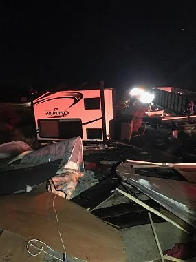

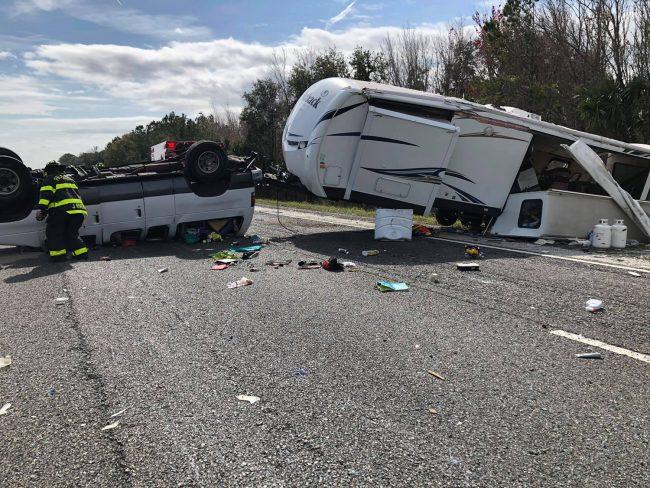

The general rule most people try to follow is all gear, people, dogs, full tanks of water and propane, full fridge, ..... Yeah EVERYTHING. The total should be about 80% of the trucks maximum.
Remember Its not just if you can tow it.... its if you can control and most importantly stop it.
This link is about someone else deciding on the 80% rule
https://www.irv2.com/forums/f45/80-512294.html#post5494283
Now for the ones that didn't follow the rules.....
Heres a link to a post in a forum where it a trailer crashed when pulled by an F-150
https://www.irv2.com/forums/f59/buddy-lost-his-tt-but-is-ok-509377.html
Heres another.....
https://www.irv2.com/forums/f45/overloaded-too-much-speed-or-just-bad-luck-429374.html
This is an Explorer pulling a trailer WAY to big.
https://www.irv2.com/forums/f50/dont-be-this-guy-493226.html
Not trying to scare you but its better to buy a little smaller and be safer, or buy the trailer you want and then buy a truck that is more than capable for the trailer you picked.
Hope this info is helpful in making your decision.
