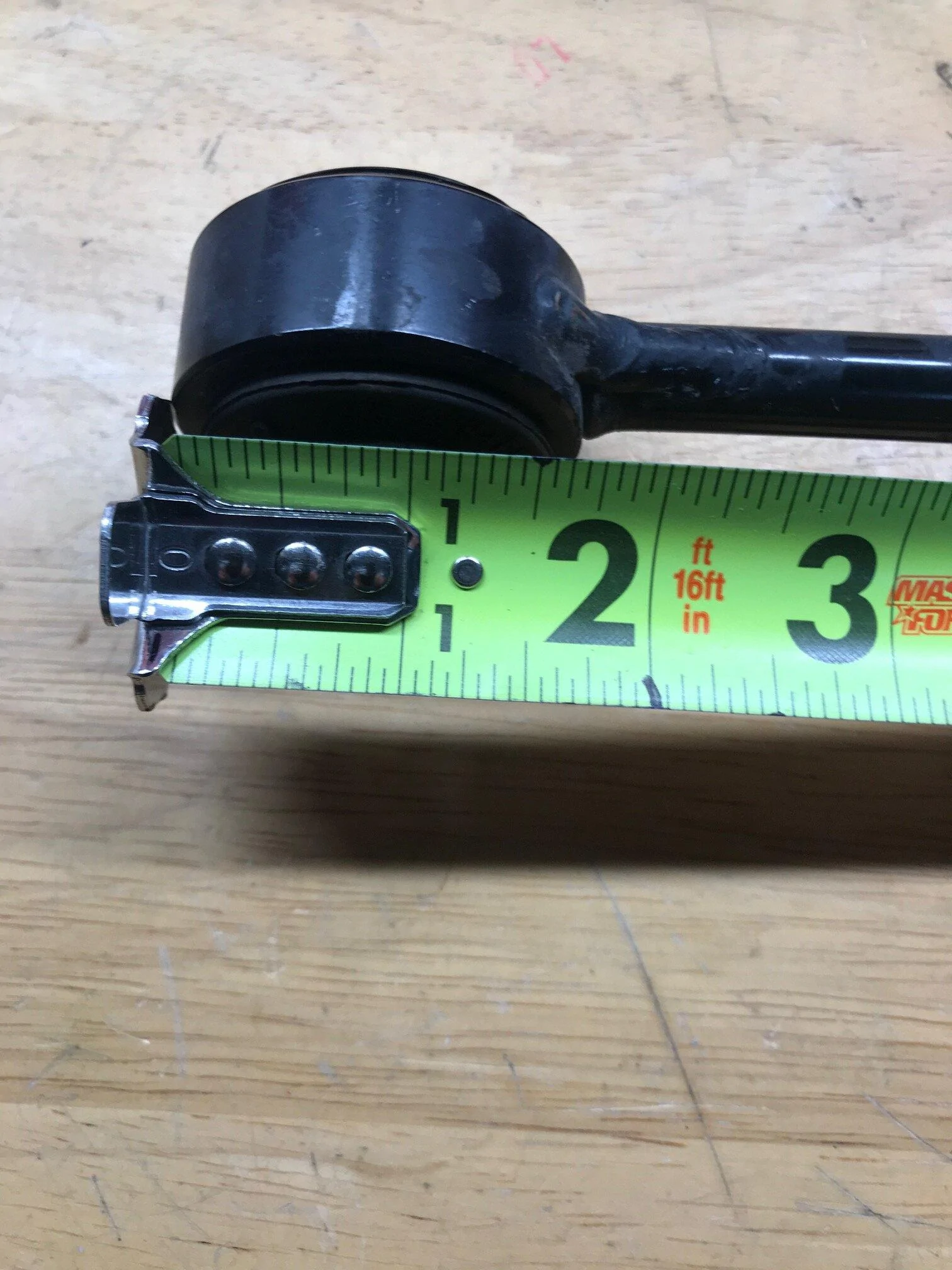

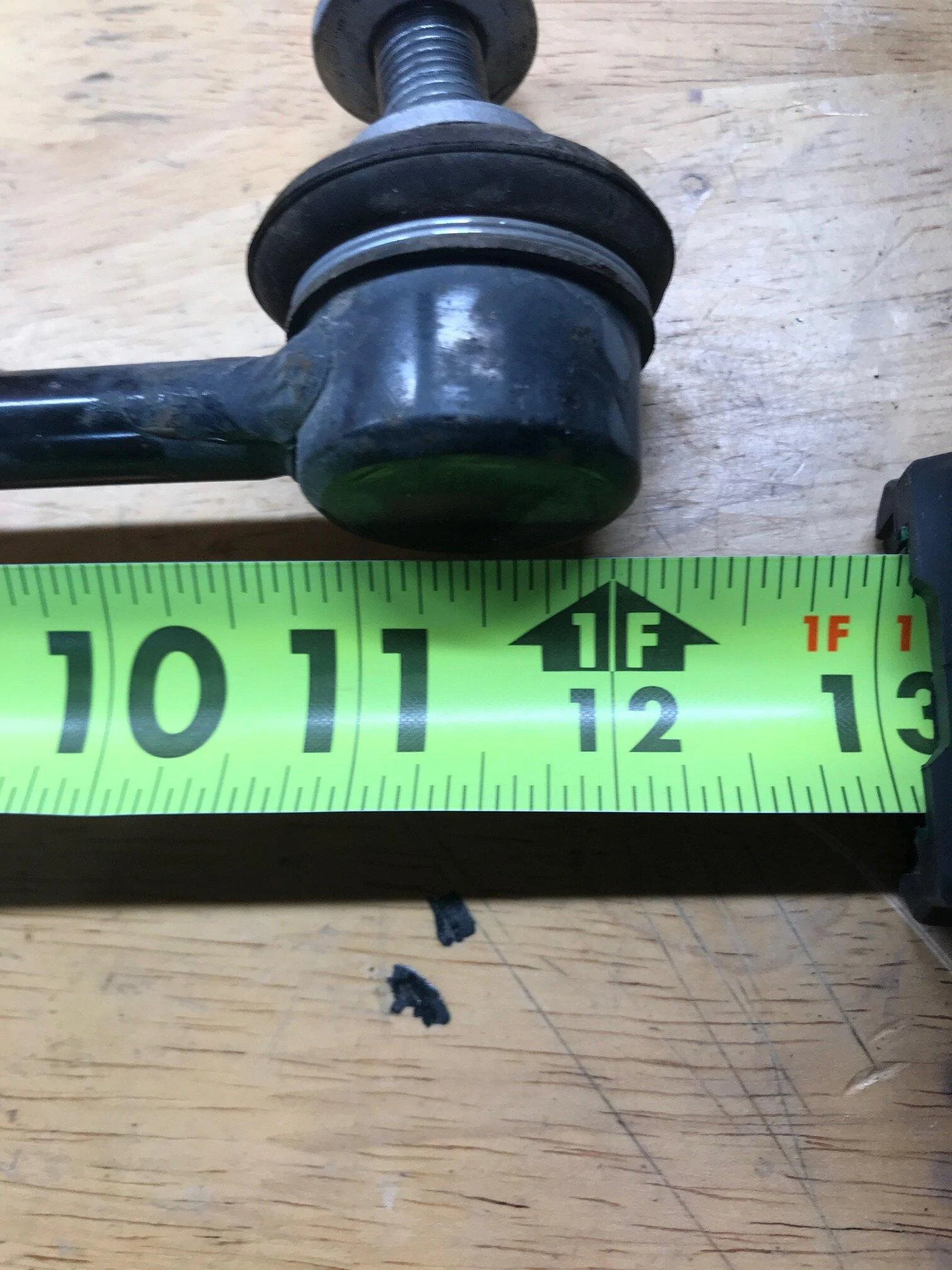

Does anyone here still have their stock sway bar end links? Could I get a measurement center to center?
I purchased my truck used with the AEV lift already installed, or at least part of it installed.
What I can't tell is if I have the AEV links or not.
I don't see a Mopar number on them, so I'm hoping they put the AEV ones on.
They didn't do geometry brackets or the drive line spacer, but I've done them since.

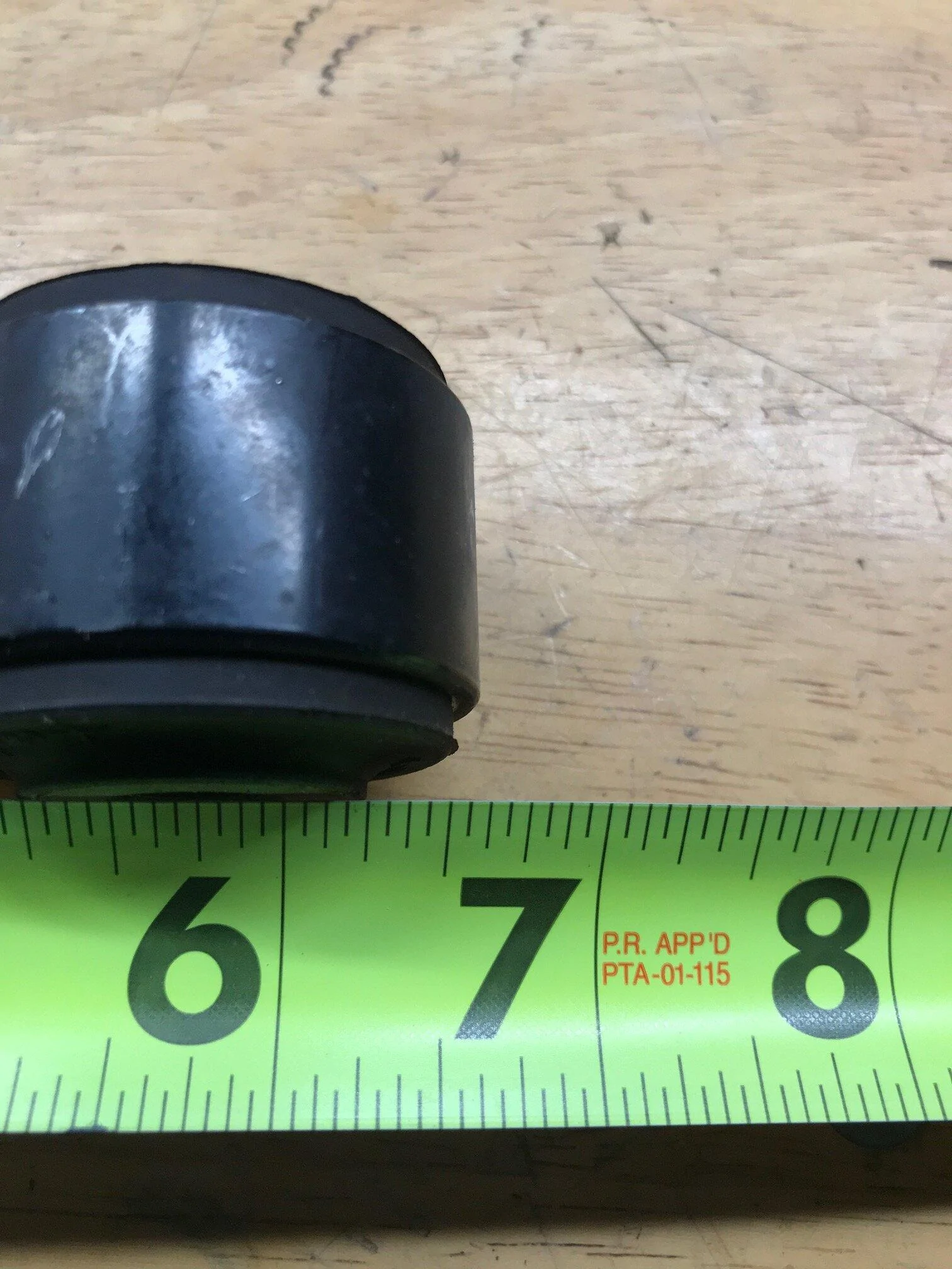

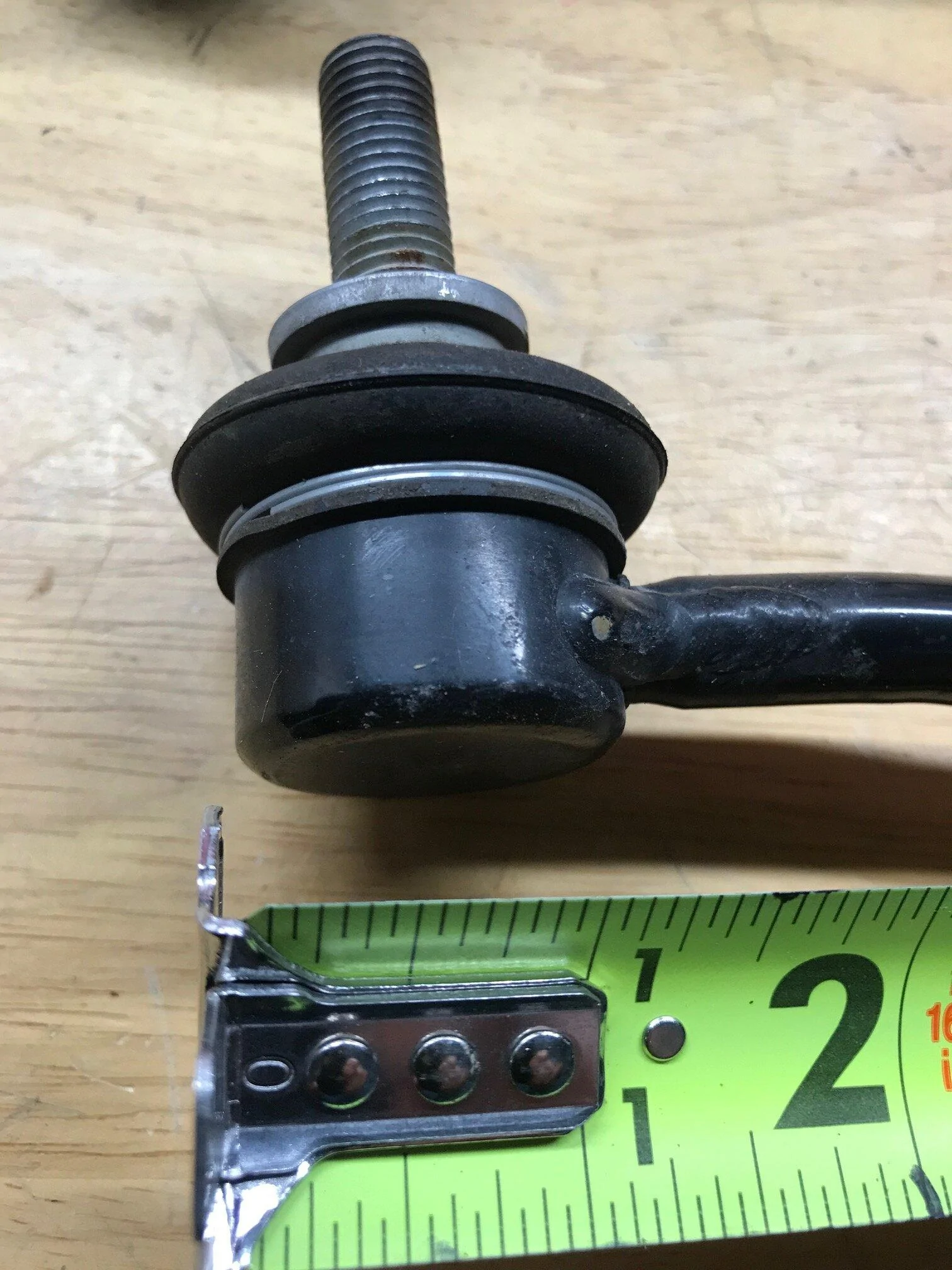

I kept the old ones. The rears are about 12" and the front ones are 6 - 9/16" as measured by my photos:
Jeep Gladiator AEV 2" spacer lift for Mojave Gladiator IMG_2857
Jeep Gladiator AEV 2" spacer lift for Mojave Gladiator IMG_2858
Jeep Gladiator AEV 2" spacer lift for Mojave Gladiator IMG_2859
Jeep Gladiator AEV 2" spacer lift for Mojave Gladiator IMG_2860
Not2Late
Tarik
Jul 2, 2022
223
394
kansas
2021 Jeep Gladiator Mojave, 2017 Jeep JK
Education

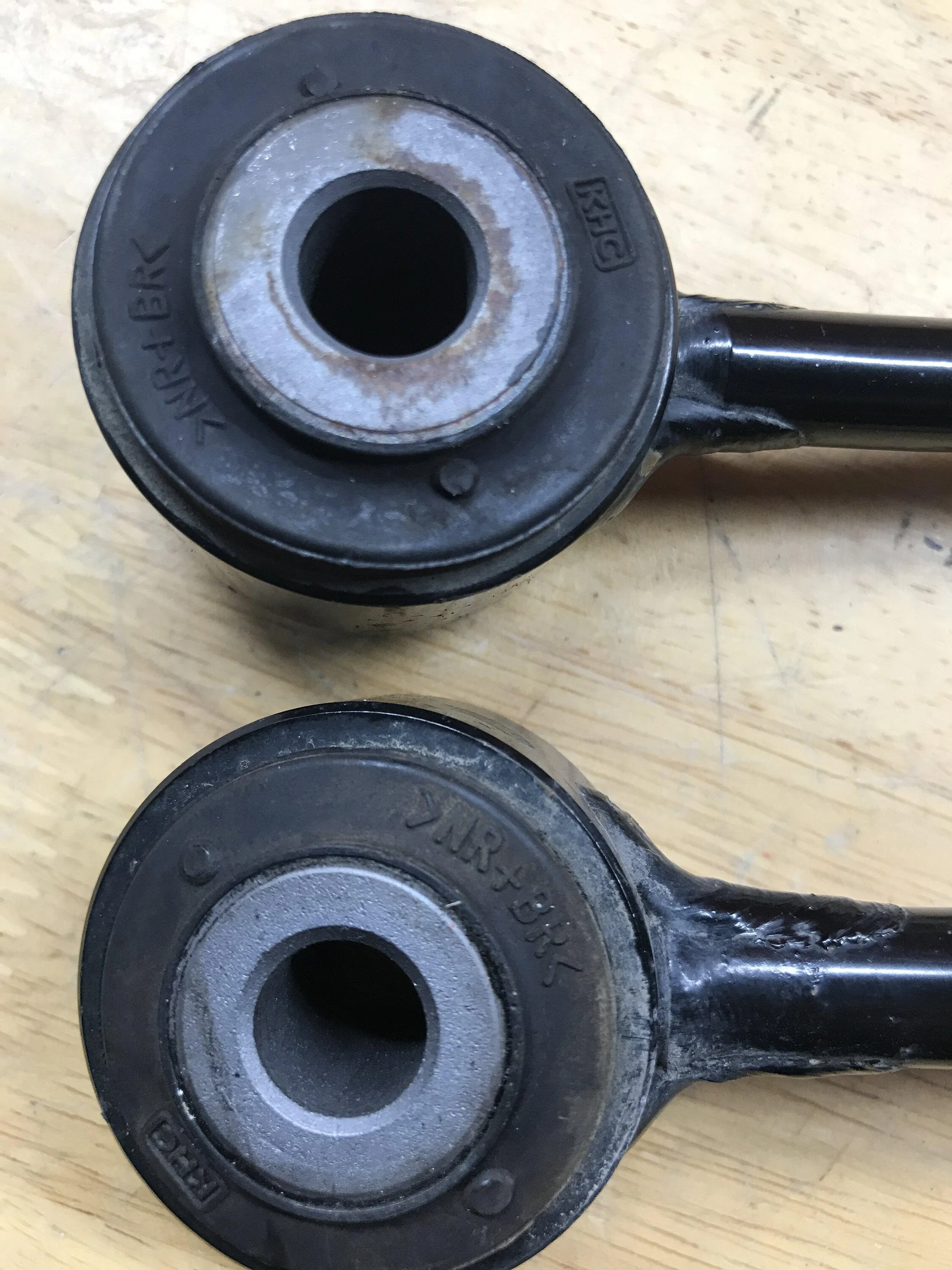

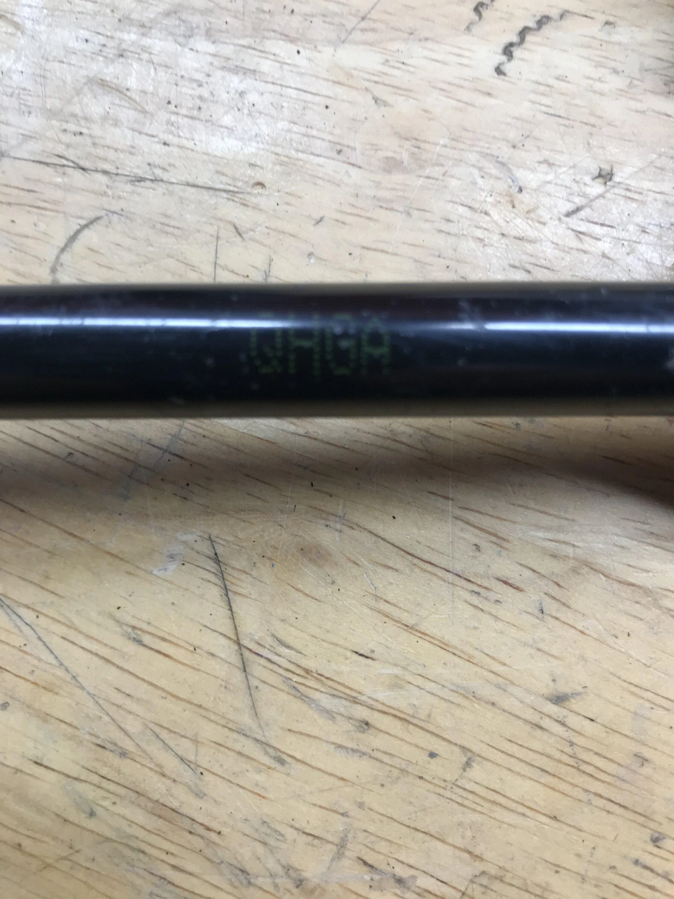

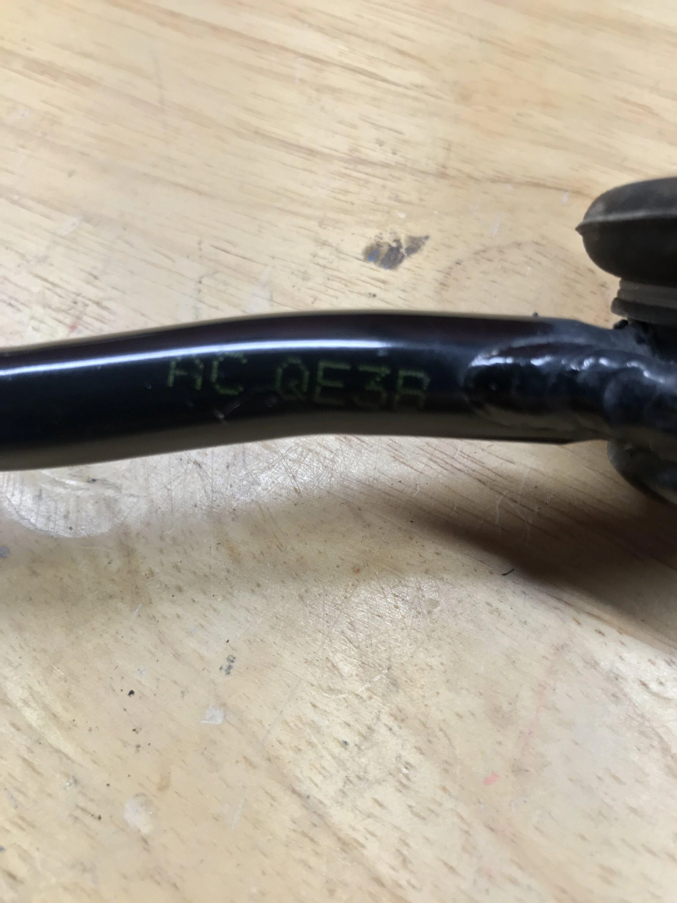

Thanks!
Are they stamped with the Mopar part number that you can tell?
Some more photos. Hard to see. But there appear to be some faint numbers in yellow along the lenghts of the connectors. The front: "AC QE3B" and the rear: "QHGA". but there may be a missing or faded away "AC" infront of that. Also some numbers on the bushings.
Thanks again, sir!
My rear ones were marked with something like M1220 in more visible lettering. Or something like that. I can't get to it at the moment. A contractor has removed my back deck. LOL
