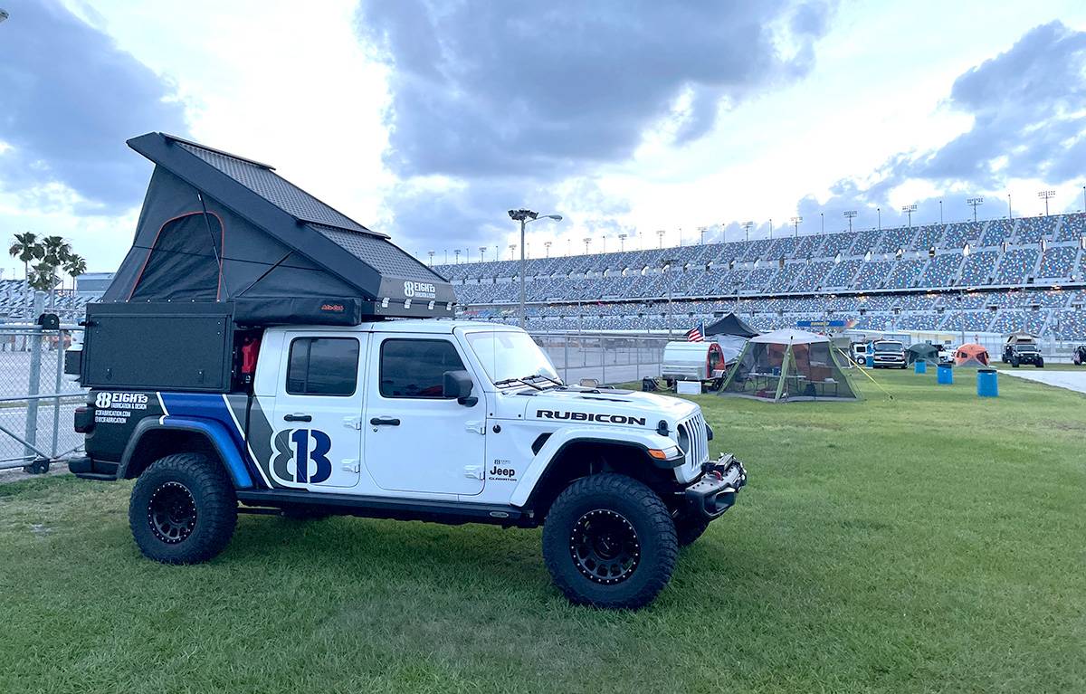

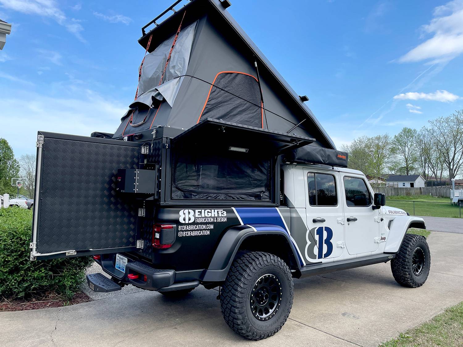

Mine is a daily driver. It has most of the options added to it. Whether you plan to daily drive it or not, you will need to upgrade the suspension, stock is not stiff enough. I'm running Fox 2.5 shocks, Dobinson HD springs, Hellwig rear sway bar. At least shocks/springs/sway bar are a must in my opinion. I also have several Steer Smarts items as well as the Powerbrake front kit. I love the way mine drives. I don't feel my gas milage suffers much more than stock with just the Mopar 2" lift and 35s that I started with. I'm very impressed with the Alu-Cab

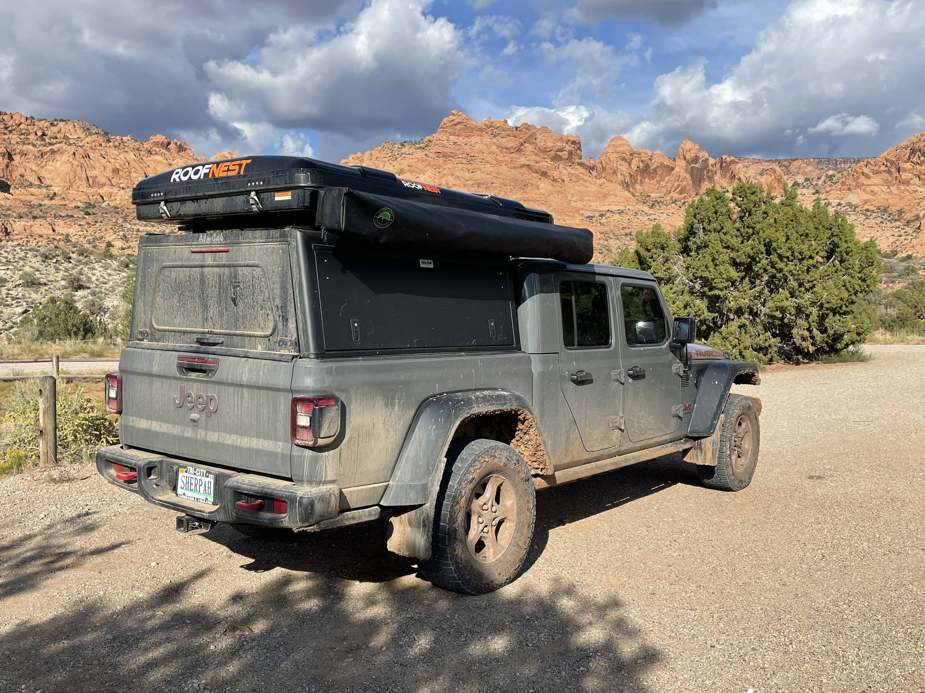

Yes it will work just fine. My 270 awning attaches to the crossbars on top of my Alu-cab canopy. The zRTT attaches to the same crossbars but separately. Hopefully you can see a bit better here…

Which Dobinsons springs did you go with on the front and rear? 2.5 or 3.5”, weight class?. Also considered the hellwig swaybar. Just installed my setup and can definitely tell it needs a little support!
813 Fabrication & Design
Rock Sponsor (Level 1)
Jeremy
Dec 21, 2019
44
761
1,009
Louisville, KY
www.813fabrication.com
Yes, I recommend the Hellwig sway bar.
I have 35's (will never go to 37s)and did not want to go too tall. I almost swapped to the 3" AEV springs until I saw a Gladiator in person that has them installed. For the Dobinsons, I have 3" in front and 2" in rear and it sits awesome. No sag, even when fully loaded.
(C29-228V) - Front, 3" in black. I had teal and they were very visible.
(C29-245V) - Rear, 2" in teal. I was going to paint them but decided not to. 2" only comes in teal.
