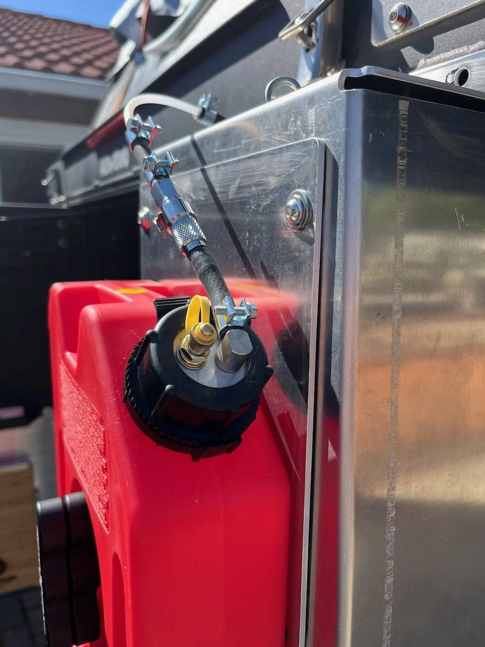

I'm actually now looking whether I can make it all fit into the aluminum part and the original spout opening of the Rotopax so I don't have to drill the can.
Okay, here's the prototype, going to order a few just to fill the minimum order value. Reach out if you're interested.
Hmpf ... after discounts and what accounts to mass production, I ordered 20 just to get to the minimum order value since I currently have no other ideas what I'd design in metal ... so they are less than $2 each.
Where'd you get the micro hose clamps like that?
cug
Guido
Apr 1, 2023
602
663
Christchurch, New Zealand
JTR EcoDiesel, Land Cruiser 79, BMW R1250GS
Just keeping busy
Some came with the Webasto heater, some with the fuel pickup. I ordered an additional five since I needed some more. Got them from Vanlife Outfitters. Likely overpriced, but I didn't want to mess around.

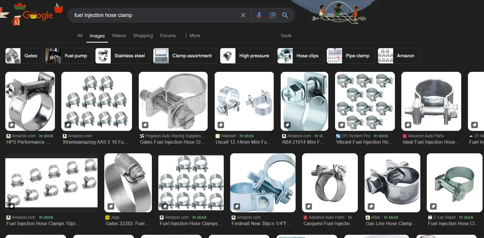

They look like fuel injection hose clamps. I use that style whenever I'm replacing any type of rubber fuel hose because they don't cut into the hose like regular hose clamps will.
Jeep Gladiator Alu-Cab Canopy Camper Roll Call clamps
fourfa
Dec 12, 2021
1,103
1,398
CA
22 JTRD + ACCC
Those are nice for relatively high pressure situations, and if you need them to be removable. If you ever decide you want the clamps to be more low-profile, with fewer sharp corners to catch on things, I'm also a fan of this style of single-use crimped hose clamps. (Link is just one random example, $20 for a kit with pliers and different sizes - these are available basically anywhere). I use these for my tire hose kits. If you really need zero sharp edges anywhere, you can shrink-wrap over them too. Just some ideas

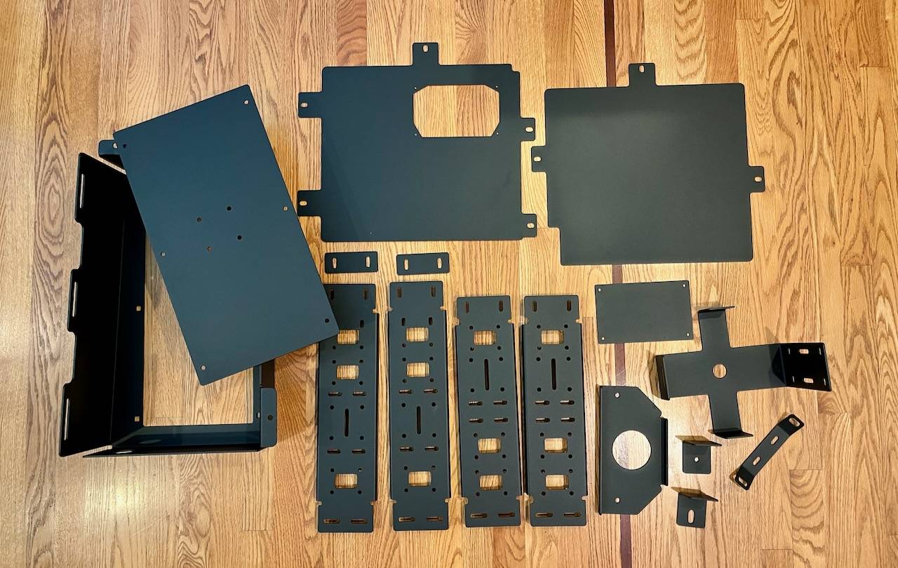

An a related note, our self designed custom aluminium parts turned out absolutely amazing :
Jeep Gladiator Alu-Cab Canopy Camper Roll Call IMG_6485
We'll install most of them over the weekend, then the door and the heater will be DONE. ;-)
And a massive shout-out to our local powdercoater JIP Finishing!
They turned this around in 24h with amazing quality at a very reasonable price. If you are in the SF Bay Area and need something powdercoated, give them a call:
https://jipfinishing.com
I have no relation to them other than being a very happy customer!
