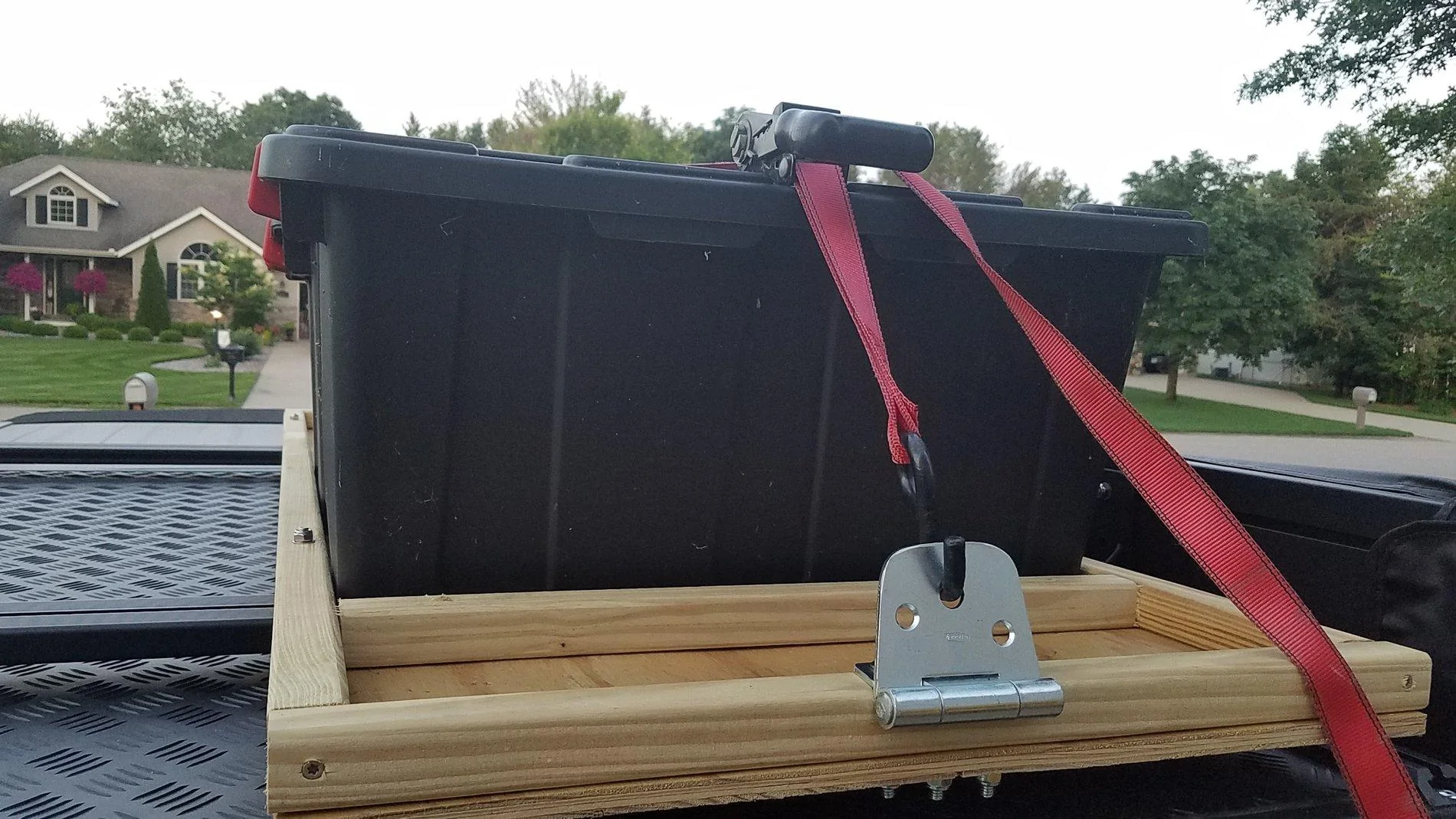

I actually just bought a 10" strap hinge, it's super thick, I'll cut off what I don't need after marking and drilling the hole. "tonight's project"!
10” will be a little overkill. You don’t want the loose end to be so long it gouges the cab top when it drops down. The 3 inch hinge you pictured is probably just right. Big enough to bolt thru the 2x2 support and plywood close to the center of the 2x2. With a couple fender washers.

the longer the strap, the thicker the metal generally. the small straps were too thin and it was only $2 more for a 10" strap hinge. So i just plan to cut off what I don't need.
True- I just think you are overthinking the stress you could put on these connections.. if you are just holding the totes on the roof you could conceivably use a much smaller gauge hinge. With a ratchet strap the totes will likely collapse before the hinge fails. Then again, if I already had the 10” hinge in my leftovers pile, that’s what I’d use too! There’s nothing more satisfying than repurposing an item to do something different than it was designed for!
Most likely, but I don't want a weak hing bending on me and somehow the strap rattling loose then have the tote fly off and break, or worse, cause a car accident. Overkill to the rescue!

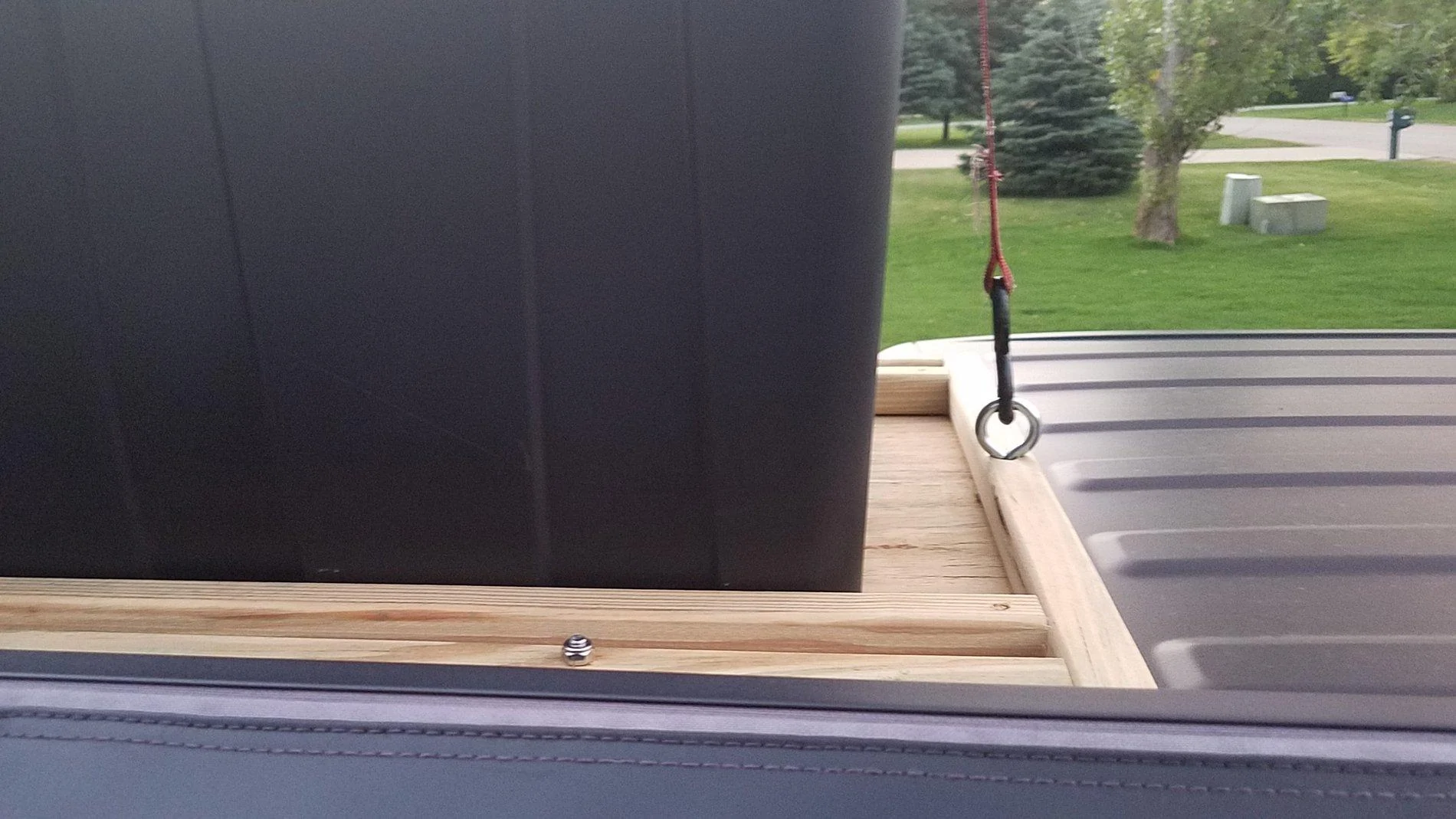

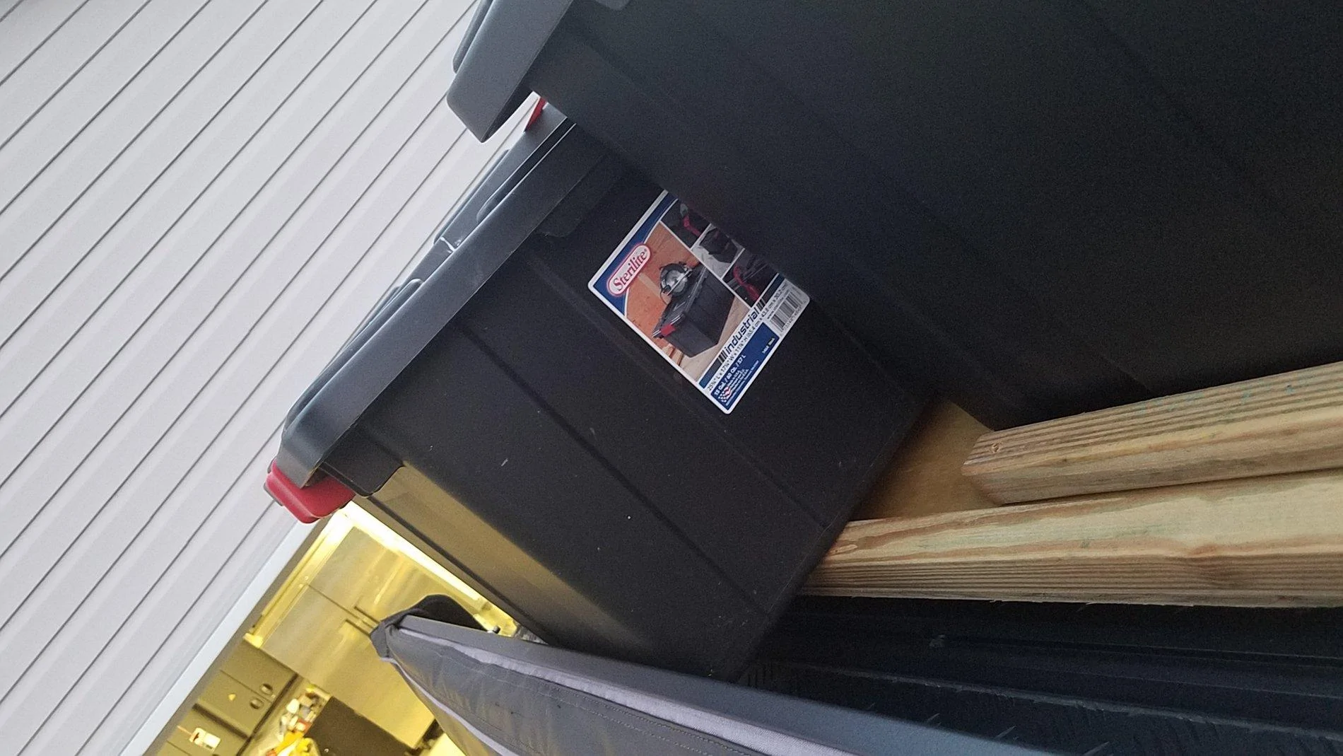

Good news the 10" strap hinge cut down worked well. I had to mount on top of rail, because if it was below, it would have banged into the canopy when not in use.

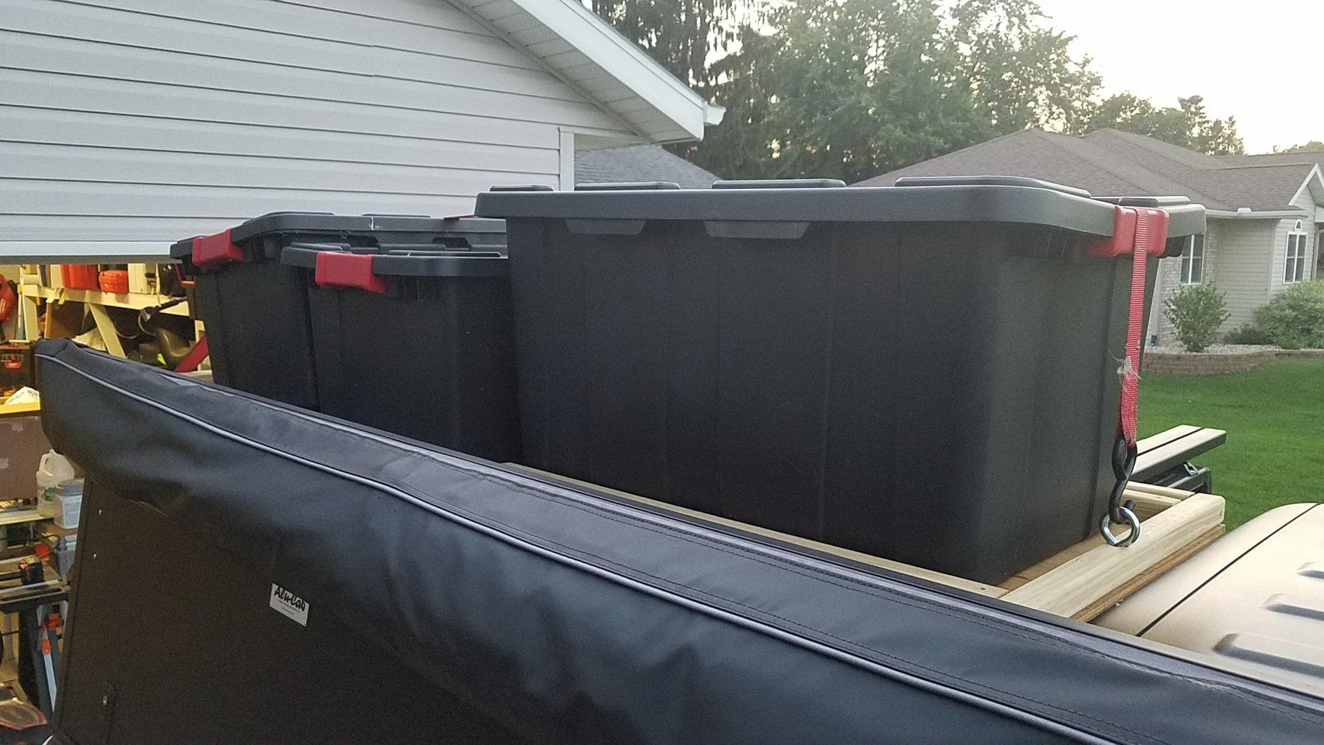

Well this is what it looked like before the highway 80mph test. front and middle totes were empty
Jeep Gladiator Alu-Cab Gladiator Bed Cap 20200630_204112
Jeep Gladiator Alu-Cab Gladiator Bed Cap 20200630_204126
This is what it looked like after. i'm guessing the different sized totes and being empty contributed to the middle one flopping around. if they were all equal height probably wouldn't have happened. sighhh, guess I can bungy them down laterally too.
Jeep Gladiator Alu-Cab Gladiator Bed Cap 20200630_205519
Jeep Gladiator Alu-Cab Gladiator Bed Cap 20200630_205523

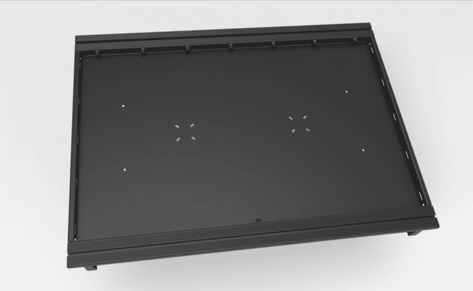

lol, looks like i'm trying to reinvent the wheel, could have just bought one of these....
https://www.alu-cab.com/product/roof-rack-tray/
Jeep Gladiator Alu-Cab Gladiator Bed Cap 1593574860786
Roof Rack Tray, maybe ok4wd can order this. Will be lighter and probably stronger, but I think I like my dimensions better, it sticks over the hardtop about 9 inches.

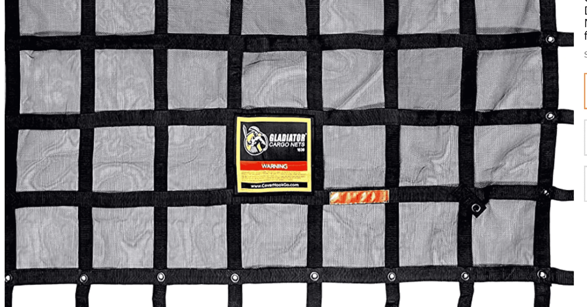

Okay, can somebody educate me on how cargo nets work? Seem simple enough, but this one says its 3'x4' and stretches to 6'x8'. So does that mean you're supposed to stretch it over your cargo, so there's no stretch left for stuff to fly around on top of your vehicle? Or do you not need to stretch it tight? Silly, i went through all that trouble to get my hinge mounting point to work, I can either use 3-4 ratchet straps, or a cargo net.....

Never used one that stretched..... seems it has to be tight to be secure.
I sewed my own for my FJ Cruiser rack from 2” nylon webbing. No stretch. All the interwoven intersections were sewn. Used velcro to secure the cinch straps that came from each web. About 6” grid openings. Mostly used for soft stuff, tents, awnings, chairs, duffles, bags of charcoal.

Hey look at that, a company makes the nylon nets specifically for our truck! :CWL:

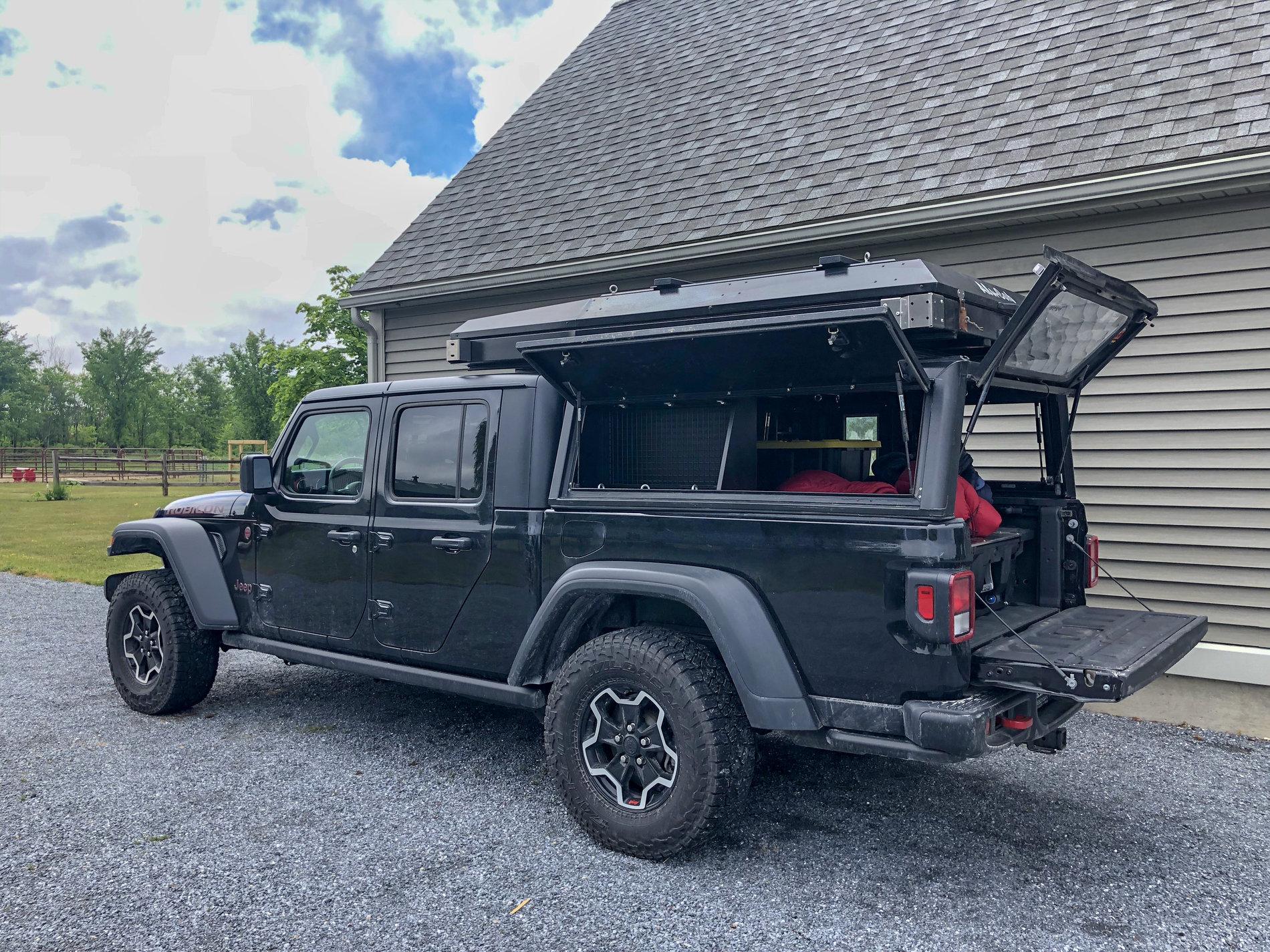

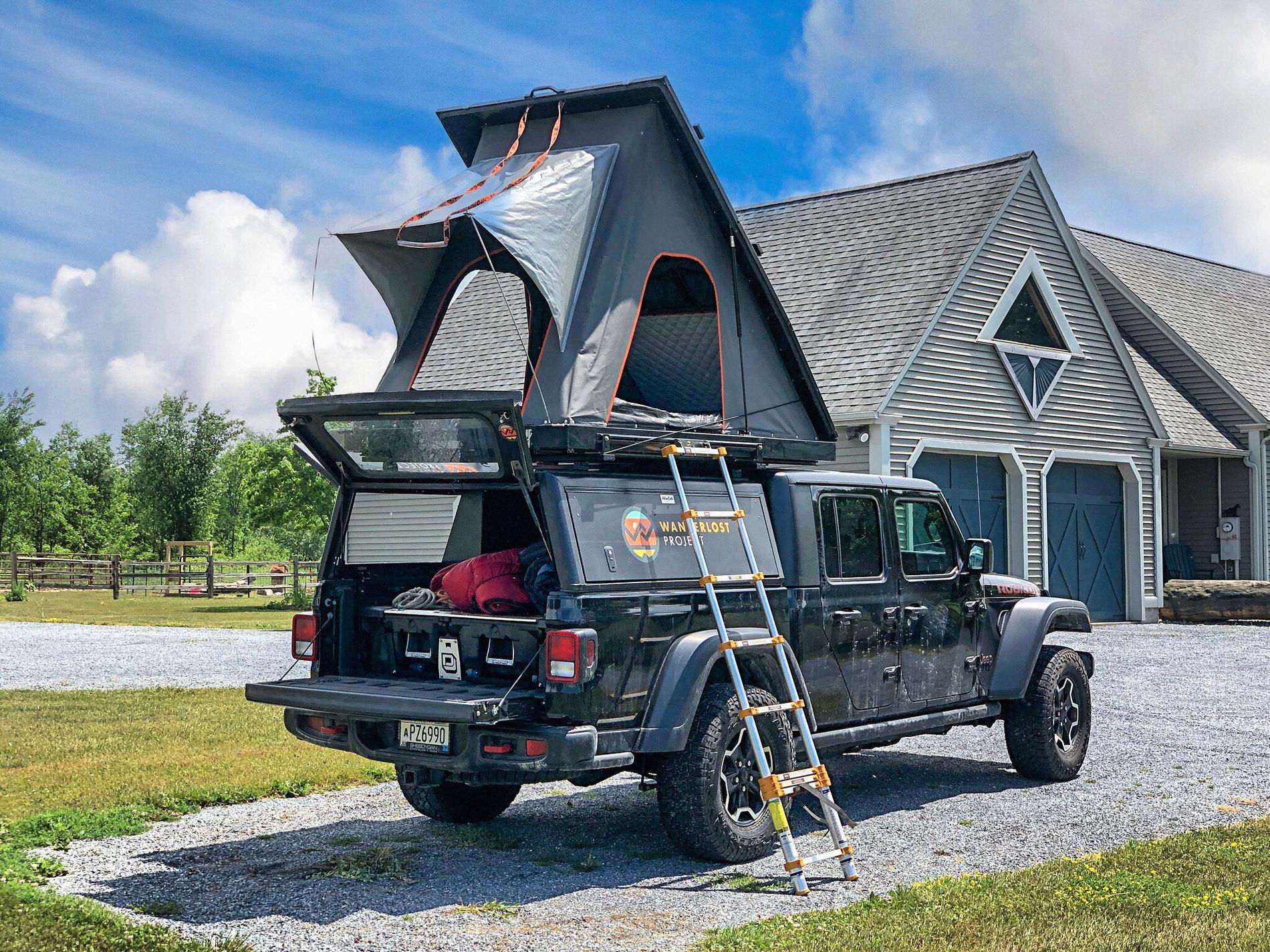

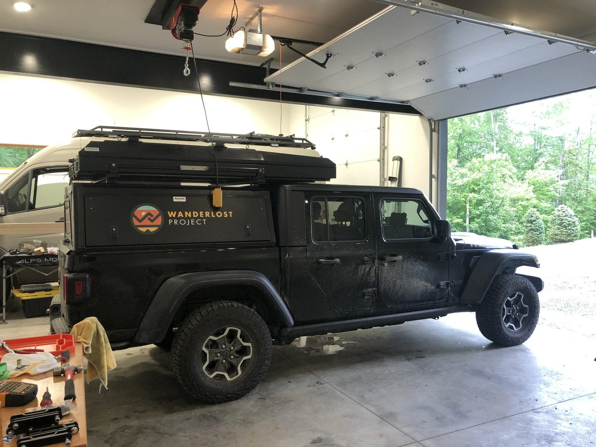

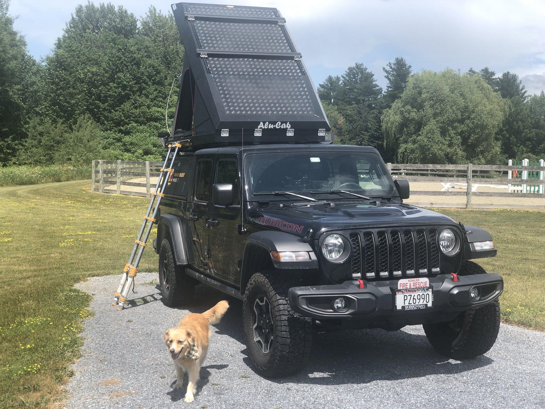

This is a Tacoma Alu-cab Canopy and Gen 3 tent on a JTR. It’s not perfect fitment but could be with a couple minor modifications to the front mounts and tailgate. Love the Alu-cab design - very light and strong with mounting rails literally everywhere.
Did have to shim up the tent to clear the hard top because the Tacoma is not quite as tall.
I did order a JT version of the canopy and will be posting this Tacoma canopy for sale in a few weeks. It was just part of a barter I worked out.
I’m impressed! Just have to decide if the tent will live on the Jeep or if I should take my adventure trailer Horizon off the market and upgrade the current Eezi-Awn with this one.

Who did you order your new one from? FYI mine shipped from ALU-CAB back in May and has been sitting at the Port of Cape Town ever since. The port is FUBARed due to COVID and shipping is WAY behind. Do you have any pics of you mounting of the TACO cap and what mods you had to do?
MattyB80
Matthew
Dec 14, 2019
Danby, Vermont
www.sourceandrecruit.com
2021 Jeep Gladiator Rubicon
Executive Recruiter
I ordered through ok4wd. Not surprised on shipping, hopefully by fall. :)
I didn’t do any mods other than move the front drivers bed mount more towards the mid point of the rail just to get it home. If it was going to be a permanent install I’d have to modify the bracket a bit to clear the bolt. the taco cap is wider so the bolt holes don’t line up if you locate the bracket at the widest point of the canopy (the front).
I also had to shim the tent up because the taco cap is shorter and the RTT was coming into contact with the hard top.
Nothing major.
