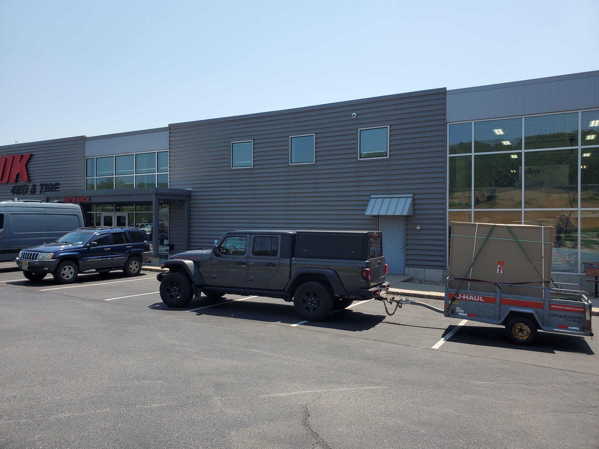

Picked up mine and a buddies this weekend! Pretty happy all around.
Jeep Gladiator Alu-Cab Gladiator Bed Cap 20220521_121408
The guys at ok4wd were great to work with and let me use their dumpster to install it in the parking lot..

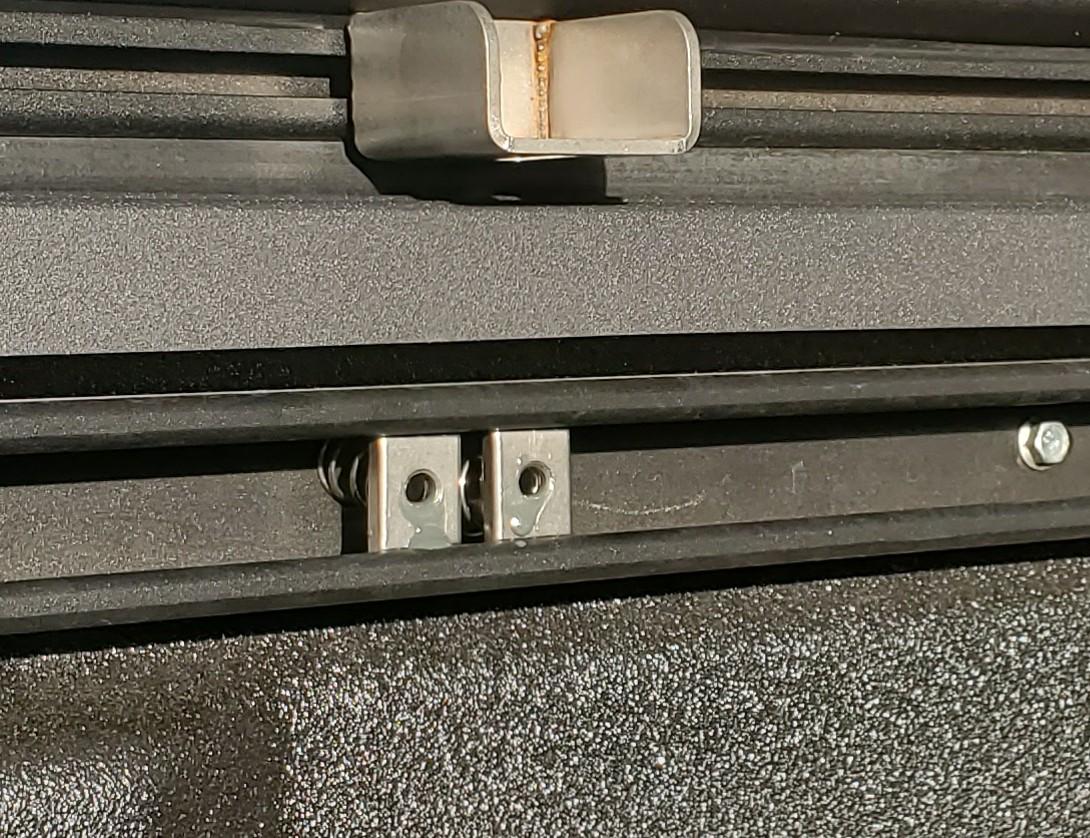

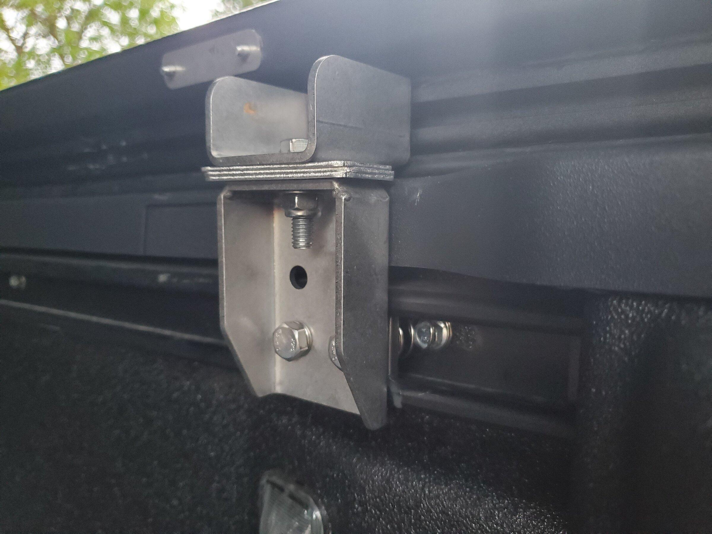

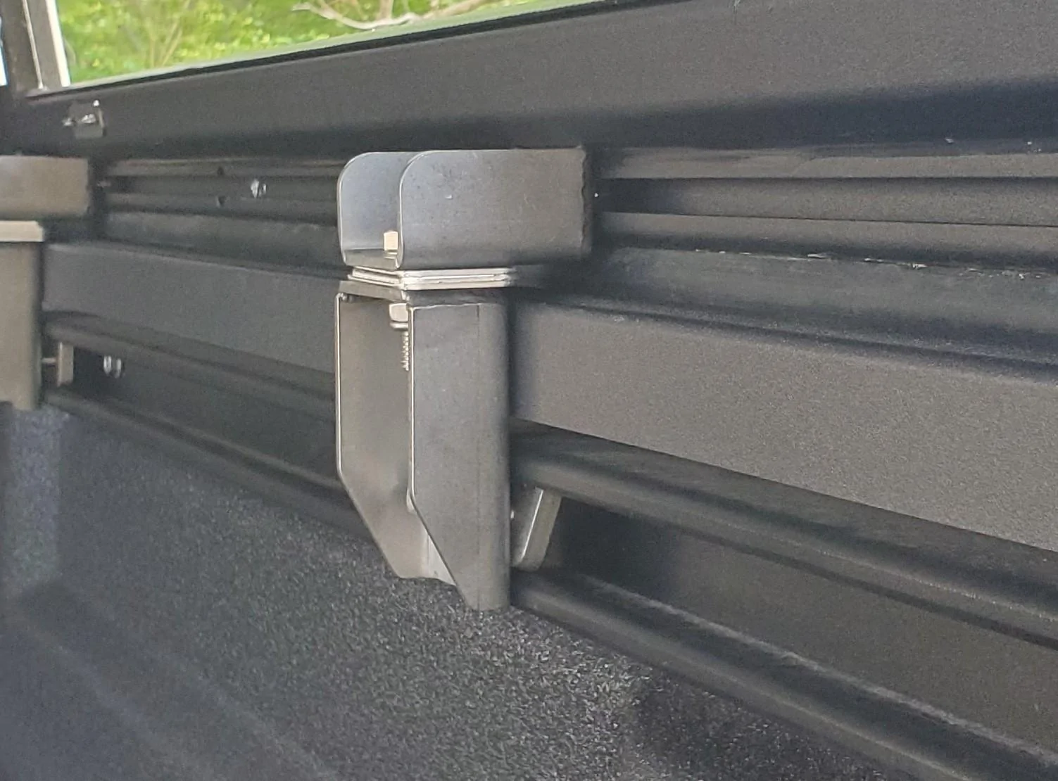

PSA for those who have the Builtright rails instead of the Oem ones; the plates that Alu-cab supplies are about 3/16" too short and really only grab either the top or the bottom of the rails. It was enough to drive home, but I checked it a few times lol..
When I got home I ordered some stainless M8 strut nuts and that worked perfectly.
https://www.amazon.com/dp/B08C7FL9BB/ref=cm_sw_r_apan_i_R7P449ZHMGMSBZJCS29B?_encoding=UTF8&psc=1

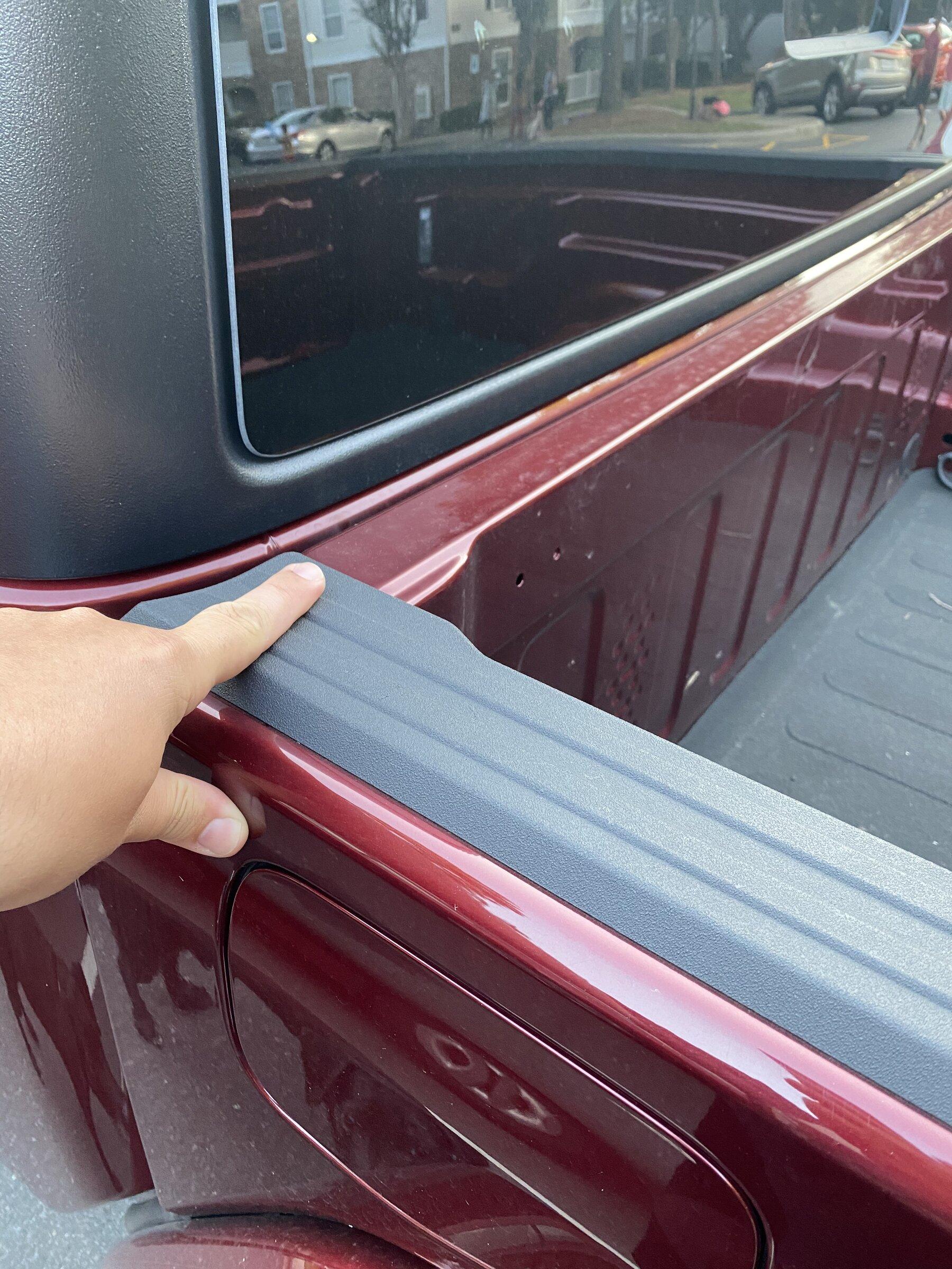

Installing the alu-cab explore canopy next weekend. I know the cap has a seal but will I need to put my own in the area I’m pointing to in the picture?

I did. Just used a small strip of the soft rubber sticky sealant I had laying around. Seems to have worked, can't really see it once installed and no leaks.
Just in the very corner, not all the way across.

Just to clarify, this thing is $4,000+, but I’ll need to make sure to get ahold of ~$5 in weather stripping prior to the install? ?
