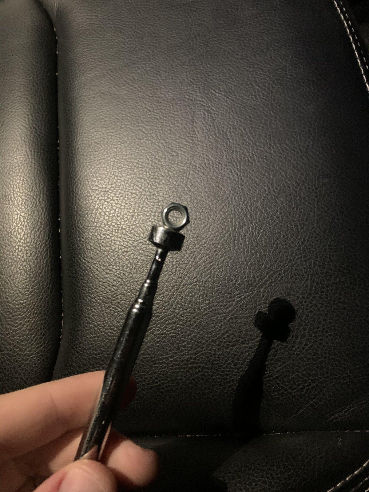

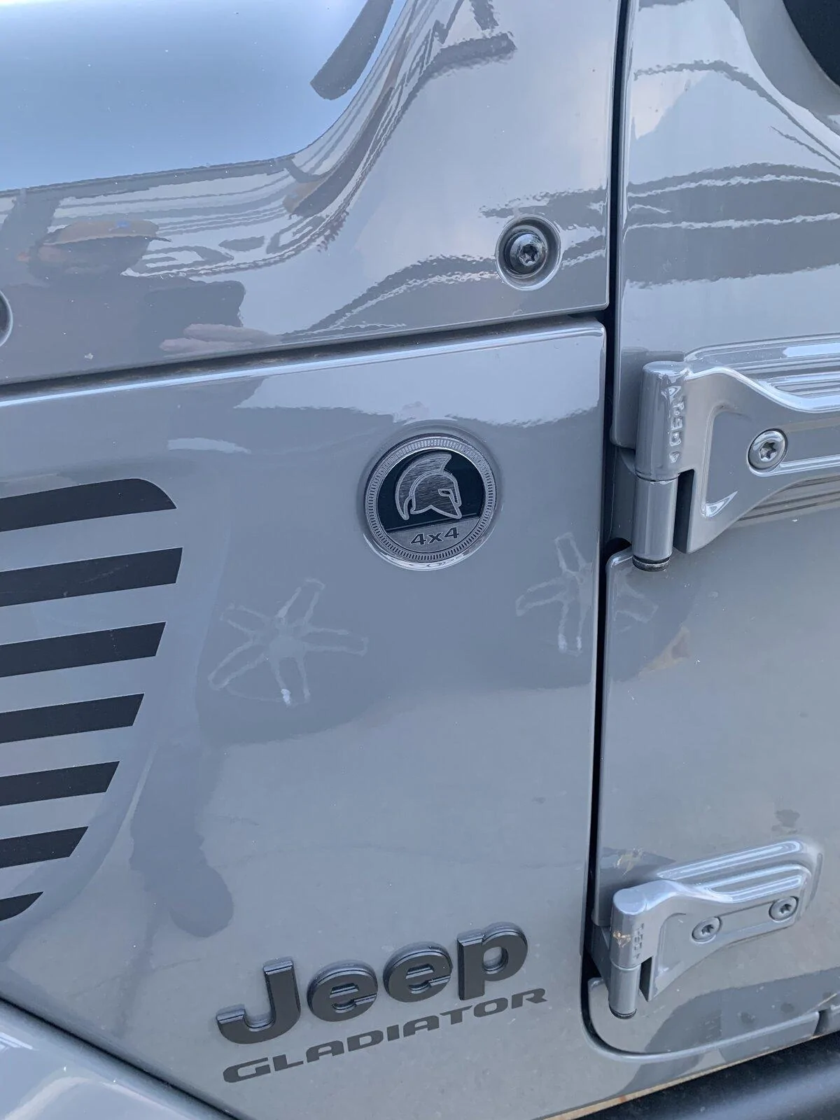

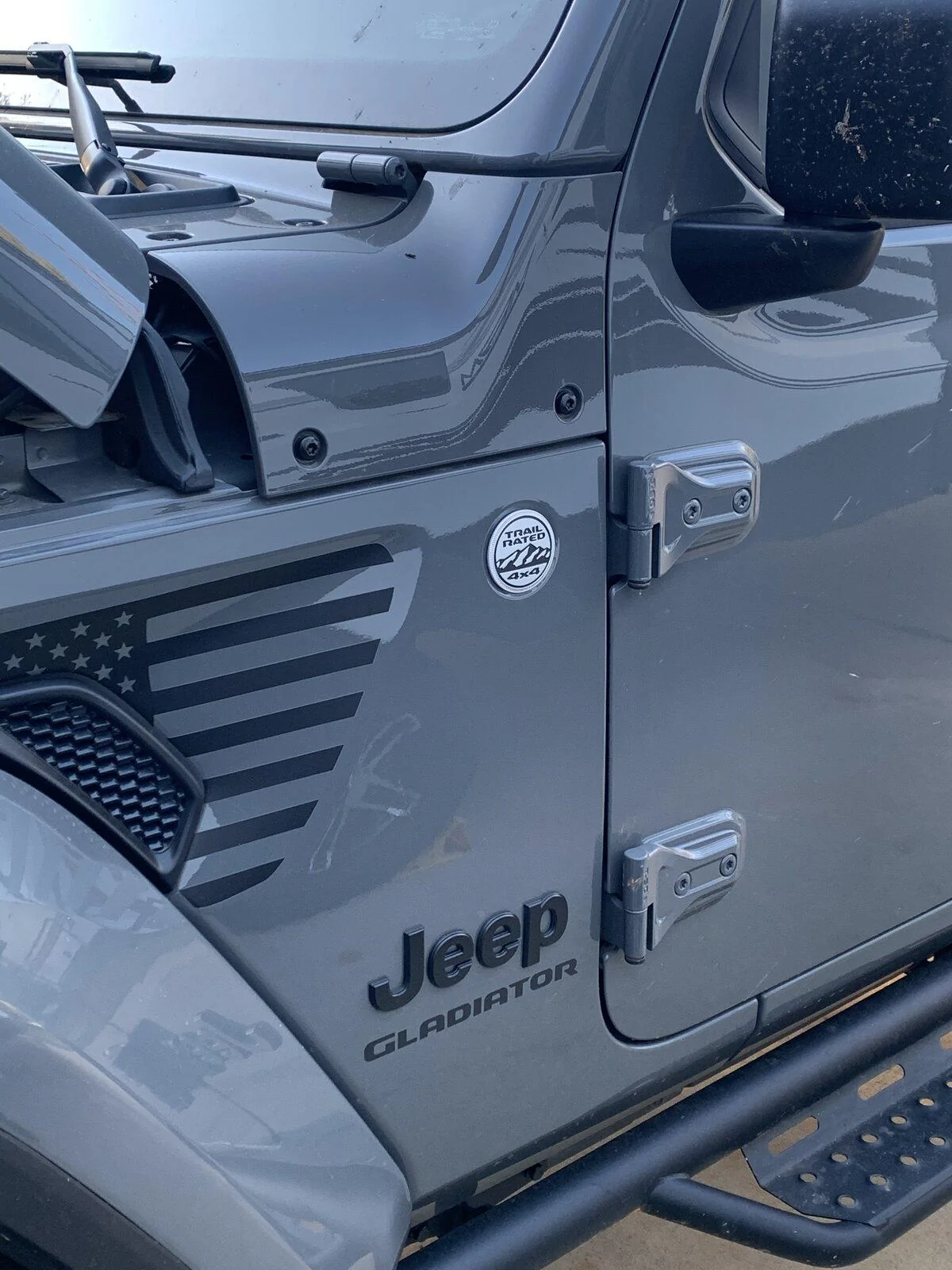

Finished this yesterday. I plugged the hole with a 5/8ā€ plug. Used a cork to measure the hole. Used a nut and magnet to hold the plug and recovered the nut from the inside once it was snapped in. Installed new badges as well!

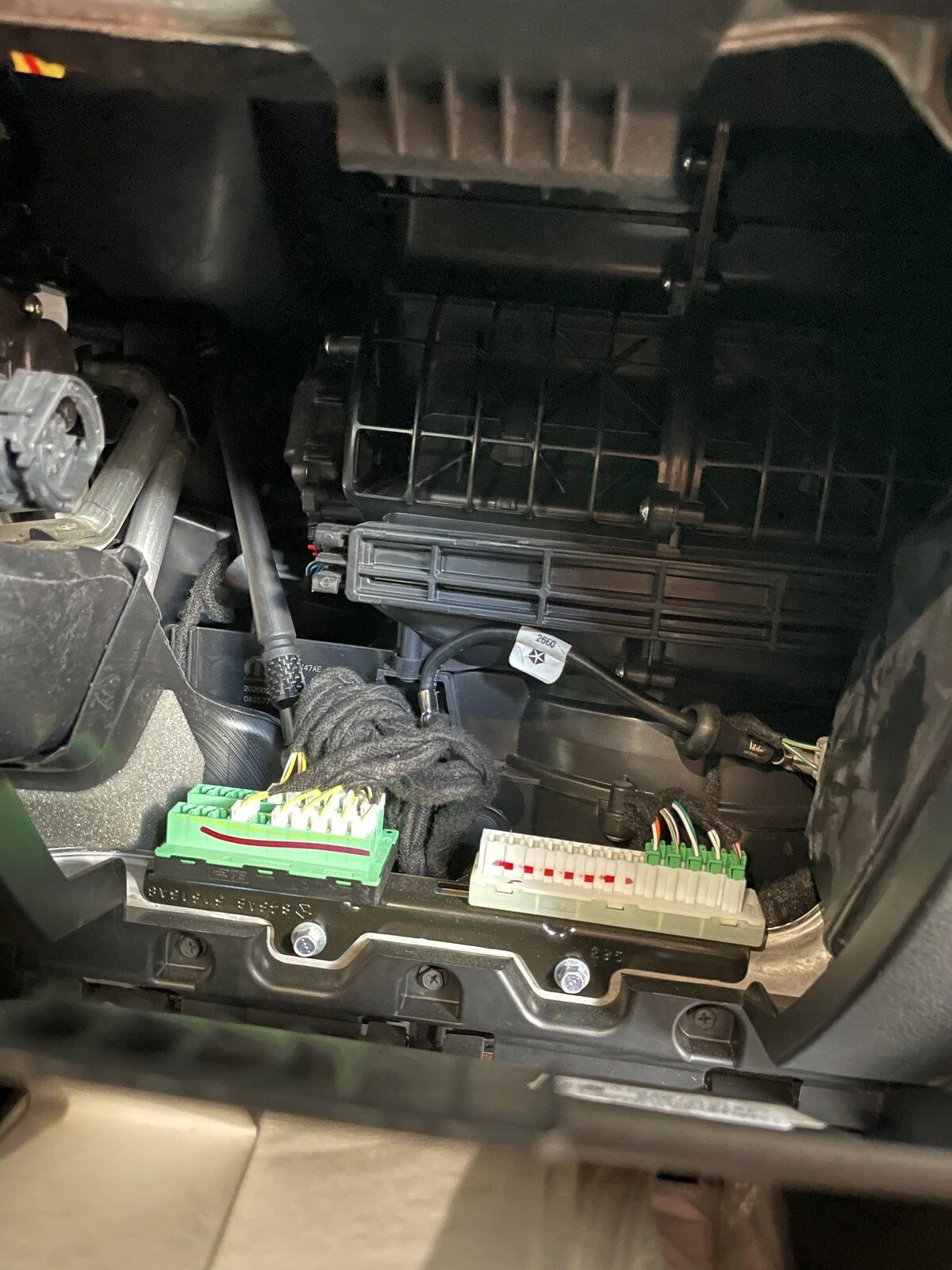

I think everyone was putting the antenna up inside the upper part of the dash as that is where the cable runs through. I'm pretty sure there isn't enough cable to move it under the hood without an extension of some sort.

I did this over the weekend...I bought the following items from Amazon:
https://www.amazon.com/dp/B07X3MWR35?ref=ppx_yo2ov_dt_b_product_details&th=1
https://www.amazon.com/dp/B001IVCLRU?psc=1&ref=ppx_yo2ov_dt_b_product_details
This allowed me to go directly from the back of the head unit...I don't listen to the radio so amazing reception wasn't really the key. I made sure I could get the stations I wanted but other than that its usually music from my phone.
I slapped another Mojave badge on the antenna hole, have to say it looks much better...

Just did this today, my stubby had started to break down at the base and hit the body on windy days. I used the OEM antenna and slid it across horizontally fairly low inside the dash. I still receive local stations but frankly donā€™t care because I never use the radio. Iā€™ll only ever use it for weather or other emergency notification if my phone for some reason doesnā€™t work.

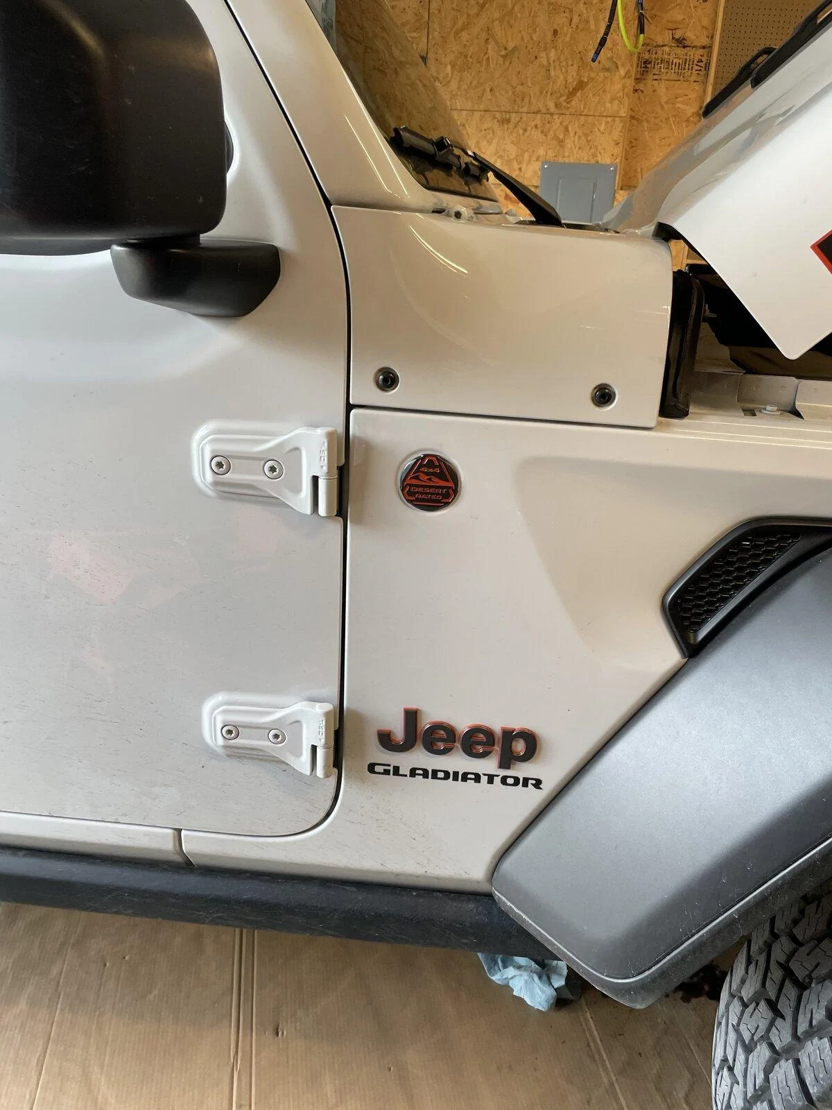

I did it today! I love getting rid of that giant antenna! So much cleaner now.
Jeep Gladiator AM/FM Antenna Delete - Moving From Exterior to Interior B69131B2-E346-43DA-8B2B-C9B608716CA7
I cannot, for the life of me, find the part number for the Desert Rated badge. Do you happen to know what it is or if itā€™s multiple parts you needed to order?
