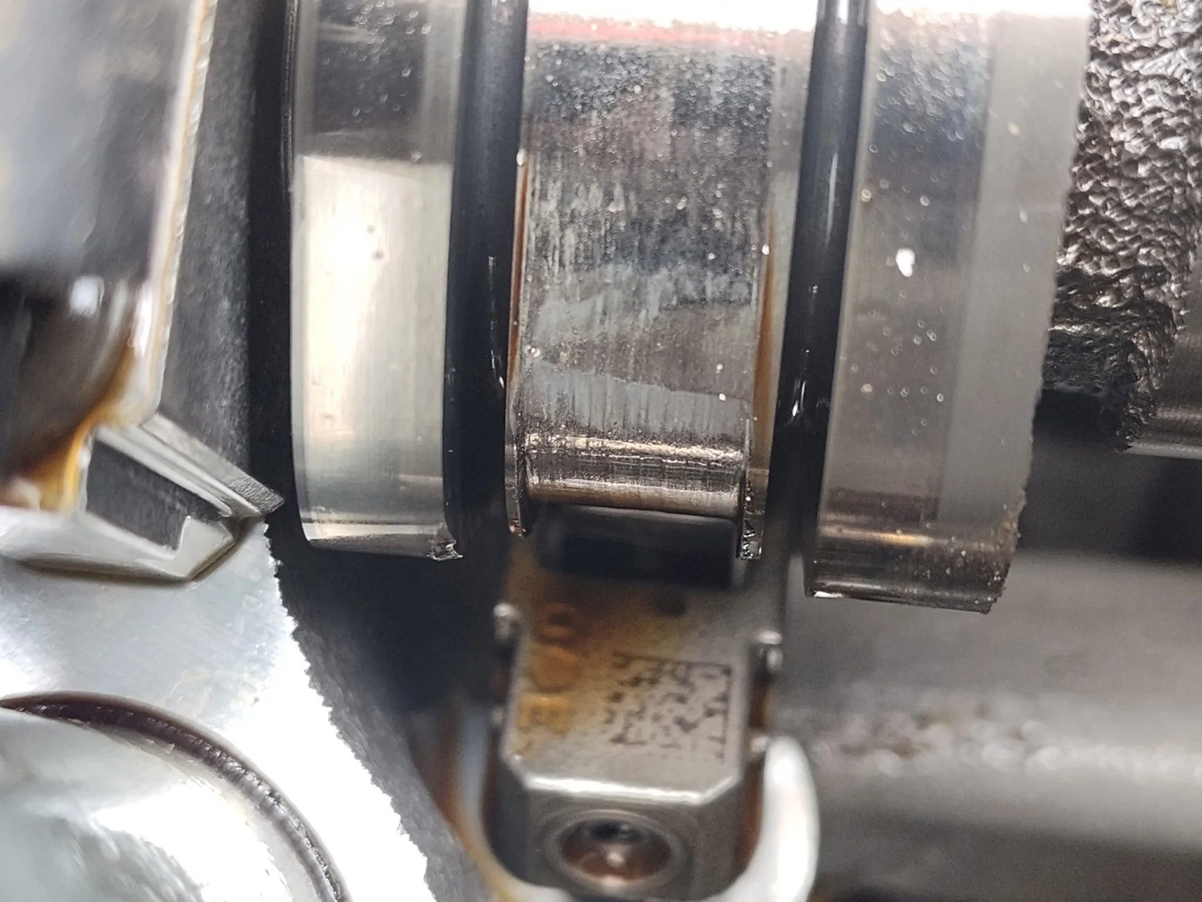

2022 Rubicon. 27K miles. Tick of death started. Pulled the RH cover and the #5 intake cam was chewed down almost eighth of an inch . My rig has a rebuilt title so no warranty for this guy.:(
My original plan all along consisted of "hope I'm not one of the (many) unlucky ones" followed by "toss this POS motor in the dumpster and install a V8".
But fate is rarely so kind to me. It happened while I am 1500 miles from home attending the funeral of my father. So I'm forced to order a Mullin aftermarket cam kit and have a local shop do the work for me just so I can get me and my 3 dogs home (wife already said "F- THIS SH-!" and jumped a plane)

Does the “Mullin aftermarket cam kit” have a different material or design? Are there any other aftermarket cam kits available?
No design differences as it is a stock replacement kit. Almost certainly material differences as it is not the same factory.
Now....Different for the better? Different for the worse? I would say "time will tell" but I have no intention of still running the Pentastar 27K miles from now. My goal is to get it home, then sell the motor and apply the funds toward a V8.
Everybody has a theory as to what causes the 3.6L to do this. So many that almost certainly one of them is right. Pick your favorite. What type oil you run. Idle vs. never idle. Oil filter drains out overnight. Wave a dead chicken over it after every oil change. Whatever helps you sleep.
Me? I'm not really interested in the "why". I know I did nothing "wrong" to cause this. So I'm leaning more toward the "F me once, shame on you. F me twice, shame on me" logic.
No way in hell am I keeping this ticking time bomb under my hood.
