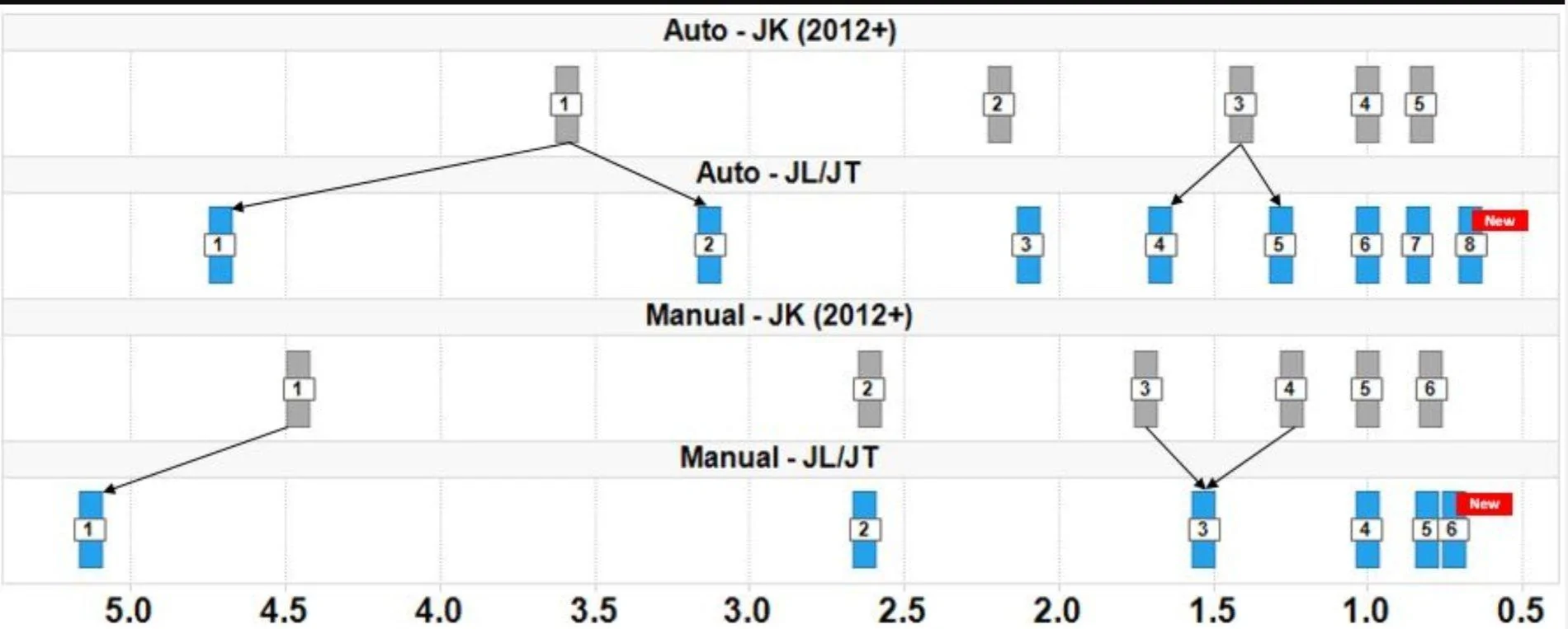

I'm at 2K flawless experience on the MT. If you expect the gearing to be like a close-spaced car 6 speed you'll be confused and frustrated. Someone said it's like an old truck four speed with stump puller first- and then a pair of overdrives, and I think that is a really good way to describe it, and once I approached it/ drove it that way, I really like it. Before I got it I also wondered, since I live in VT, if I'd find the overdrive gearing too tall to ever stay in OD on hills. But I have found on the interstate that depending on the speed I'm going, I can hold steady speed uphill one some steep, long hills, in 5 or even 6, though I have to downshift if I need to accelerate uphill.
If you want an MT, get an MT, the sky is not falling. If you want maximum acceleration under the widest possible range of conditions, you may want to consider the auto, because an auto can probably keep the 3.6 "up at full boil" in its higher RPM higher torque powerband more readily than most drivers are going to be able to with the MT.
They have probably replaced clutches for people between 80,000 - 160,000 miles.
The Gearing is like a 4 speed. You'll shift outta first quick and then have one less shift getting to 65mph. But doing 70-80/90 mph you'll be flipping between 5th and 6th
if you look at this gearing its basically the same as the NSG370 in the JK, same as in the TJ/LJ '04-'06, which I often find I just skip gears, 3rd and 4th are so close, or especially 5th (1.0-1) because 4th is 1.15-1 and that is too close most times unless you're down shifting to get up a mountain, and I always want a 7th due to the 6th being only .85-1, so I think I'm gonna really like 2 overdrives.
My '55 cj5 only has 3 gears and you're out of first (2.79-1) by maybe 3-5 mph, 2nd (1.55-1) by 20 mph and whine out 3rd (1.0-1) to its maximum speed 50 mph and you have to pause between each shift just like an old truck or you are grinding gears even though they are synchronized. But you can see the gears are almost the same positions as well, I think, maybe people expect this truck to shift like a car and they prefer acceleration over fuel economy, with a manual you get to chose when to make shifts and you can make 'em fast or slow, which is the beauty of a stick. This transmission as I see it is a granny gear, a 3 speed, then 2 overdrives, yoohoo! The venerable NV4500 valued for its granny gear (5.61), then 3.04, 1.67, 1, and .74 overdrive, basically the same as the JL/JT,
The clutch in the JL/JT is a little lighter than I would prefer.
The gearing in the JK vs JT is totally different. While the JTs transmission and linkage is clearly better the JK had better gear ratios which would've been nice on the JT. FCA was clearly going for MPG with the JT wide gearing and two overdrives. This would be ok with a torque rich engine which the 3.6 is not. The combination just does not work as it should and the results are lackluster.
JL/JT vs JK
1st – 5.13 4.46
2nd – 2.63 2.61
3rd – 1.54 1.72
4th – 1.00 1.25
5th – 0.81 1.00
6th – 0.72 0.80
Rev – 4.49 4.06
