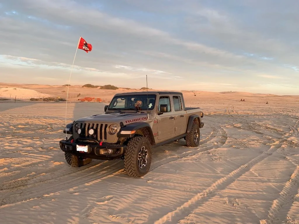

Depends on what kind of off-road use. I think stick shift is better in the sand and snow because you can put it in second gear and go down to 800 rpm and accelerate without down shifting to first. There are many times where you do not want to downshift when you are in the low rpms and would rather stay in the higher gear to avoid spinning the tires.
I also just got done with a 4 day trip to Oceano Dunes. For 4 days straight, with the clutch out, I was doing donuts and slides in 1st gear 4WH with 14 psi in the tires. Spinning the tires like crazy for 4 days. You can do this for a month straight and not heat up anything on the truck. If you do this with the automatic, you will start to smell tranny fluid as you are overworking the torque converter. So, for real tire spinning and sliding, over and over again, you cannot beat the longevity of the manual.

The titles above are flipped. JL/JT is the first column. 1st gear, 5.13, is pretty nice in the dunes. This is a nice gear. I was able to run all the dunes at Oceano in 1st gear 4WH the whole time -- off road plus, traction and stability control off, 14 psi.. Although the spread between 1st and second is high, I could still shift to second and not bog out in the dunes on an incline. Note: I am still running the stock MTs and I have the Rubicon.

The titles above are flipped. JL/JT is the first column. 1st gear, 5.13, is pretty nice in the dunes. This is a nice gear. I was able to run all the dunes at Oceano in 1st gear 4WH the whole time -- off road plus, traction and stability control off, 14 psi.. Although the spread between 1st and second is high, I could still shift to second and not bog out in the dunes on an incline. Note: I am still running the stock MTs.

I have zero experience running in dunes (but I hope that changes!) Is the idea to be spinning the tires much, much faster than you would on solid ground? Are you flushing sand out of all the nooks and crannies for weeks afterwards?:)

yes, it is a blast, and you never have to use the clutch, the JT will go very slow in 1st gear before stalling. yes, the sand goes flying, but, with the stock Rubicon MT tires, the width is still inside the fender flares, so, there is nothing really hitting the paint. You can really drift the JT in the sand. Be careful in the sand though, because if you go too fast, and slide too much, the sand will build up on the side of the tires and stop the truck abruptly and it may tip it over. A few years ago, I saw an old Bronco tip over that way. The guy was going fast, probably second gear or 3rd gear, then turned 90 degrees to slide in the sand, and the bronco tipped right over on its side. They tipped it back over upright, and kept thrashing it. Remember, your tires have to be spinning like crazy to slide in sand. If you are going fast and you tires are not spinning and you try to slide, you could tip over --- because the sand will just build up on the side of the tires and cause them to stop abruptly.
Spinning the tires is just for fun. For running dune hills, you want to be in the right gear where you get the most traction and power to climb the dune. If you give it too much gas while climbing the dune, the tires can spin too much and kill your climb and cause you to drift sideways. The best way to climb dunes is to use the speed and power that lets you climb up the hill while floating over the sand with as little wheel spin as possible.
