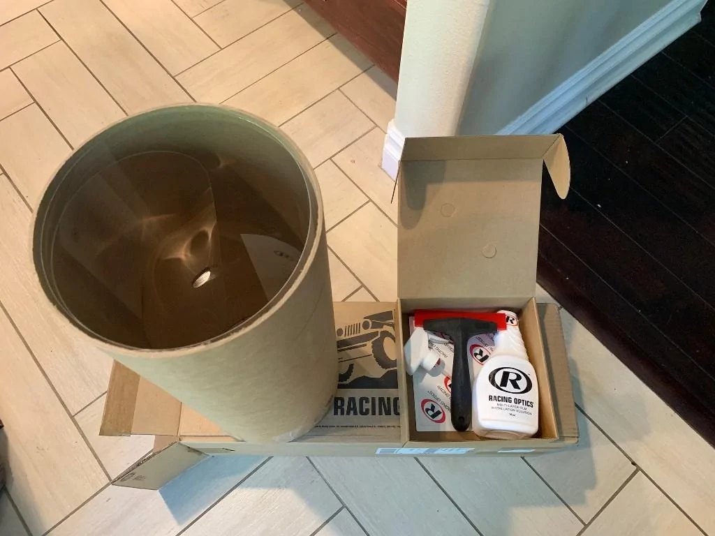

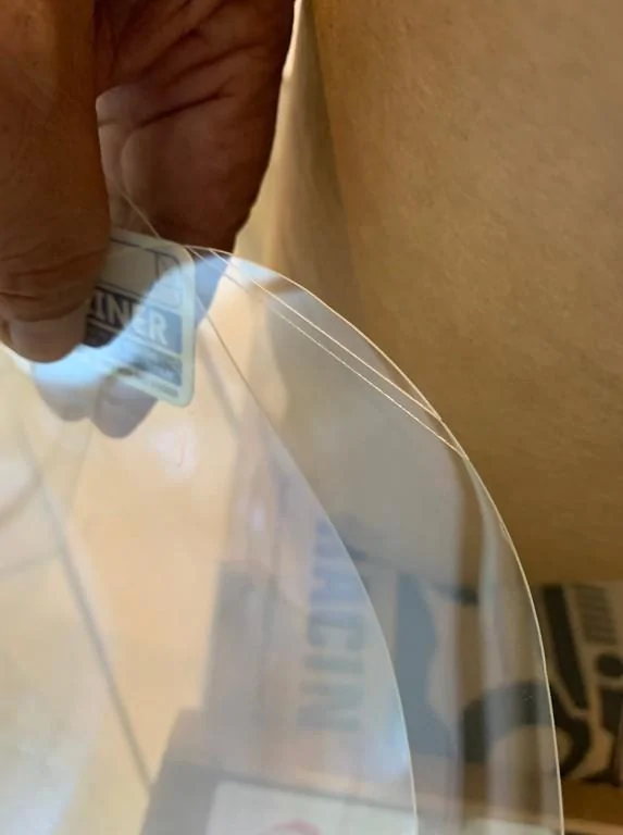

I received the Racing Optics Jeep kit super fast. Here is a couple of pics of the kit. The film is thick and looks to be great optical quality. Like looking through glass.

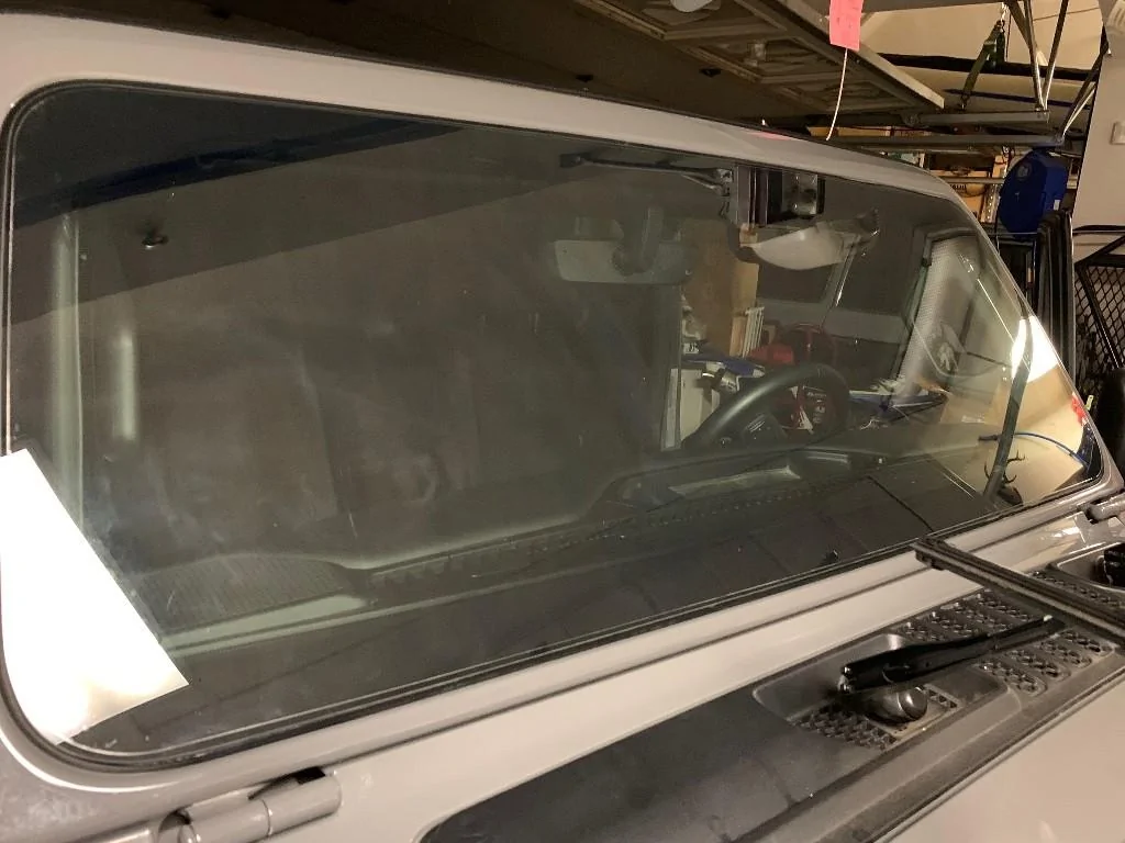

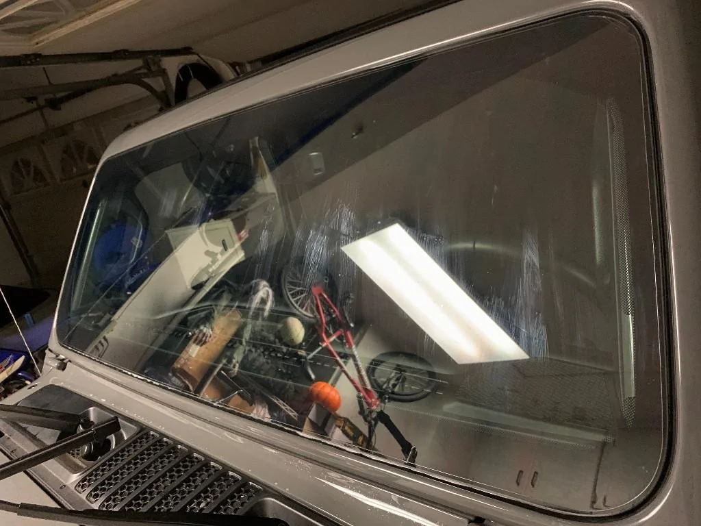

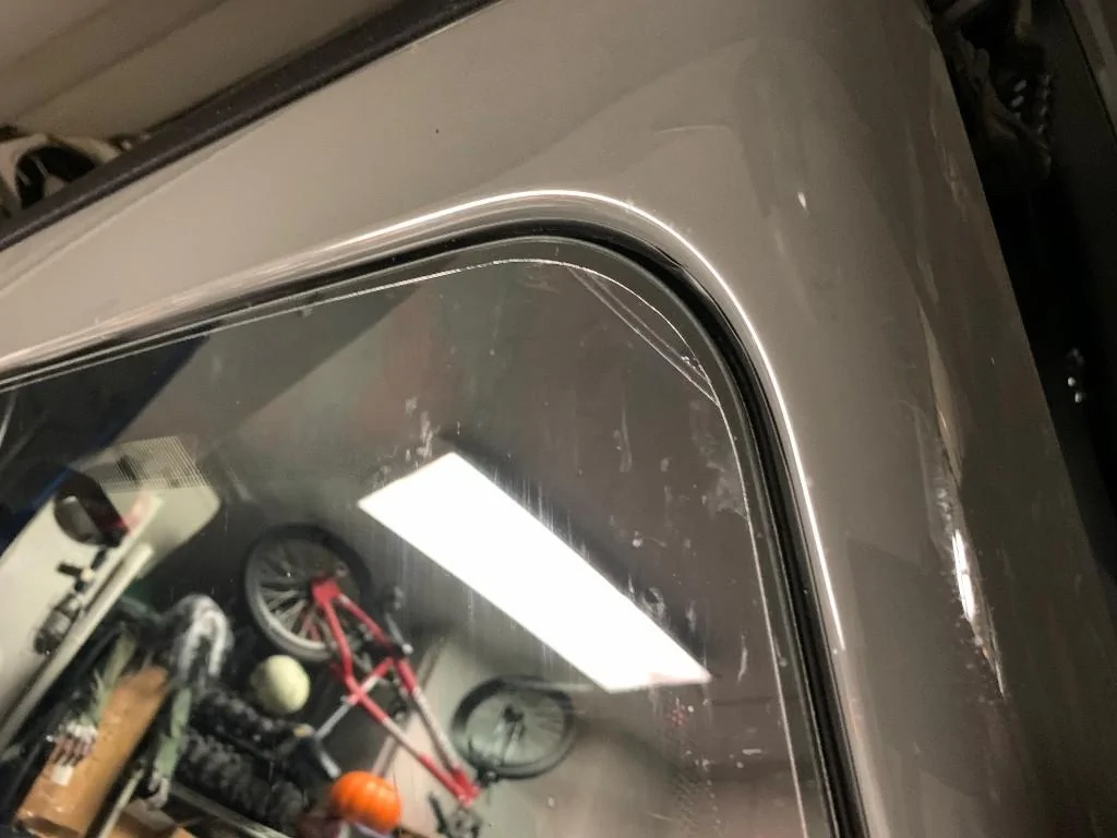

Here are some pics just after installation. The film still has smudges on it and has not been cleaned yet. I just got all the water out. You cannot tell it is on and based on the thickness of the film, I am excited that it will really protect my windshield. The main tip is to make sure your windshield is spotless. Clean it many, many times before installation. I changed my mopar windshield last week and I saw 3 rock hits already during the installation ! The last pic shows you the 3 layers and the peel offs.

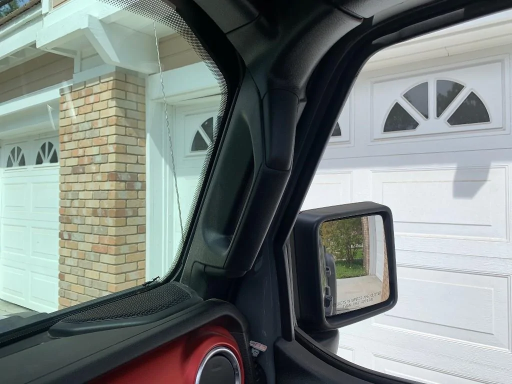

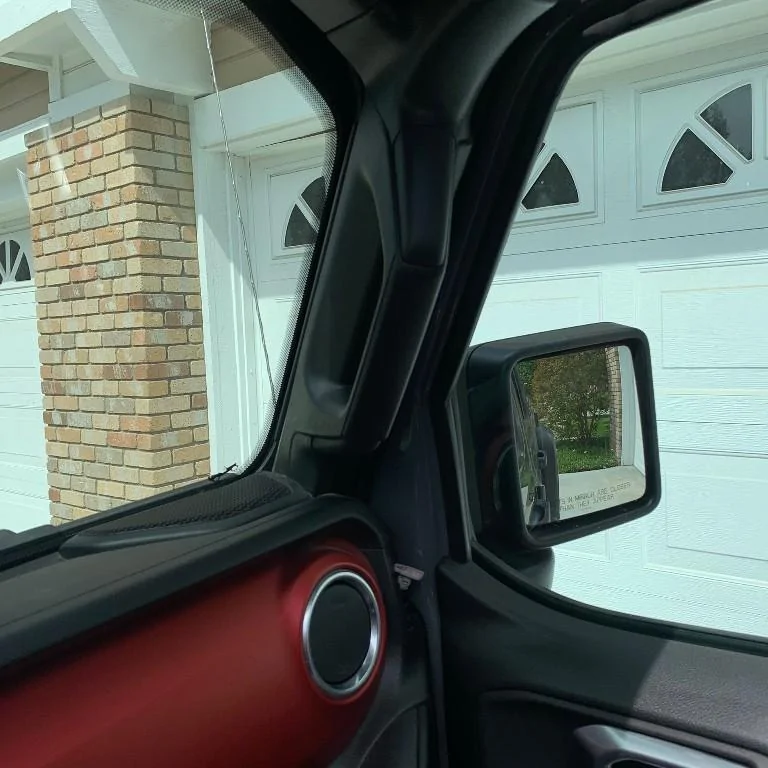

Here are a couple of pics of light transmission. The windshield blocks all UV light now, so, it seems cooler.
Pic comparing no window to windshield
Jeep Gladiator Anybody got Gorilla Glass? NiFEbG
Pic comparing stock side window to windshield --- Very nice.

yes, it is pre-cut to the jeep. It seems to be great quality, I am very happy with it, and the tech department was first rate. I sent them an email and they called me back right away and their technician called me also. Here are the secrets to the installation.
1. Get the windshield and everything around it super clean,
2. Also spray the outside of the film with solution after you put it on the windshield to help with the squeegy.
3. Use a lot of weight on the squeegy while pushing the water out, and keep the outside of the windshield wet with solution. You will not scratch the film, so, push hard and try to get all the water out. Any water left will disappear with heat and time, but, it is better to get as much as you can out.

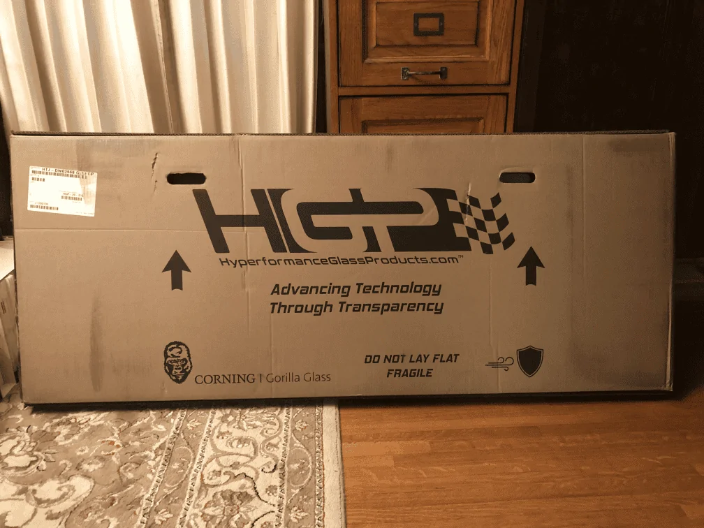

Its finally here:
