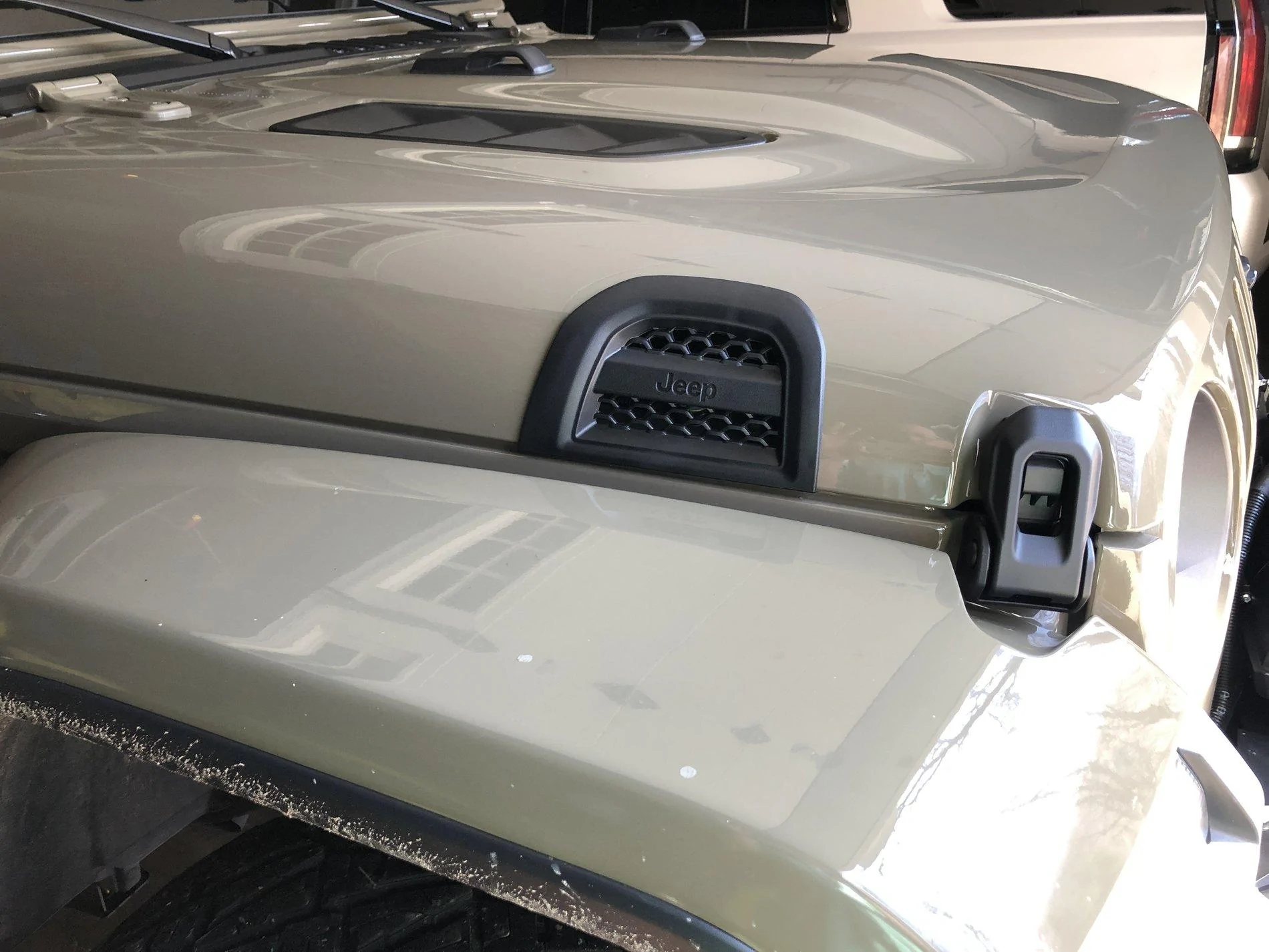

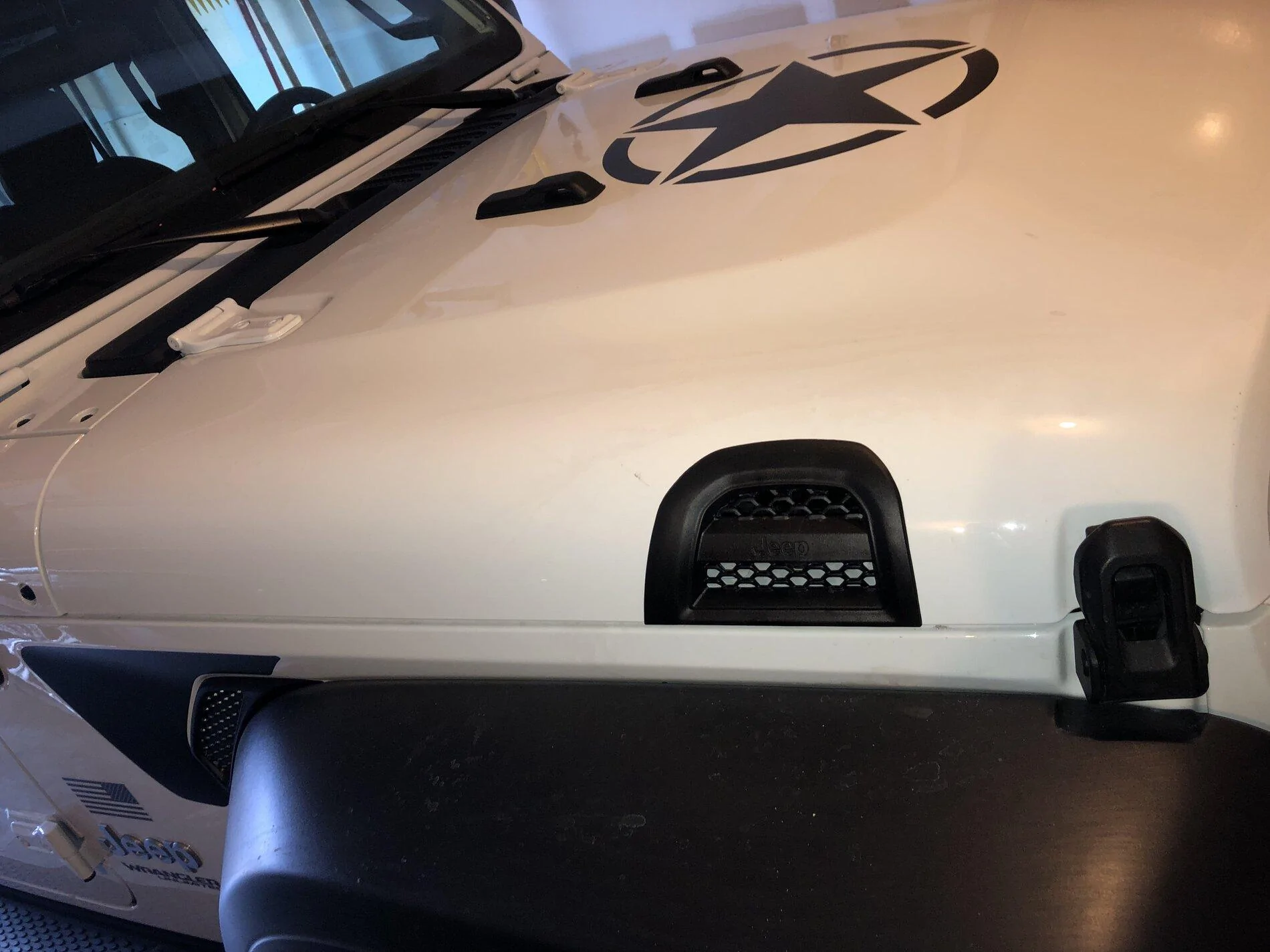

For those interested I finally cut the hood vent in recently. My video is the one listed earlier so this is part 2. I guess these are now a $495 option from the factory. Well worth it if your interested. Cutting this in was not hard but I was shitting my pants.

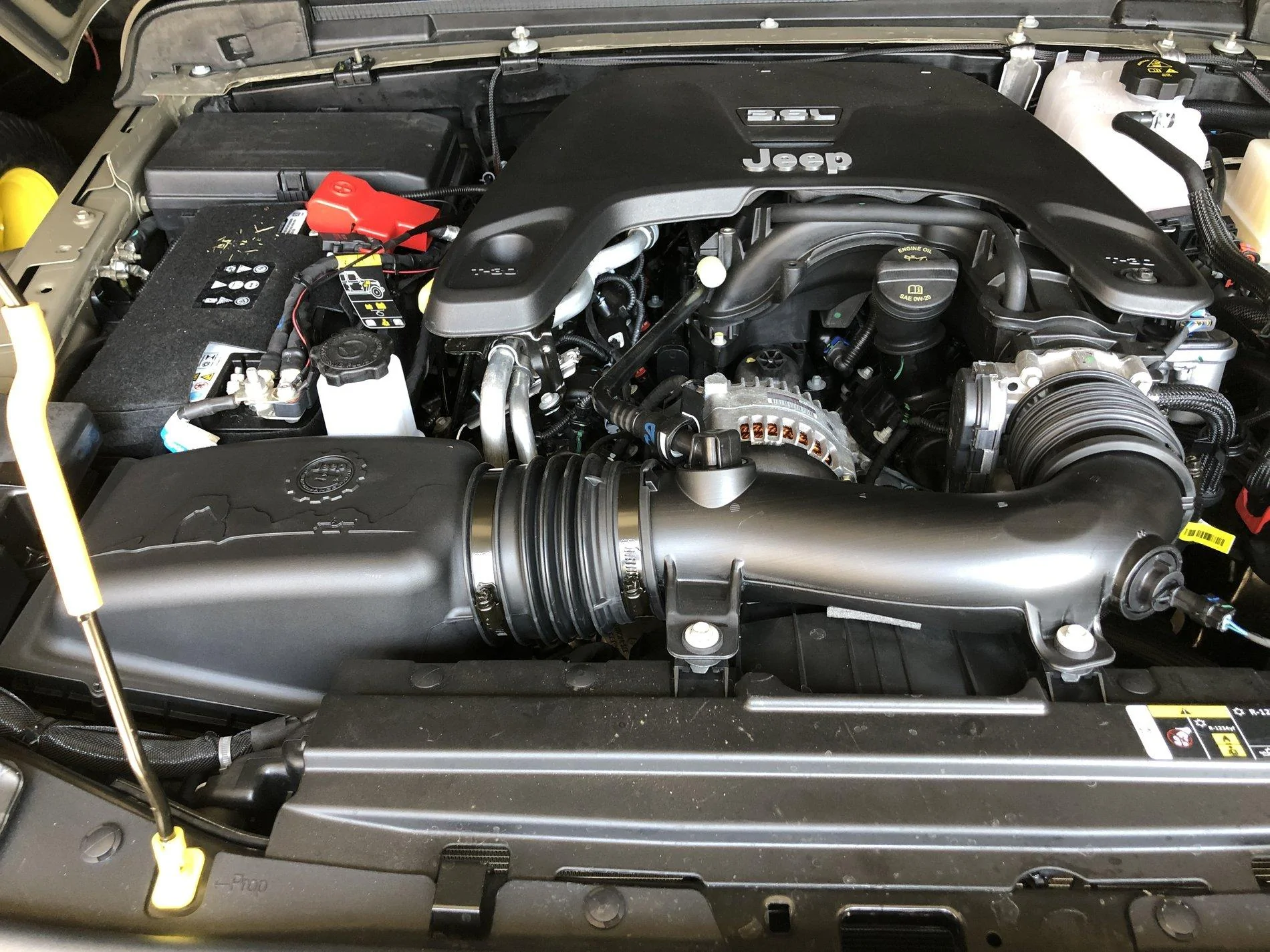

Sat on this purchase for over a thousand miles and decided to pull the trigger. Puckered at the thought of cutting my hood but figured what the hell.
So far - I am happy with the combo of Mopar Cold Air Intake and Mopar Performance Exhaust. Do I think my exhaust sounds better...yup. Can I say this had little or no impact to cab noise (unlike others I have installed that you hear it sucking air)...yup. Would I buy and install it again.....yup.
Additional horsepower? Not going to, won't do it, cant say it made a positive or negative impact.

No induction noise increase over stock. Maybe a little bit of an increase in low end torque but no noticeable horsepower increase. Slight increase in fuel mileage but nothing worth writing home about. Net/Net I would say negligible if any performance improvements. I would still do it again as I have not seen another one and like how it lowered/deepened the sound of the Mopar performance exhaust.

I do notice more noise now that Its warm enough to take the top down. I also get quite a few jeeps staring at it.
I guess the factory option does NOT include the hood cut. A member on the JL forum got the option and the vent kit was in the trunk.
You’re a braver man than I.

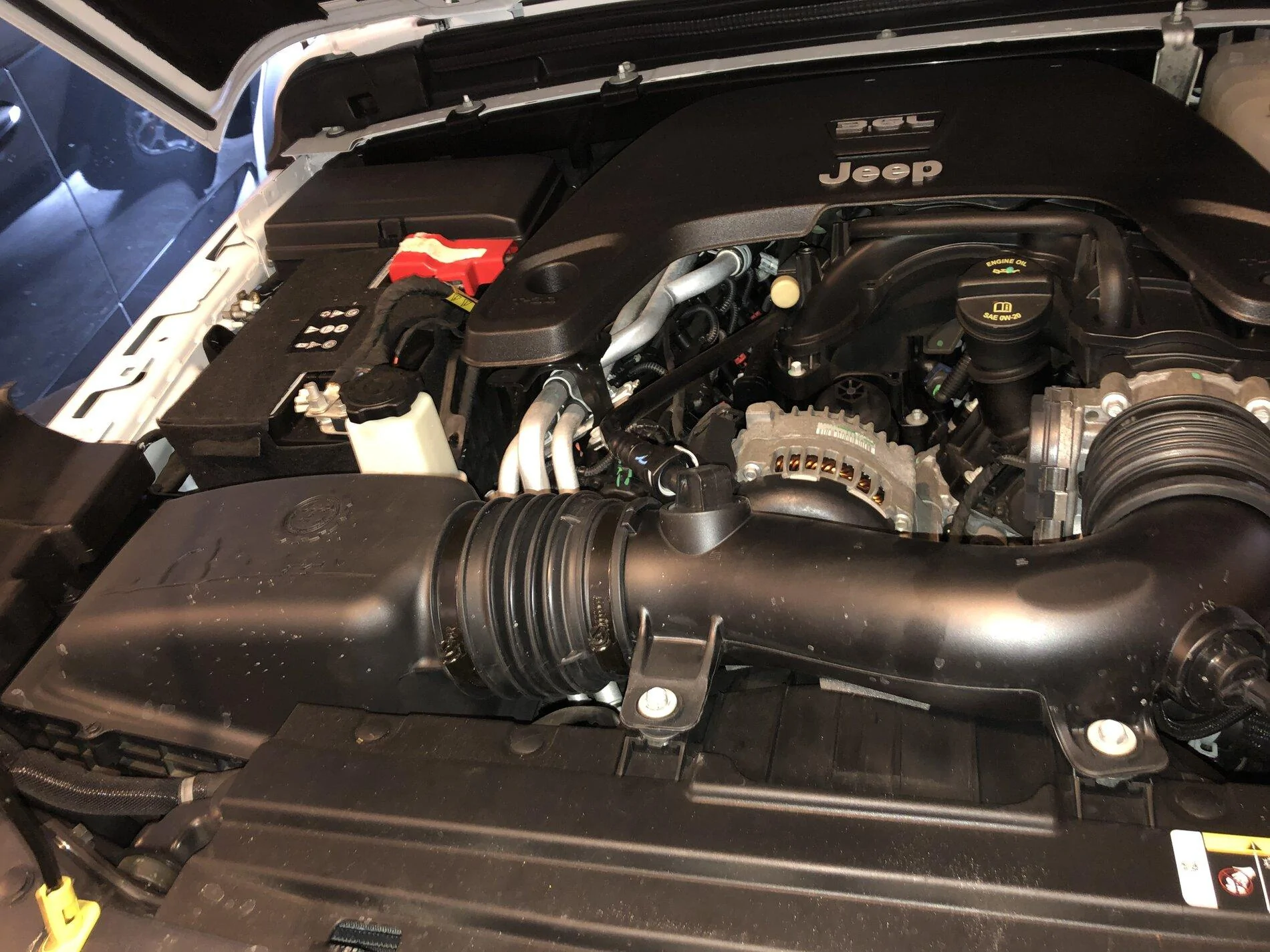

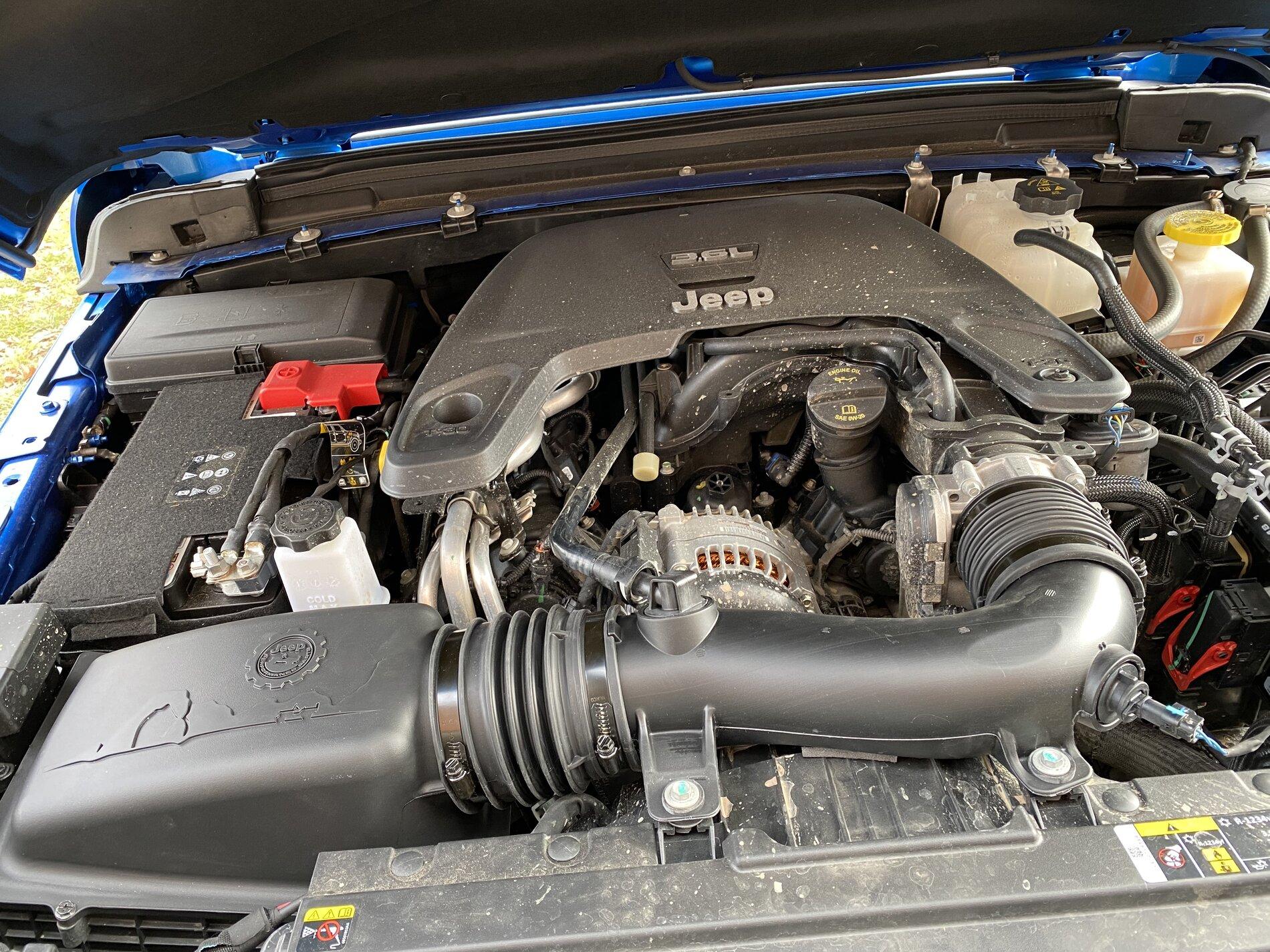

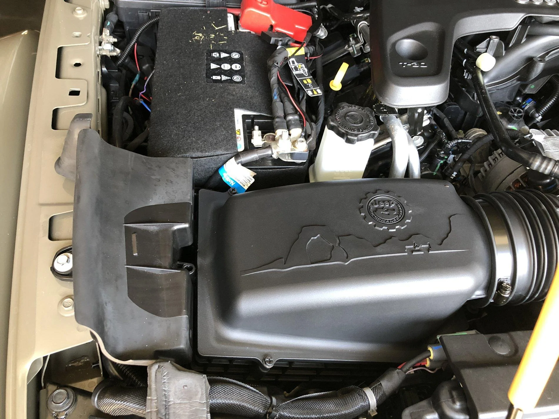

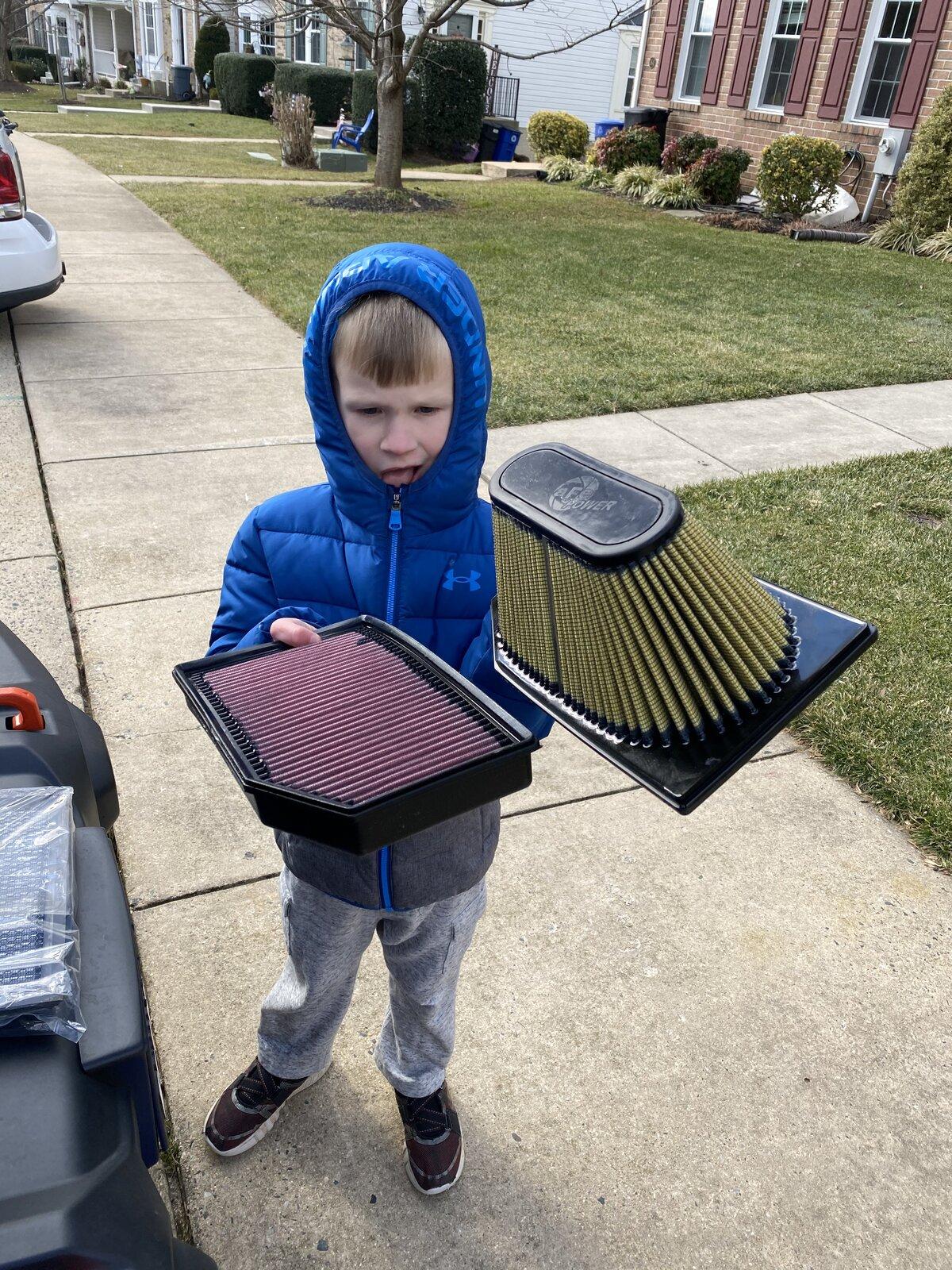

Got mine installed last week. Happy with it, and it does as expected
Jeep Gladiator Anyone Install Mopar Cold Air Intake Yet? A09E92F9-D685-48C0-BA63-F43FB08FCABE
Jeep Gladiator Anyone Install Mopar Cold Air Intake Yet? 04416138-2853-4EF6-B71E-1E1277545892
Jeep Gladiator Anyone Install Mopar Cold Air Intake Yet? 01AF2261-FDEE-444A-9BEE-EE21B9AEA582
Jeep Gladiator Anyone Install Mopar Cold Air Intake Yet? 05836A31-9579-4586-A192-ED757411E0A1
