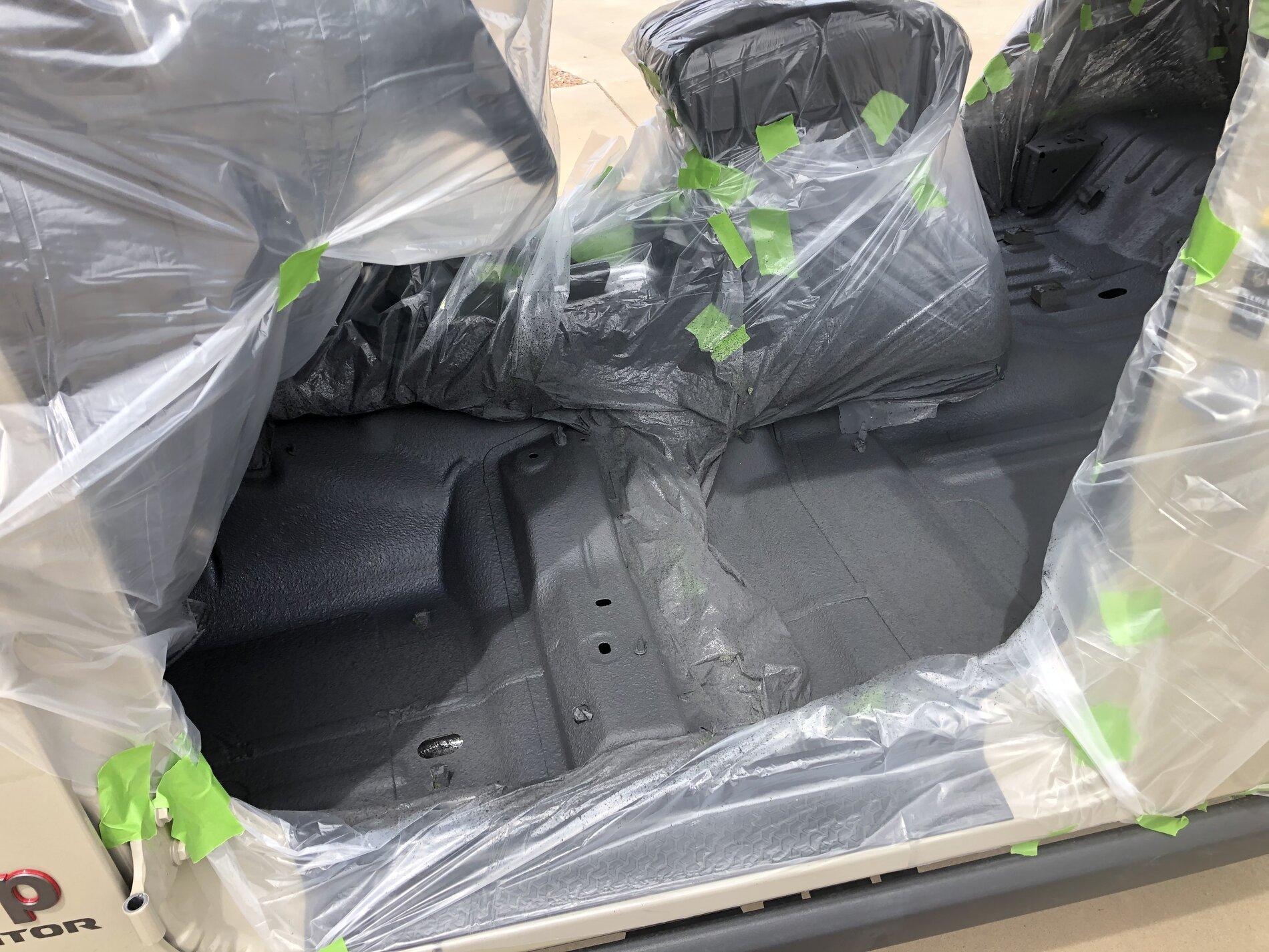

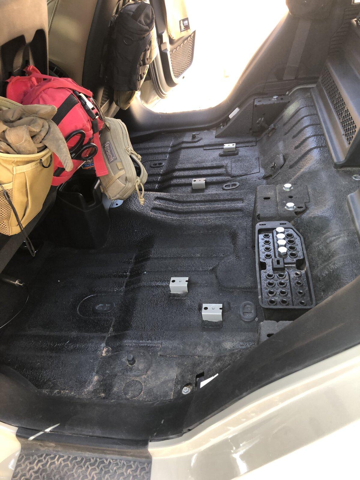

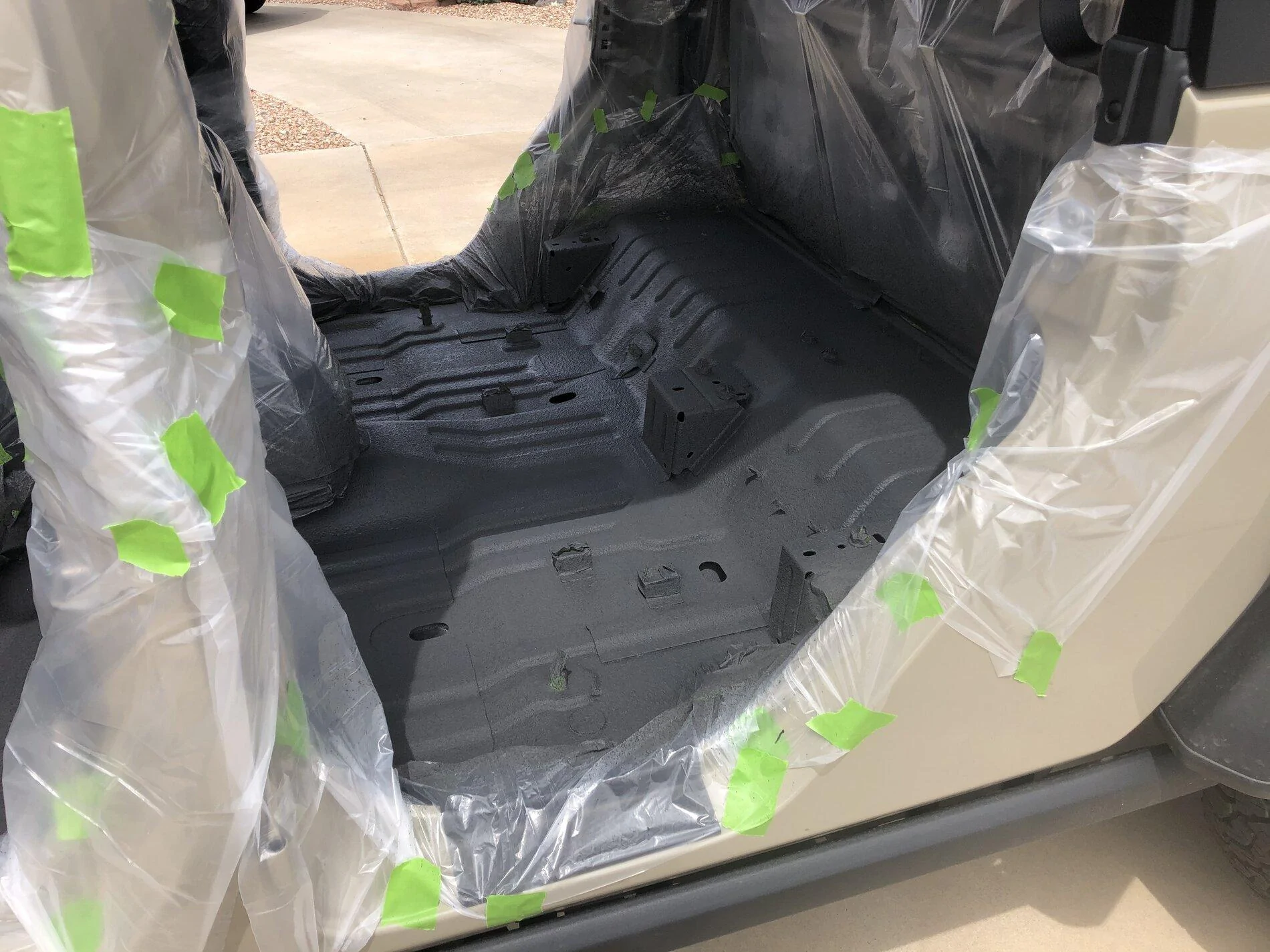

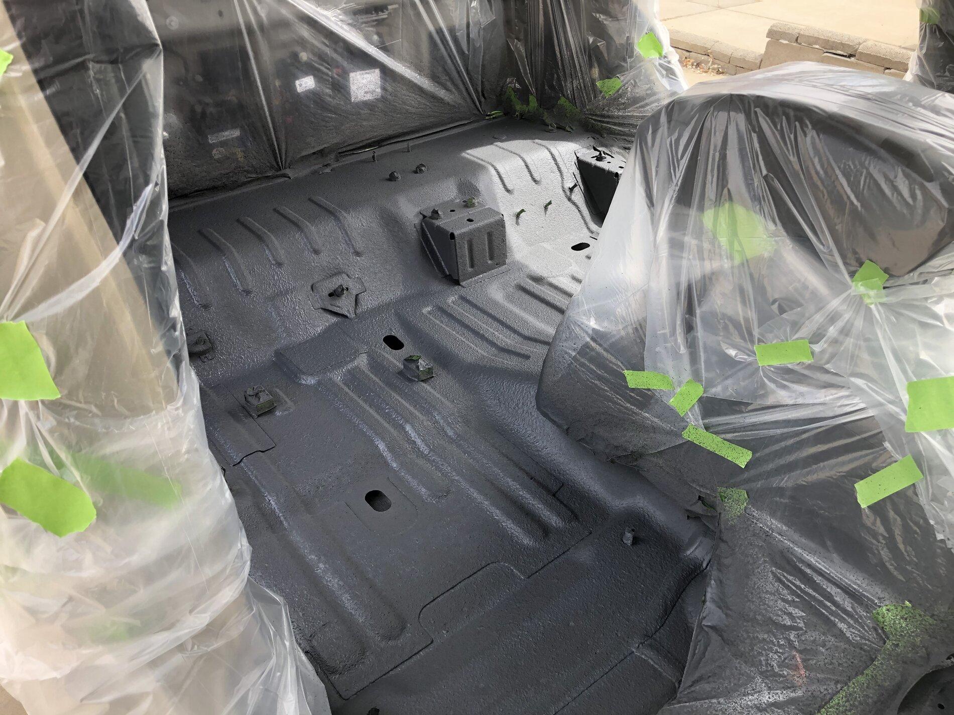

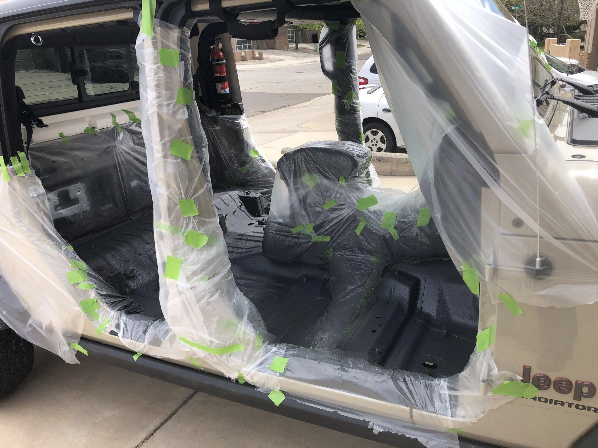

Here ya go.

How much did that run you? Looks great.. any noticeable difference in noise or heat?
How is lizard skin different from bedliner (or is it just a type of bedliner..)? I had a TJ a while back that I Herculined the floor, I never regretted not having carpet but I didn't like the Herculiner product much, very gritty and rough. This looks much better

Scott, I bought the kit directly from Lizard Skin. I got a two gallon bucket of the thermal barrier and a two gallon bucket of the sound barrier. The kit comes with a spray gun and stirring rod. I also got six cans of the top coat spray, all for about $500. Lizard skin is made to spray on the interior or exterior. After it sets there’s no lingering odor when it gets hot. It’s a four day job with all the prep work, but well worth it. It ends up about as thick as two credit cards and is very durable. I covered my entire floor, and a rear seat delete, and still have a a little left over. I also have the Hothead liners, so the ride is quiet and temp is comfortable. I have Weathertech floor mats in the front to reduce wear.
