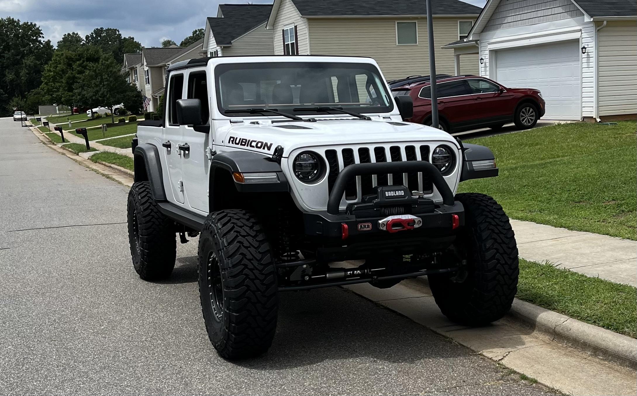

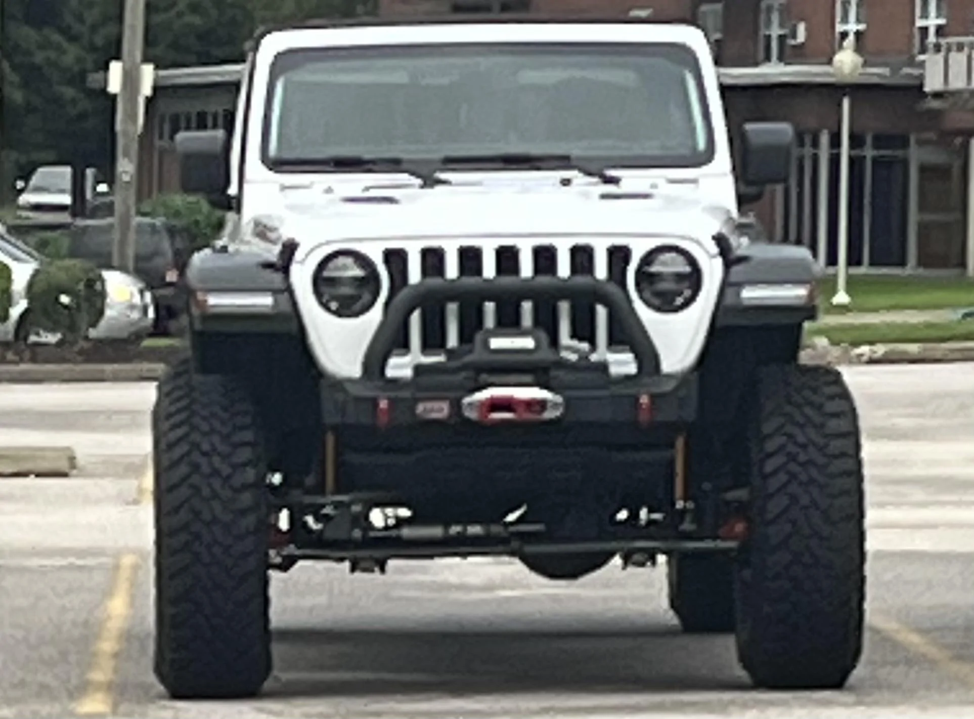

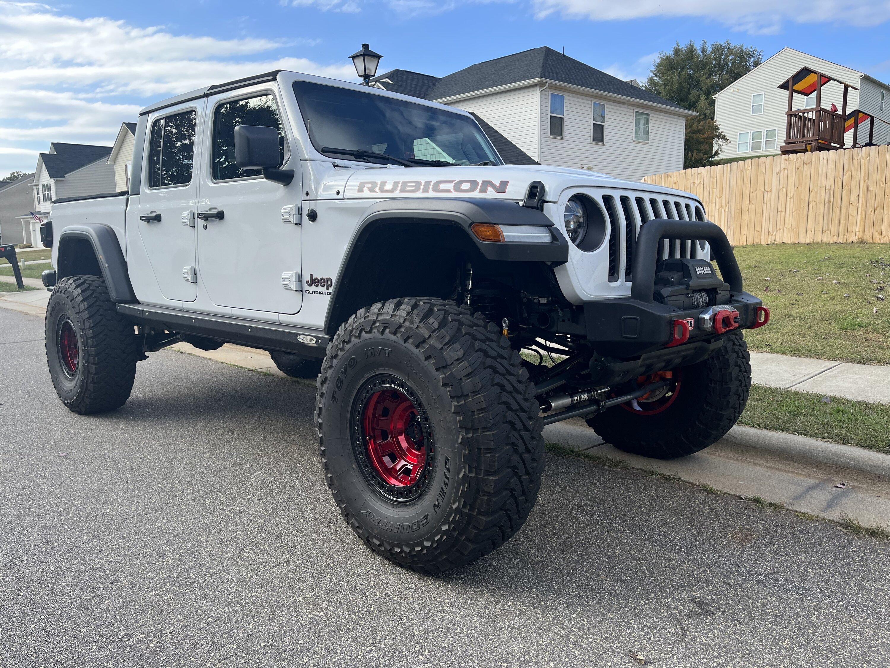

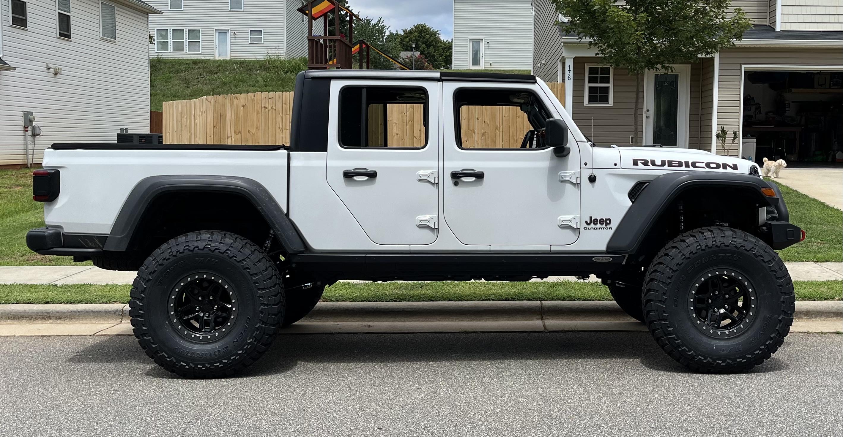

…( And get educated about the real strength of these HD D44s if you’re concerned. The bearings, housing materials and metallurgy, and light weights with high clearance makes these great platforms for improvement. Driving habits keep them alive. 25+ years I’ve been driving with huge, heavy tires on Chevy 10 bolts, AMC or D35 rears with D30 fronts, or the previous D44s on the early TJ and JK Rubis.
Make the suspension articulate freely without bind, simple weld additions in some key places, eliminate or build-up known weak points, and drive without a heavy foot or needy ego.
