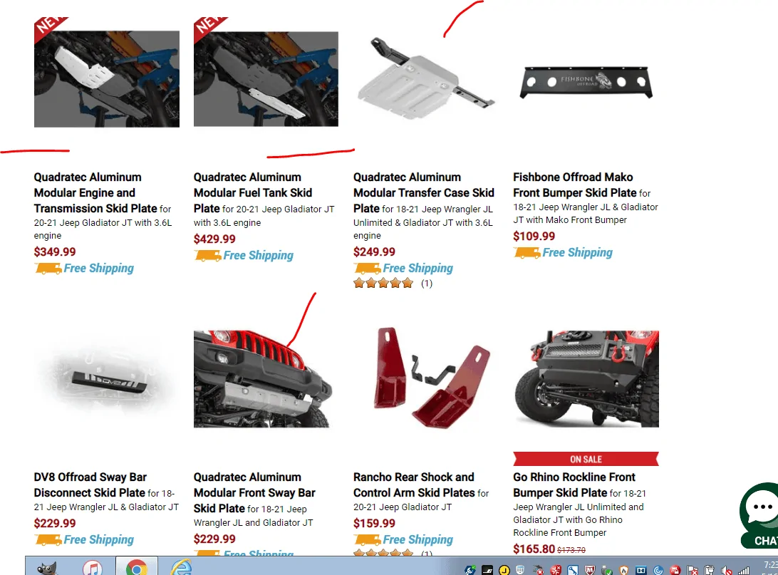

I wonder why the Quadratrac parts are so much more expensive than the Asfir? Even with int'l shipping vs "free" shipping the Quadratrac combo engine/trans/skidplate is 50% more than the Asfir. Guess I'll find out today if the Asfir are a pain to install.
The fuel tank skid plate is actually the same price (~$430 shipped at time of this post) from either company.
The ASFIR4x4 transfer case skid plate is nearly $100 cheaper currently, but it doesn't replace your existing plate. It actually bolts over it.
The engine skid is indeed an extremely good deal compared to competitors. Currently, it's about $80 cheaper, shipped.
My guess on why ASFIR is cheaper is that it's likely sourcing. Steel and aluminum (aluminum less so) are heavily tariffed imports to the U.S. It could be that ASFIR4x4 who works on a lot of other vehicles can source aluminum in bulk cheaper than Quadratec's manufacturer (because I doubt Q builds these in-house), who may also concentrate more on Jeep vehicles perhaps.
Or it could be that Quadratec mentions they powdercoat the skids in silver. Total guesses, though.
Edit: Both ASFIR4X4 and Quadratec use 5052 grade alumnium. While more expensive kits like Artec's uses 6061 which is harder. Here’s a basic Google search result comparison with examples of applications:https://www.industrialmetalsupply.com/blog/6061-vs-5052-aluminum
