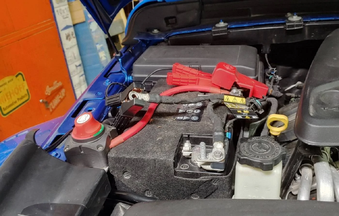

Disconnect both batteries and measure the voltage level of each one. Anything reading below 12.2 is suspect. Separately charge each battery and see what happens. Fully charged should give a reading of 12.8 volts.
It's very likely the Main battery is the problem. The two batteries are paralleled together all the time. To determine which one is the problem, the grounds have to be disconnected and each battery checked separately.
So just today I had to go to the post office and it wouldn't start. The voltage read ~10.5.
The good news is that new jump starter is actually a beast. I hooked it up, truck started no problem.
Can I check both batteries without having to get down to the aux battery since it's below the fuse box. I don't wanna take that apart.
If so which cable on the positive goes to the aux battery?
Coz there's the thing where I saw a bunch of posts about the black cable that's supposed to be the aux ground, and then coz mine's a 22 it was the other one. I'm assuming I remove the positive and the negative cables from the main battery (the ones going to the aux) and then I test the main battery, and then test the aux battery by touching multimeter poles to the positive and negative cables.

The easiest way is to remove the negative cables from the main battery. Check the main battery using the positive and negative posts. Check the aux battery using the positive post and the disconnected negative cables.
But to charge the aux battery wouldn't I have to remove the positive cable from the main battery?
40,514
54,044
No. That's because the positive of the crank battery is connected to the aux battery through the PCR.
By connecting to the ground cable that goes directly down to the aux battery, you have electrically isolated it and can charge it without disconnecting anything else.
This is how I checked and charged my 2020's aux battery - however, you have a 2022 so you need to take the OTHER ground cable off the IBS and clamp your charger to it as in 2021 they changed which of these two cables goes to the aux battery ground terminal.
Jeep Gladiator Aux Battery Died, Weird Results When Doing Fuse 42 / Aux Battery Disconnection 2020-JT-charging
For a 2022 and later, you need to remove both negative cables and take them apart and clamp to the larger of the two cable ends. So you have to remove both nuts, take the two apart from each other and use the cable with the larger end - which goes to the aux negative.
Jeep Gladiator Aux Battery Died, Weird Results When Doing Fuse 42 / Aux Battery Disconnection JT-neg-bat-post-cables-ibs
No, it's not necessary. The positive cables are tied together. The charging current only flows through the battery that has the negative cable connected to the charger.
One thing I'm still confused about. How will I know which battery is the problem?
If the aux battery is draining the main battery, the main battery will be low but the aux battery will be charged?
But how do I know if it's the main battery? The main battery would drain the aux?
Once I charge them both how do I know what the problem is? The same thing is going to happen again because it's already happened 3 times.
I can't see the voltage of each without disconnecting them from each other and testing separately.
How will I know which one I need to replace?

Disconnect them from each other. Charge each one, let it sit for a while, then check the voltage. Fully charged should read 12.8 volts.
My charger shows when charging is complete. If the battery is bad, it will show a failure message if it is unable to charge it.
Looks like it's definitely the main battery. I didn't even have to leave it for a while.
My charger shows blue when it's not charging, and green when it's charging and has a function to force charging. It also has a red error light that can come on.
I checked both batteries separately with a multimeter. Aux battery is was at 12.x volts.. and successfully would charge.
The main battery was at 0-1 volts and would not go up beyond that.. I hooked up the charger to charge it but the light stayed blue as if it wasn't connected to anything.
I went to force charge it and the light turned green and charged for maybe 5-10 seconds and light went back to blue as if it's not connected to anything.
So seems like main battery is definitely dead. I'll have to replace it. Can I trust auto parts stores to know how to change the Gladiator battery with the dual system?
Seems like that is the easiest way since install is usually free and so it's no muss no fuss.

There's really no special process for changing the main battery. As always, the person doing it should ensure the positive clamp doesn't touch anything during the process (I usually wrap it in something like a rag and tie it out of the way), but that's really it. The big thing to remember is to reset the IBS after it's changed out.
As for maintaining the battery during periods of inactivity, I would recommend a battery tender. It will do a better job of keeping the batteries in good shape than random short drives.
