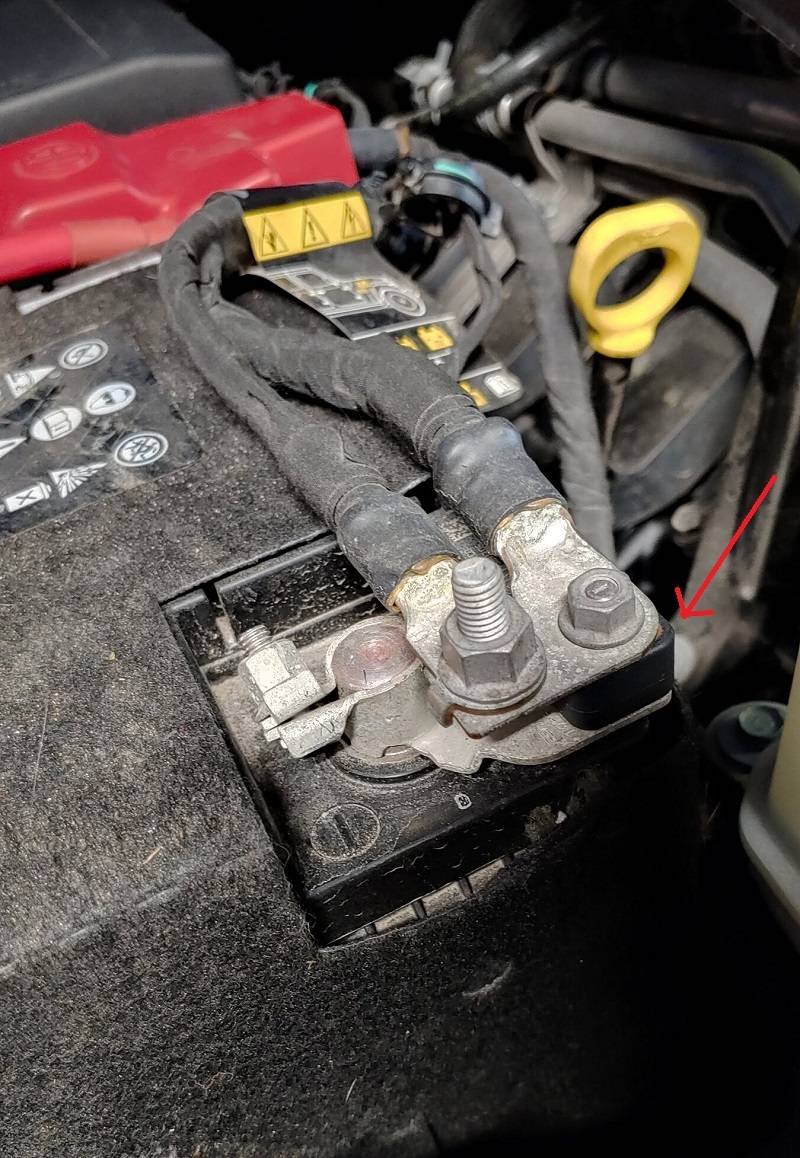

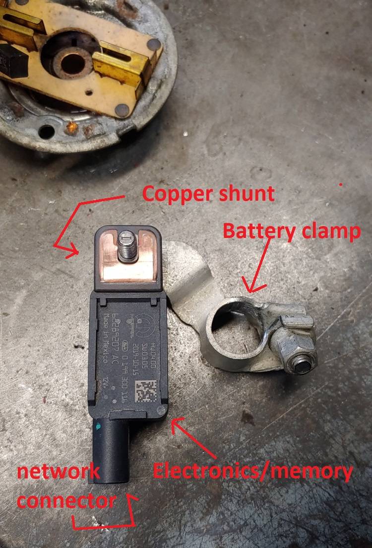

It sounds like your crank/main battery is toast. It's not always the aux - that's internet lore, as you have found out. The main can short and kill the aux battery. Shorted batteries aren't as common with these AGM batteries, but it can happen.
The IBS is Intelligent Battery Sensor - see the red arrow in pic below.
When charging both batteries with everything still connected - ALWAYS charge by connecting to the studs on top of the IBS, never to the battery post itself.
If you remove the cables and charge each battery independently, then of course connect to the posts as the IBS won't be there.
When replacing batteries, always charging them fully first and fully disconnect the IBS to reset it so that it learns the new battery/batteries.
I also include disconnecting the small 2 wire connector on the back side of the IBS (network connector in the bottom picture - also powers the IBS)

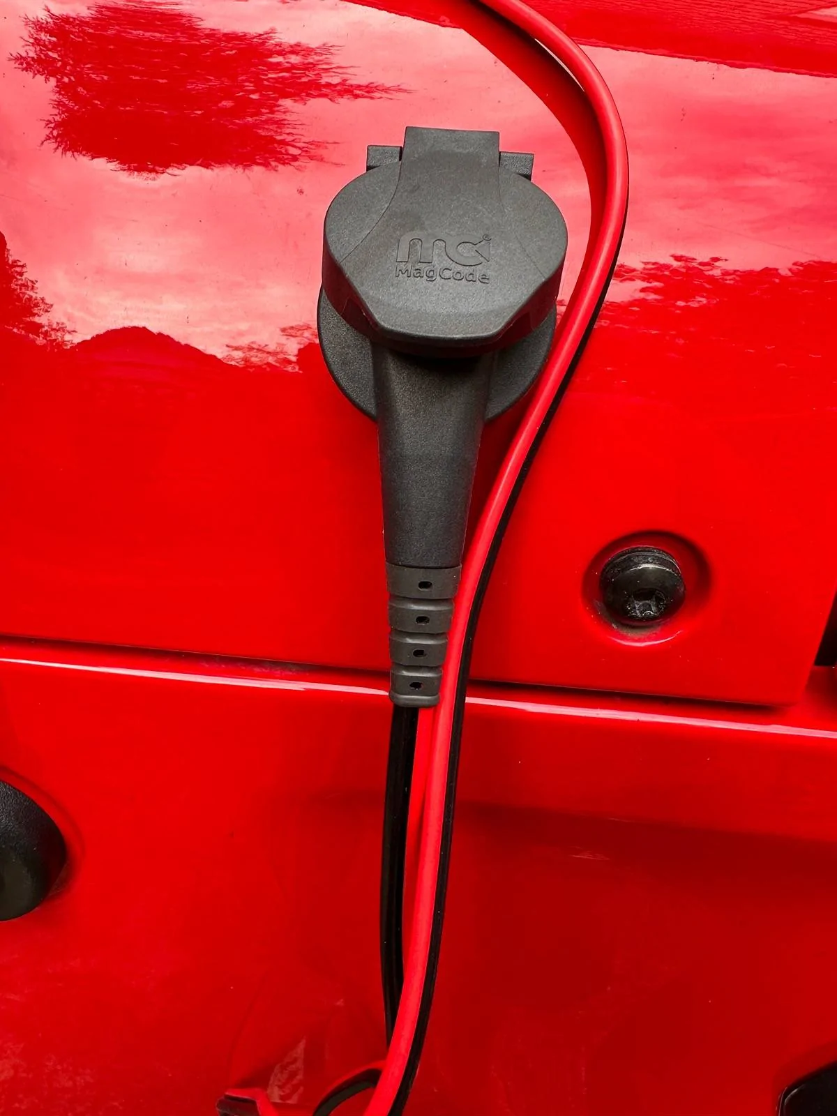

The ecodiesel runs a DEF tank heater among other things that slowly drains the battery. But, I wouldn’t drive the truck, especially short distances just to charge shitty OEM batteries. That’s sacrificing the emissions control systems for battery charging
Mine lives outside (old house with a workshop but no garage)
I connect a NOCO 10 to the truck via a magcode magnetic port (pops off if you forget to disconnect it). Other people can’t use it. It’s connected via a 25 foot SAE cable.
You can also use a solar panel to keep the battery topped off.
Adapter:
NOCO GC009 X-Connect SAE Adapter... https://www.amazon.com/dp/B005DUMADC?ref=ppx_pop_mob_ap_share
Cable:
https://a.co/d/ankXzLV
https://www.rosenberger.com/product/magcode/
