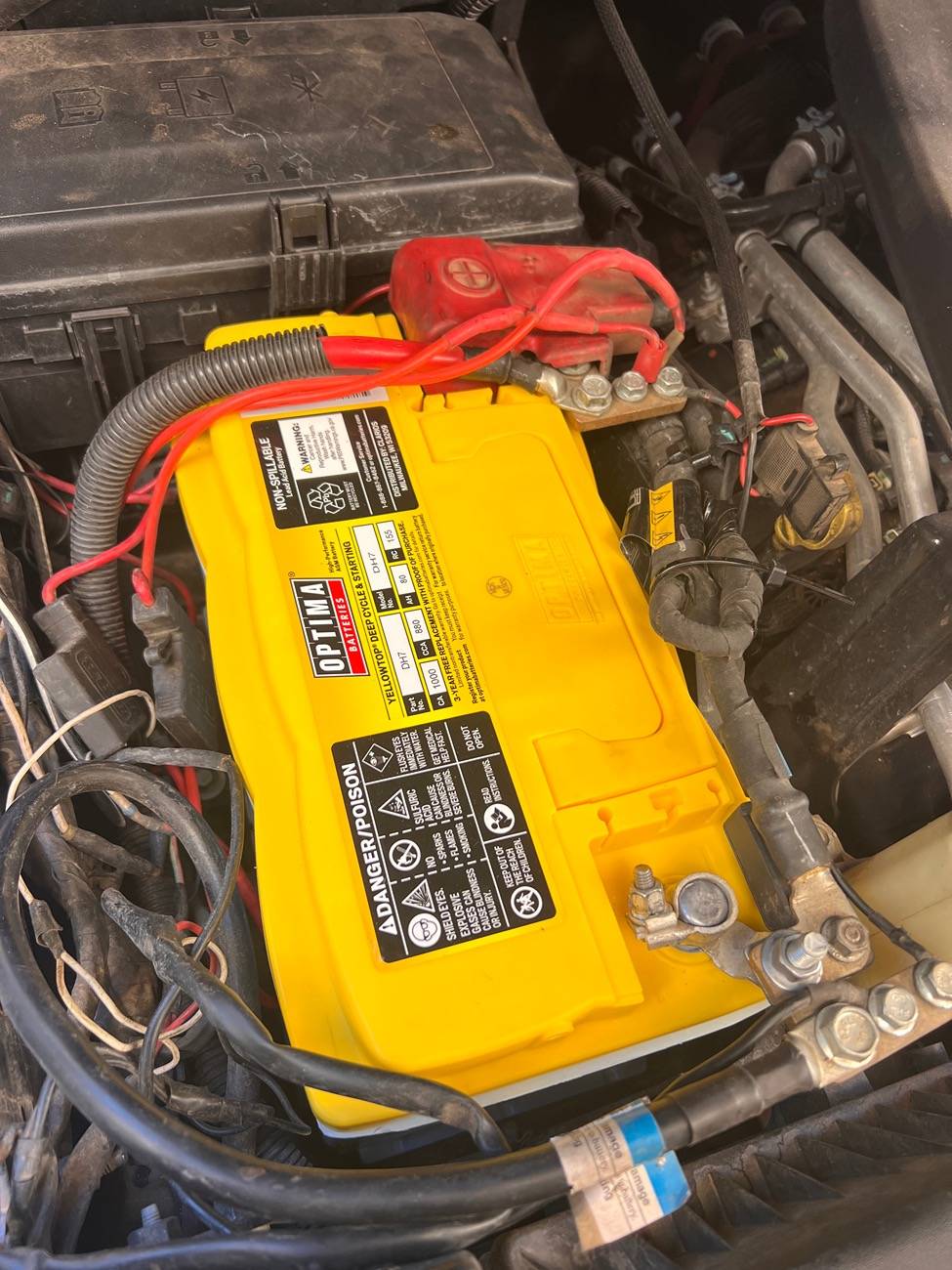

I know this has been discussed ad nauseum but what a piece o'shit technology this has been. By far this has been the most unreliable piece of tech on my 2020. I've driven 80K miles and have had both batteries replaced 3 times so far. I suspect the AZ heat is the killer.
Started having issues again... I finally gave up and disconnected the negative aux line and pulled the F42 fuse. I should have done this sooner. I've been running a Tazer since day one so never ever used this function. Thanks for hearing me vent but should have done this much, much sooner.
