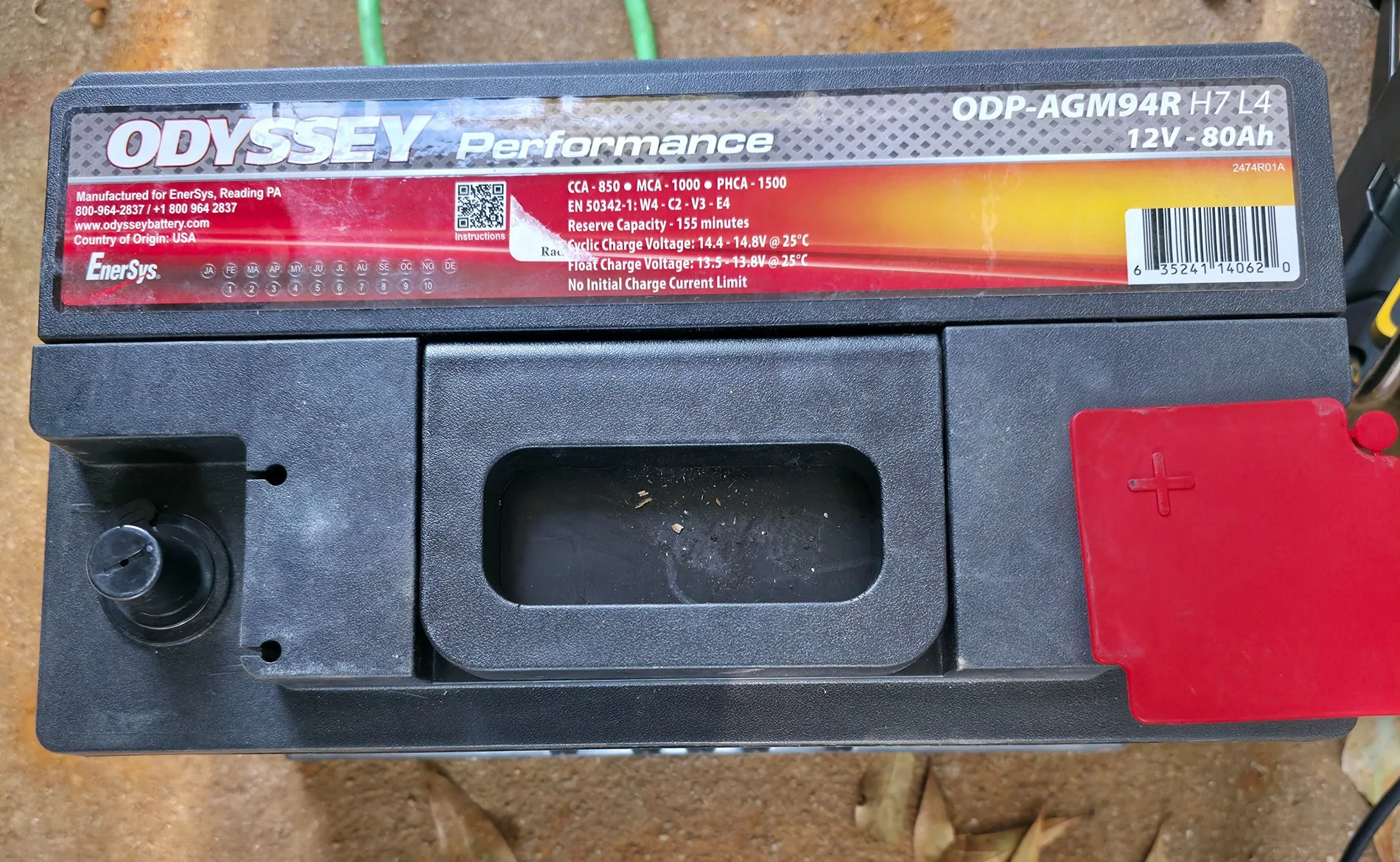

Well, I got my odyssey performance agm 94R battery today from NAPA in Douglasville, Ga. Only 2 stores in a 60 mile radius in the Atlanta area had one in stock and I was told that the NAPA warehouse didn't have any in stock. Douglasville is over an hour's drive from my house. Since I have Triple-A membership I got $33 off the price when I bought it online from NAPA. Before the core refund and with tax and minus the triple-A discount the total was about $350. I didn't spend that much lightly as that is painful.
What's odd, and a bit of a disappointment, is that it doesn't have the red cover on top?? Has anyone else experienced that?
For $350 I totally expected it to be fancy! The photos show it having the red top and the part number seems to be the same.
I just replaced mine, and it has a black top as well. I've used Odysseys for years in my Tacomas and now JTR.
Good to know that it's just not me! I was worried that maybe I didn't get the standard battery despite having the standard part number and paying the standard high price.
