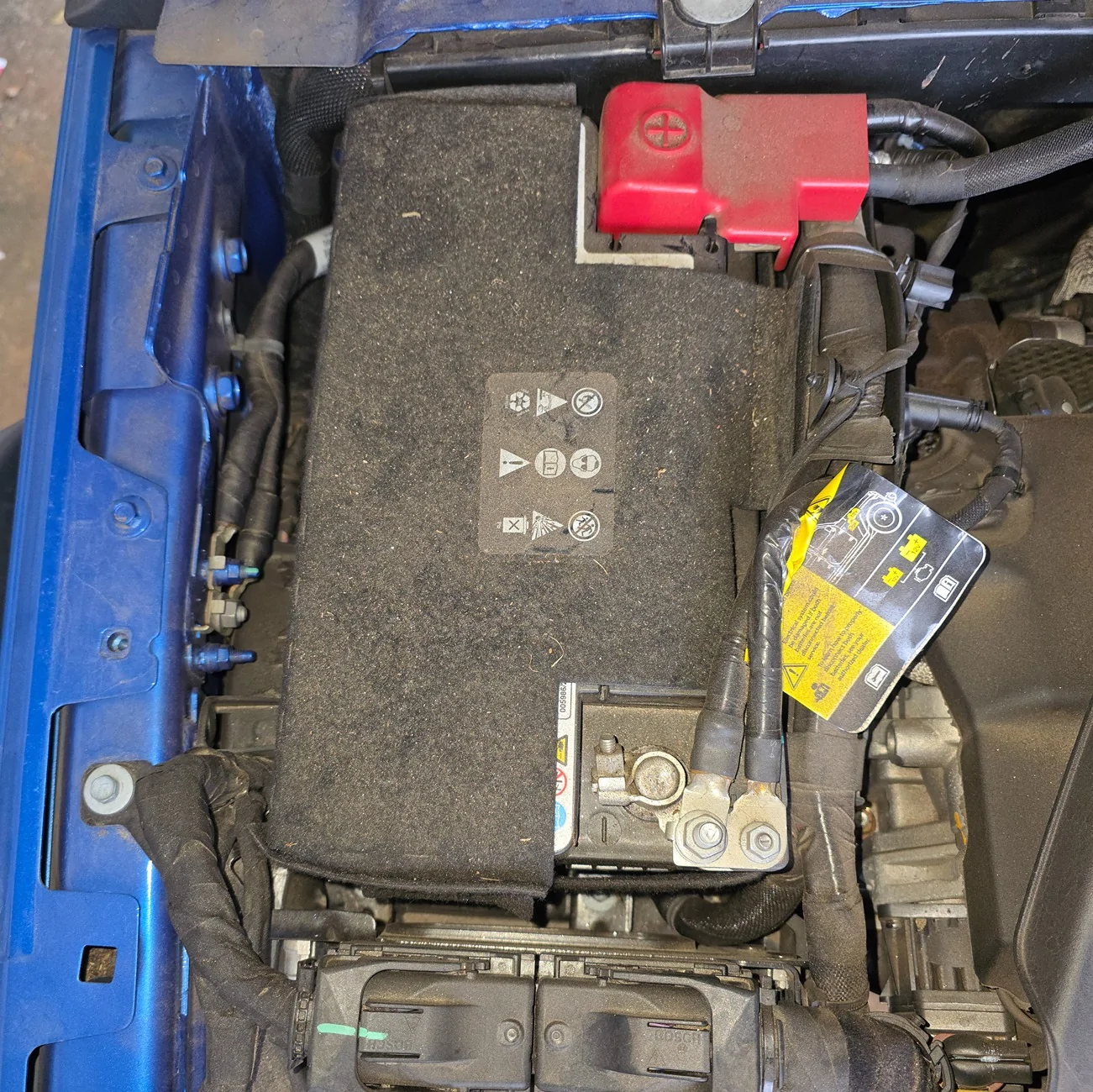

Here's the battery to my 2023 Gladiator - can anyone tell me which two leads to disconnect and insulate in order to remove the aux. start/stop battery? The auxillary battery never worked right from day one when it was new. It was almost always charging and start/stop not working even though I remembered to turn it off most times. Now that it is almost 3 years the remote start wouldn't work which told me the aux battery was almost dead and slowly ruining the large battery. My plan is to pull fuse 42 and disconnect the aux battery leads from the main battery and insulate and isolate them very well. That will save me (hopefully) from having to remove either battery unless the majority of folks here think that's not a good plan.
I noticed the battery clamps look like the "one time use" type and don't look like they would do well if removed and put back on. If I do have to pull the large battery, is it possible and better to unbolt the leads and leave the battery post clamps on so that they maintain a good connection?
I worked on cars as a teenager - which was forty+ years ago and I'm not adept at working on mechanical things so I want to make this as simple as possible to delete the aux. battery.
Thanks for any help, suggestions and advice!

It looks like you have the Ecodiesel. It would be the one with that yellow/black tag on it. It should also have the larger "tab" that connects to the battery. I just taped mine up real good and zip tied it back away from the battery. Pulled the 42 fuse and left everything intact. Been like that for almost a year, and everything works just fine. (I do have a start/stop device to prevent the engine from stopping at lights) Someday, when I need to replace the main battery, I'll probably pull the aux, just to remove some weight. FWIW...

Thanks Bananaman, to be clear: you removed two leads or just the one with the yellow/black tag on it?
And yep, it's an Ecodiesel. 70,000+ miles on it and, knock on wood, no problems. Jeep gets a bad rap on the Gladiators and in my experience the Ecodiesel is great. 24mpg mixed spirited city/hwy and tons of power.

Yes, just that one ground. It was the easiest way to disconnect the aux. I've seen video's where all the wiring was removed, but I wanted to keep it simple in case I needed to go back to stock, or something didn't work.

this was quick and easy. I left the battery disconnected for over 20 minutes which supposedly is long enough to reset the IBS. No error messages or warnings. This seems to be the way to go. When I zip tied the lead I also zip tied the nut to it so if I ever want to connect it back to visit the dealer I have the nut handy.

You need to unplug the small wire connector unless you totally disconnect both batteries.
Depends on the year - they change it a while back. (unless the change was ONLY for gas, that is)
For gassers - some years, it's the larger tab, for others it's the small one.

Shadowspapa, do you mean the "small wires" that come from the IBS? I didn't remove the entire connector that has the IBS attached, and ONLY disconnected the negative main power lead and the negative lead from the aux. battery. With that situation, did the IBS reset?
