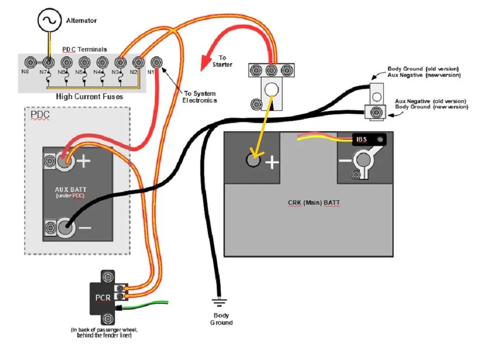

You can check the voltage of each battery separately by taking the black cables off the top of the IBS - one leads to the body ground on the right fender area, the other goes to the aux battery negative post.
Check voltage between post N1 on the PDC and the negative cable leading to the aux battery after you remove it from the IBS on the crank battery.
Also check for a blown N3 fuse. If that's blown, the aux battery won't/can't charge from the alternator.
Does it matter if you disconnect the negative? Isn’t N1 direct to the aux battery so any reading from it would be just the aux battery?
